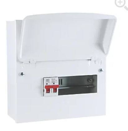

I've got an armoured cable that I am taking to a new garden room. I am going to guess that it is either 6 or 10mm. This should be ample for a few lights and sockets in the garden room.
To keep things tidy, I want to install a small consumer unit in the garden room. This will be mounted on the plasterboard. Am I okay to bring the armoured cable through the 4x2 timber structure and terminate into a box inside here (behind the plaster) I can then have a regular T&E cable going up and behind into the consumer unit.
I wanted to check if there was any need for the armoured cable termination to be accessible, etc.

Thanks for the responses. I will probably have a CU like this:
It will be mounted on the finished platerboard wall. If I gland the SWA on to this, the gland and armoured cable would need to be visible?
I was suggesting that I gland it in a box which is 1 metre below the CU and inside the timber wall structure. I then take a T&E from here and into the CU, back entry.
I think a couple of you are suggesting that this gland box could be behind the CU (inside the timber wall) and I can the bring the cables straight into the back of the CU. Have I got that right and I assume it's okay to bury the glanding of this cable?

Terminate into a wiska box on the outside, then connect up with appropriate size T+E. Earth up correctly. If you've not done it before practice on a cut off.
Why do you want this CU? What will the SWA be connected to at the other end? Would it not be sufficient to use an FCU for the lights and to connect the sockets directly?
Anyway: if this is going to be your first attempt at terminating SWA, do you want that inaccessible inside a wall? I wouldn’t; I’d have the SWA come through the wall below the CU and then into a glad on the bottom of the CU.

I want a CU, because I can then have a separate circuit for internal, external lights, indoor ring and outdoor socket.
but that would have the gland and SWA cable visible on the finsihed wall?

What’s on the supply end of the SWA?
And yes all connections needs to be accessible
...and I suppose if it was glanded into a box behind the CU, it would be accessible by removing the CU. Does that count?

Others have suggested that it can be concealed. I am confused now.
Its not going to be great with the RCD upfront
You'll have a board in the shed but the potential of having to return to house to restore power
