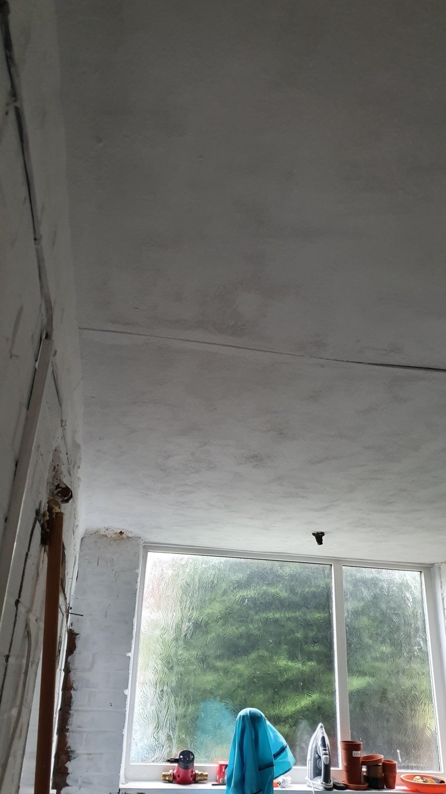

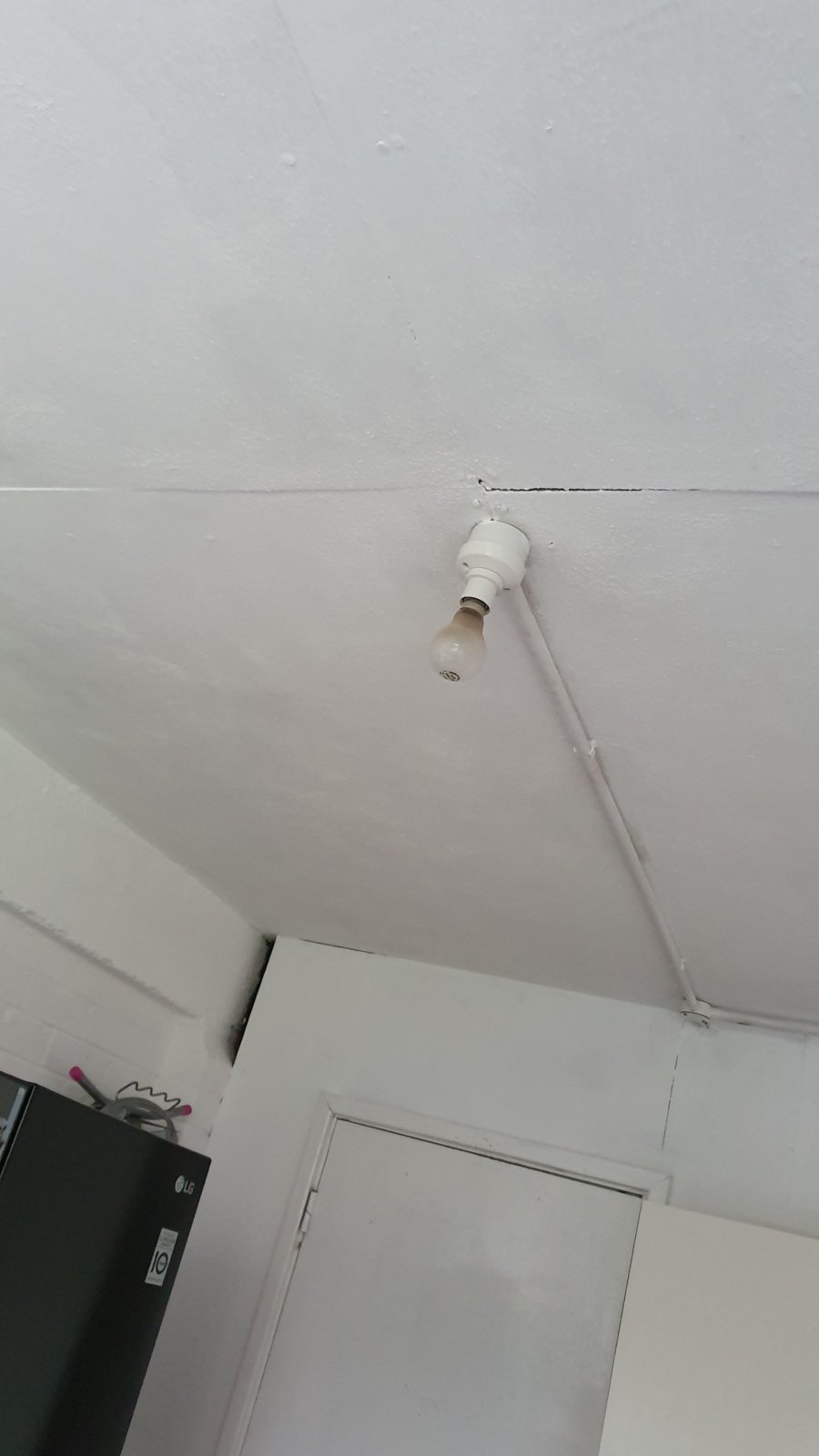

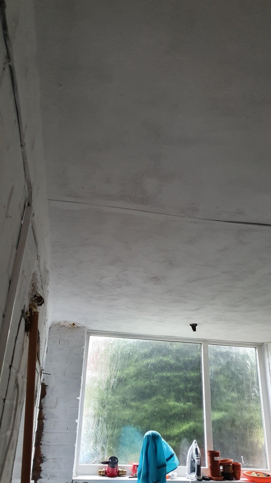

Next week I have another company coming out to give us an estimate and I will update this thread with costs and pictures. Any advice from those who have done this is appreciated, just hope this helps someone else out. Couple of pics below to give an idea

It is in ok condition, one part is starting to sag a few other areas have crumbling parts, there is a small hole where old cables have been cut, it is a small area but the fibres are exposed. As it will be used as the top part of a cavity I want to make sure anything knocking it will not disturb the boards so encapsulating it is the way forward.
First picture below shows the window and the area which has started to sag. This part of the ceiling was painted by the previous owners, the company today reckons they knew what they were dealing with. Legally you do not have to declare asbestos unless specifically asked about it.

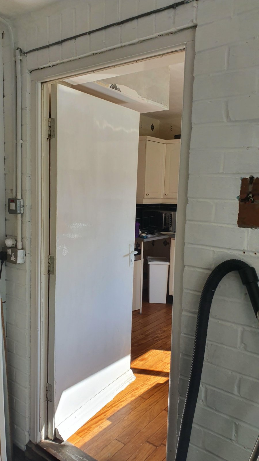

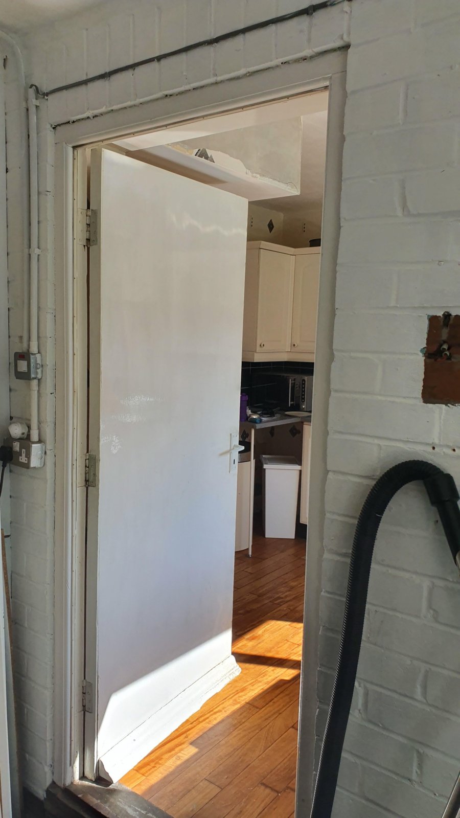

Second picture shows the wall through to the kitchen which we are planning on knocking through to extend this area.
