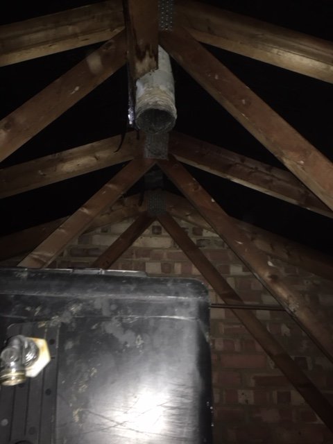

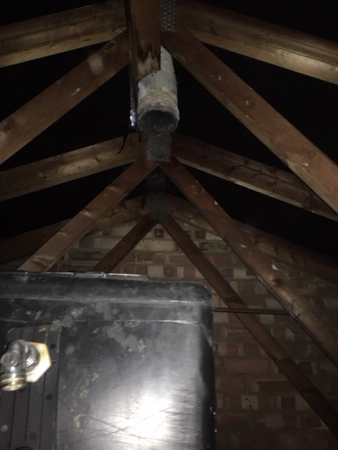

I have a ridge terminal pipe i think may be asbestos, the house was built in 1970 and previously had a warm air system which im guessing extracted through this pipe in the loft.
I would like to fit an extractor in the bathroom below and connect to this pipe with flexi duct and a jubilee clip.
My question is, does anyone know if this pipe is likely to be asbestos? if it is would it be dangerous to connect up to it or am i best to have it removed/leave it alone?
Thanks!

99% sure it is asbestos cement, I would leave alone myself.
Thanks for the advice, i will find another route for the extractor
You will have no problem quickly connecting to it if you try not to mess about too much and end up disturbing the cement.
Wrap the external face in duct tape, slide the duct on and clip it.
In context, its a very low content of the larger fibre type, and the fibre is bound with the cement - so its a low risk.
I doubt an extractor duct will fit 4" AC without a bit of messing about, I would leave it as good loft ventilation myself and discharge the extractor lower where the vent can be more easily accessed if it becomes blocked with fluff.

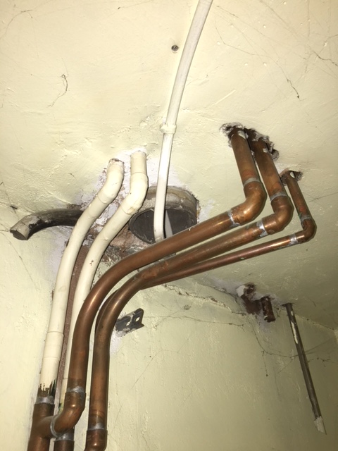

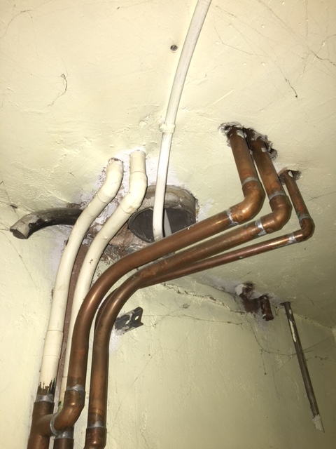

I do not have any experience with warm air systems, im guessing the asbestos pipe ran all the way to the main unit on the ground floor? as there is another piece of pipe in a downstairs cupboard which has been left and a cable run through (see photo) this i assume would be asbestos also?

Yes that is asbestos too, no need to worry too much about it maybe just box it in.
Warm air units were very popular in the 60's & 70's usually fitted centrally in the house, often incorporating a small gas circulator for hot water and flued up to the ridge in asbestos cement or steel flue.
Other places to be aware of potential asbestos in properties of that era are linings of the compartment and the access door, the soffits under the gutter, thermoplastic (marley) floor tiles (very low risk) and textured ceilings.
No need to panic just avoid disturbing them most boards are usually over painted which seals them just avoid sanding when repainting.

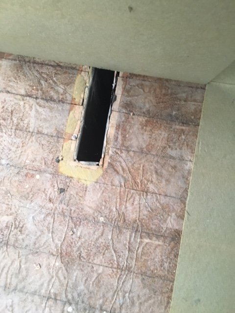

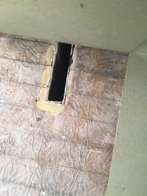

That's great info thanks. i think those pipes are all that is remaining, plus some ducting in the ground floor which has had fireboard and laminate laid over, there seems to be no ducts in the second floor, not been able to check the first floor (floor was already down) i have read these ducts can be in asbestos lagging also..

Most ducts are steel, I have only once come across asbestos ducting in a house in Dulwich many years ago, but you are wise to be careful.(y)
