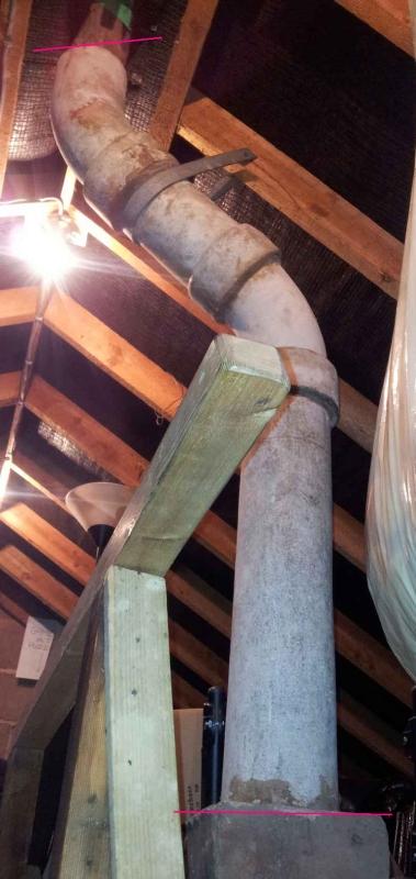

I've just had an old boiler removed from the kitchen and now have an open vent pipe running from the kitchen wall (with a grille on it) up through the house out the roof. The engineer told me not to fill it in due to condensation.
In the loft, the pipe is in the middle and restricts access to the loftspace. What I want to do is remove the section from the floor to where it connects to the part which is fitted in the roof and put a vent in the loft floor so the pipe is still venting. I foresee no problem with this part (please advise me if I'm wrong).

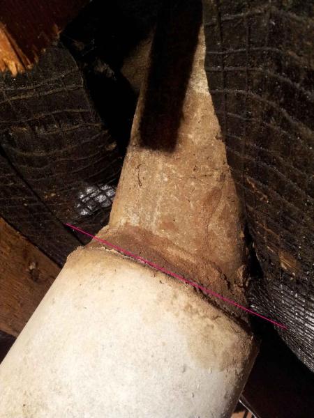

Below shows the bit in the loft which I want to remove. I am concerned the pipe in the middle may be asbestos however...
Can someone please confirm if this looks to be the case?

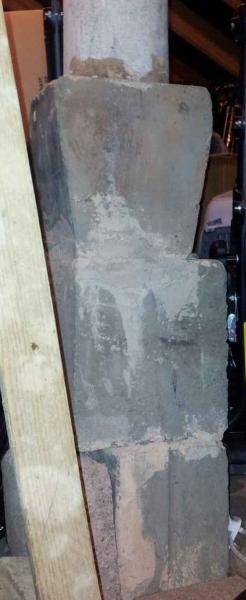

The blocks at the bottom appear to be concrete so what I had planned to do is remove these and take the pipe it to my local waste centre for disposal. Before I do it, is this safe to do please?
Thanks for your help!
It sure looks like asbestos pipe - the cemented asbestolux kind.
I've no idea why it should vent through your roof though - has it been used as a hood extractor at some time?
John :)
It looks like asbestos cement pipe, the joints may well contain asbestos rope (which is a high risk material) packed in and covered with fireclay, it will run to a ridge terminal very common practice 1960-80s

Re-reading your post, putting a vent in the floor of the loft connected via the old duct to the kitchen would seem to be a fire risk, any fire in the kitchen will send heat and smoke straight up to the loft space.
As far as the removal is concerned my view would be that more asbestos will be released into the house by removing it than simply leaving it in place.
Either leave well alone or get a GOOD professional company to do the work and get them to explain exactly how well they will clean the area.
My daughter had an asbestos roof removed, licenced company etc etc.
At the end they swept up with a dry broom, when this was questioned the reply was "well if you want a full enviromental clean up that will be more expensive"!

Thanks for all the replies guys.
Sound advice and I hadn't considered the fire risk from the kitchen.
I think I will leave it as it is and work around it.
Thanks all.
You could have it cut at loft level and redirected to eaves with metal flue pipe.
