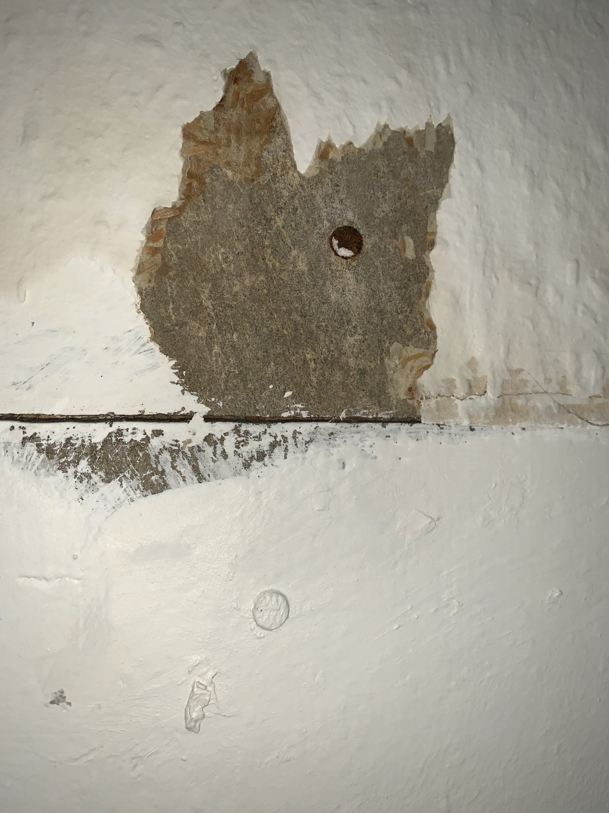

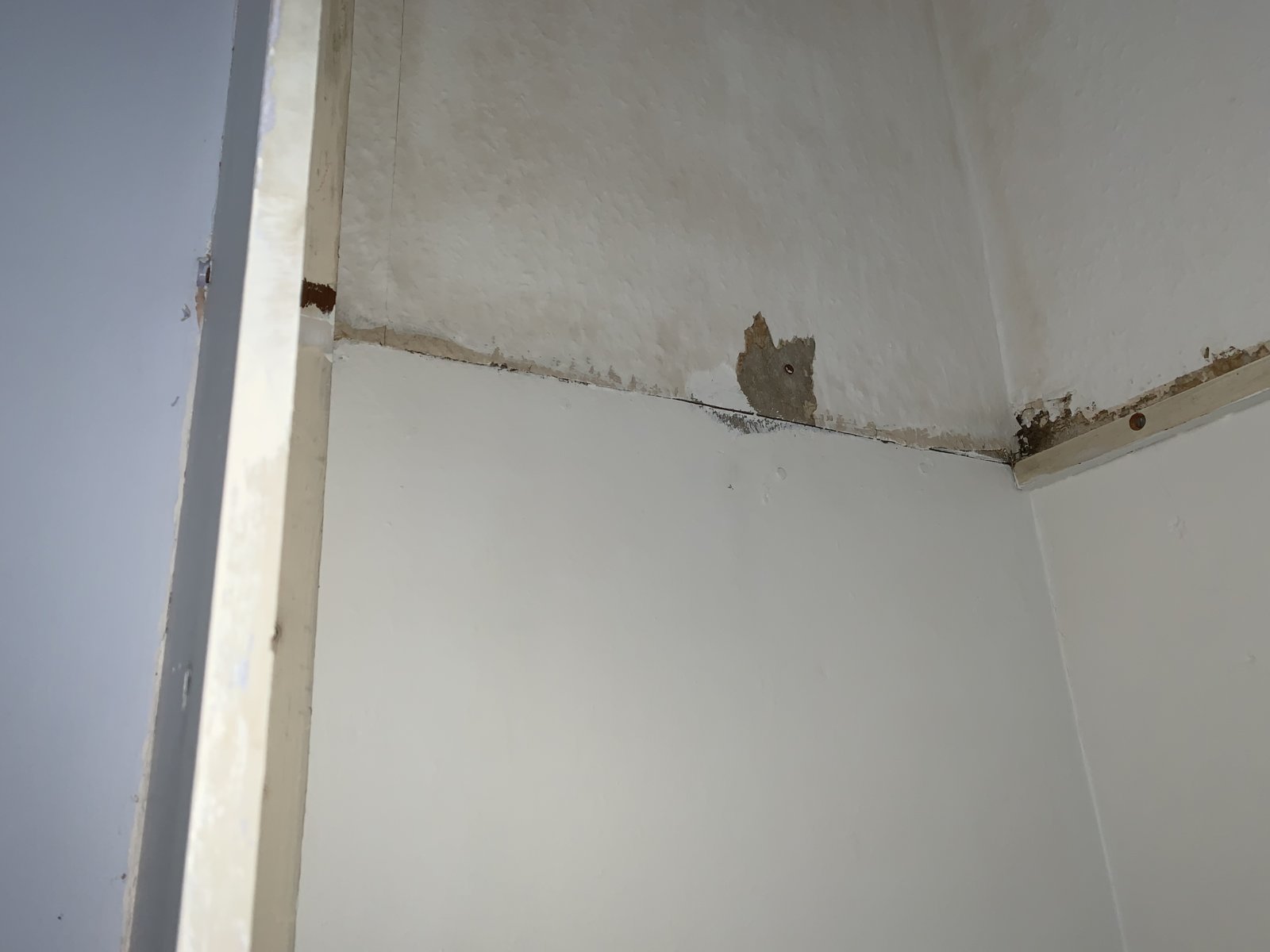

Have removed some fitted wardrobes. Seems there is a section of the exterior wall that is boarded rather than solid as per rest. It’s a Victorian House. Can any tell from pic below if this is asbestos sheet?

Could be, hard to tell from a picture.
Looks quite possible, strange place to find it.
AC at a guess from the shiny finish but impossible to be sure.
Thanks for your replies. I realised only way to know for sure was to have it tested. Got the results back and it did turn out to be Asbestos cement board (chrysotile - white asbestos). Which is at least the lowest risk to handle therefore the cheapest asbestos type to have removed.
I removed asbestos containing artex myself as a home project with relatively low resolution gear, I followed the HSE guidelines to the letter for the exact scenario.
I've not removed asbestos cement board, and I'm not suggesting you do or if you're considering doing it ; in terms of cost you're talking a few hundred quid for specialist removal and in the meantime don't feel squeamish about working around it. You did the sensible thing .by testing it and not taking a hammer to it, many would have.
It would be interesting to see what you pay and perhaps you would be kind enough to document the process here. I'm always fascinated by how contaminated waste is managed from start to finish and I'm sure others are too. My asbestos was the same as yours - chrysotile.
