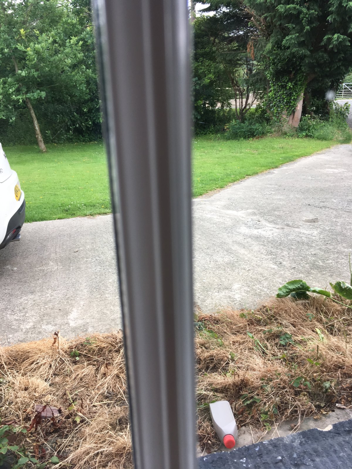

Can anyone shed some light on this?
I’m trying to match some astragal bars on my house!
Or even identify the make of the sash windows!
If anyone could help......
Is there any manufacturer stamps on the windows?
Cheers again
Aaron
Could be a GB2VS feature astragal in white ash foil, yours have been milled properly at the factory but this system also uses a clever cap for the intersections and at the ends where they touch the frame, you don't have these as your are machined, its the better way but it has to be done at point of manufacture, can't be milled on site, the machine is too big
It is white wood grain. Good eyes there!
Any clue as to the manufacturer??
Would there be any identification marks??
Aaron
Having googling it, that looks like a capped system, as you mentioned, the astragals are a milled system.
