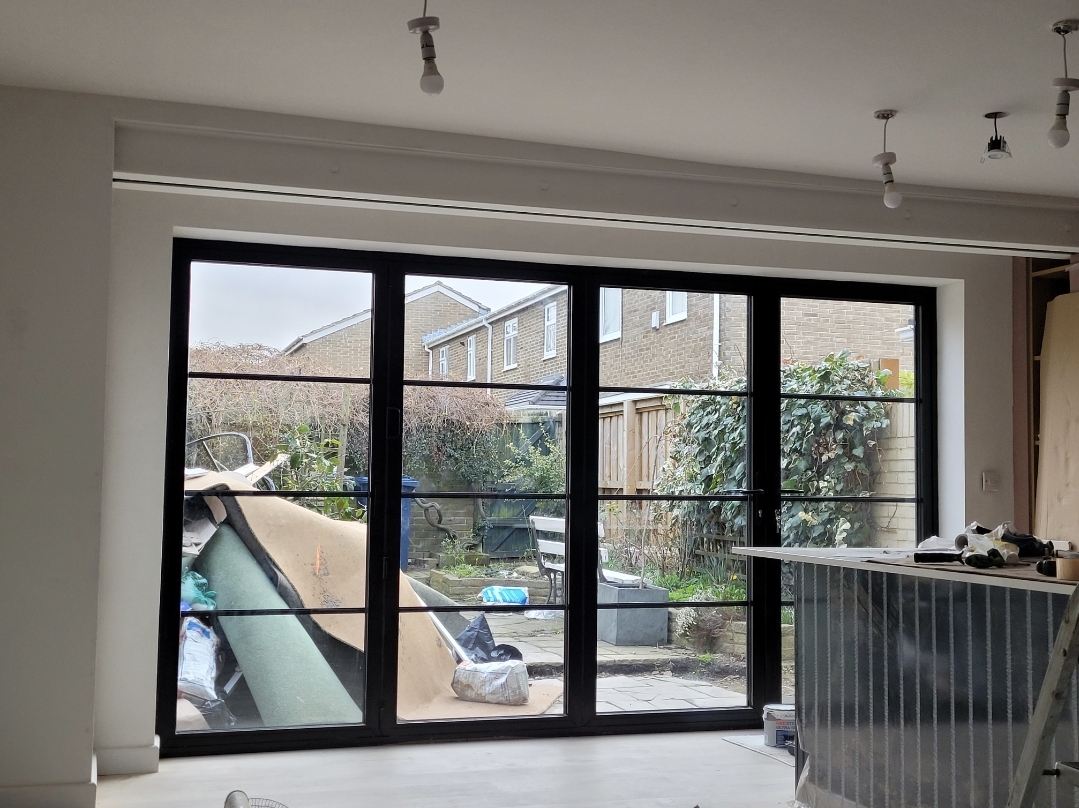

I'm in the same process at the moment, but trying to decide between Crittall style aluminium French doors with transomes and those with the duplex bars and astragals. I think it will come down to price and ease of fitting.

If the cost difference is minimal you could order them un fitted, then do a compare before/after with temporary adhesive and see if you like them
Problem with ordering un fitted is astragal bars don't look right without the ' Duplex ' unit that divides the bigger unit to look like smaller units. And you can't have a Duplex unit without astragal bars.

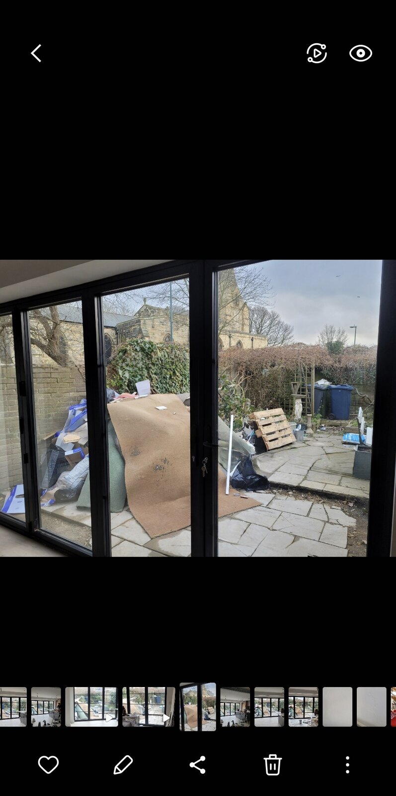

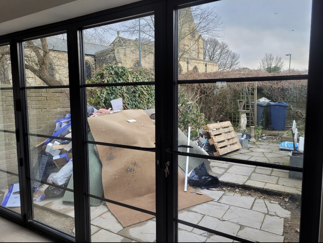

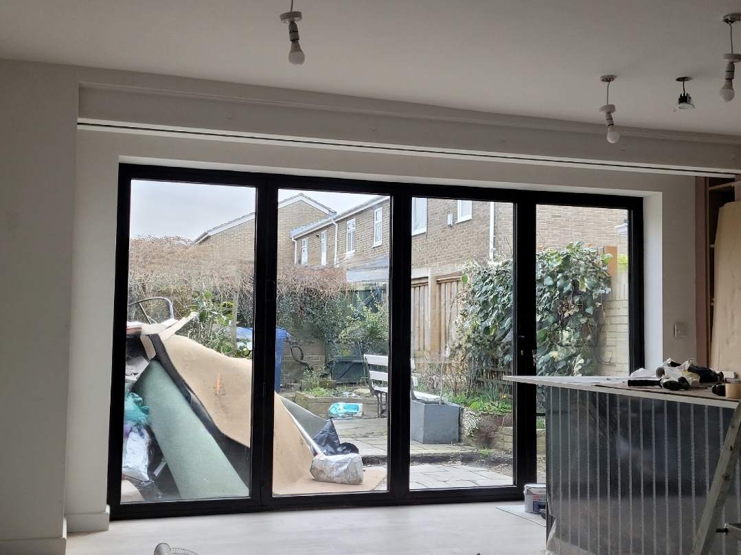

My doors currently have georgian bars inside the glass but the glazier used woodgrain effect with white clips and I wasn't happy. Now the units are being replaced I'm thinking either plain glass or astragal bars. I guess the main thing putting me off the bars is the chance if them falling off. Those doors do get a lot of sun in summer so will get hot.
