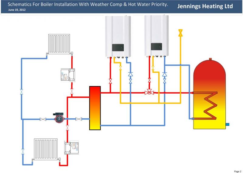

Dan, when you mentioned a low loss header I thought a bit more about a zoned CH system using the Intergas. Have a pipe looping from the flow to the return on the boiler, a primary loop. Tee off this primary loop the upstairs and down stairs heating loops and bring back the returns from these loops into the primary loop, near the boiler. On the primary loop have an auto by-pass valve between the two CH zone flow pipe and the two CH zone return pipes. This will open only when all rad vales are closed and the boiler pump is on the over-run. On each heating loop thermo valves on all rads. On each heating loop have a Wilo Smart pump. Directly in front of the pumps have a check valve and a flow switch. A simple time clock for each CH zone.
When the rad valves all close on a heating zone the boiler is switched out. The flow switches act as end switches in a zone valve with the room stat circuit wired through the flow switches. If all rad valves are closed the boiler and its pump are switched out. When one valve opens the Smart pumps start up open the flow switch and brings in the boiler and its pump.
No wall stats are needed, no boiler cycling, and reduced noise in the system as the Smart pumps wind down when rads valves start to close off.
This will work. Do you think the auto by-pass valve is needed in the primary loop? Or should this be a full through pipe loop?

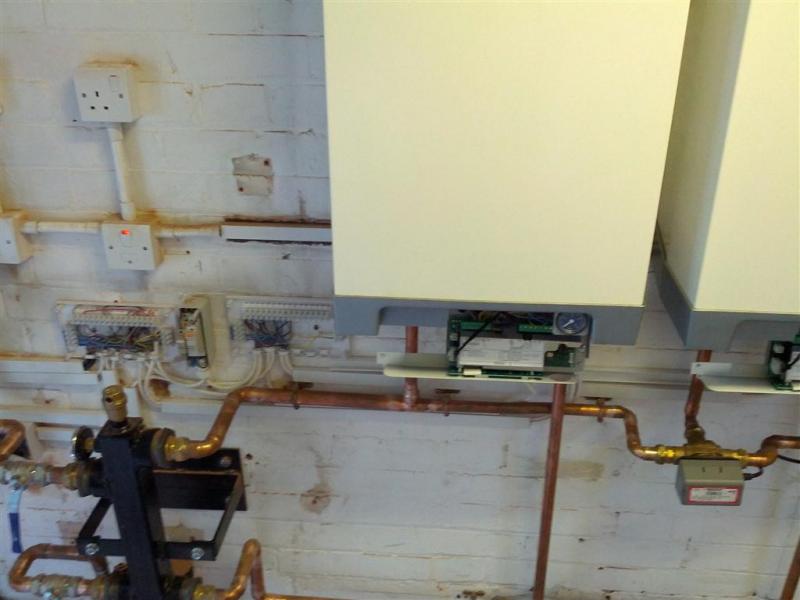

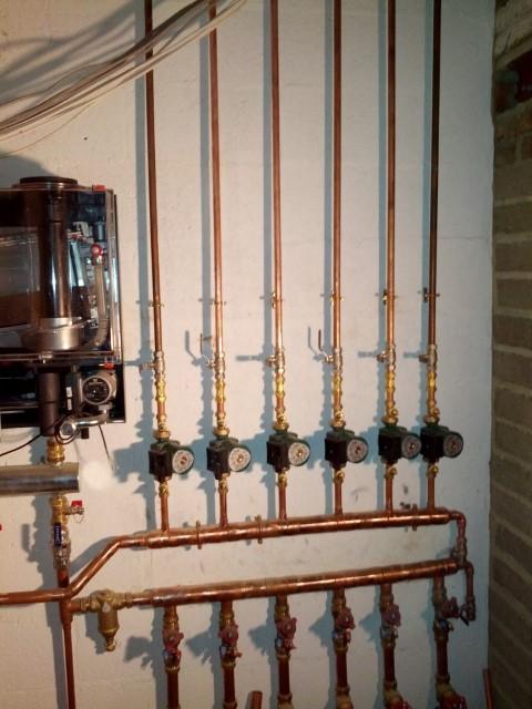

Multiple pumps are not a new concept to me.
Note the first three picture have a pair of Atmos System boilers.
The last three has a distinct lack of zone valves. :wink:
Thanks Dan. Nice pictures. I did a Google on a facebook page had a couple of Intergas boilers on a header and some nice pictures as well. Lots on the web when you look.
Some neat work there. Simple as well.
Dan, I noticed the hepVo trap in one picture - nice traps. I also noticed on the Intergas manual that the condensate and pressure relief valve seem to empty into one point. Does that mean they can both go into one HepVo trap? The manual is not that clear on this point.
