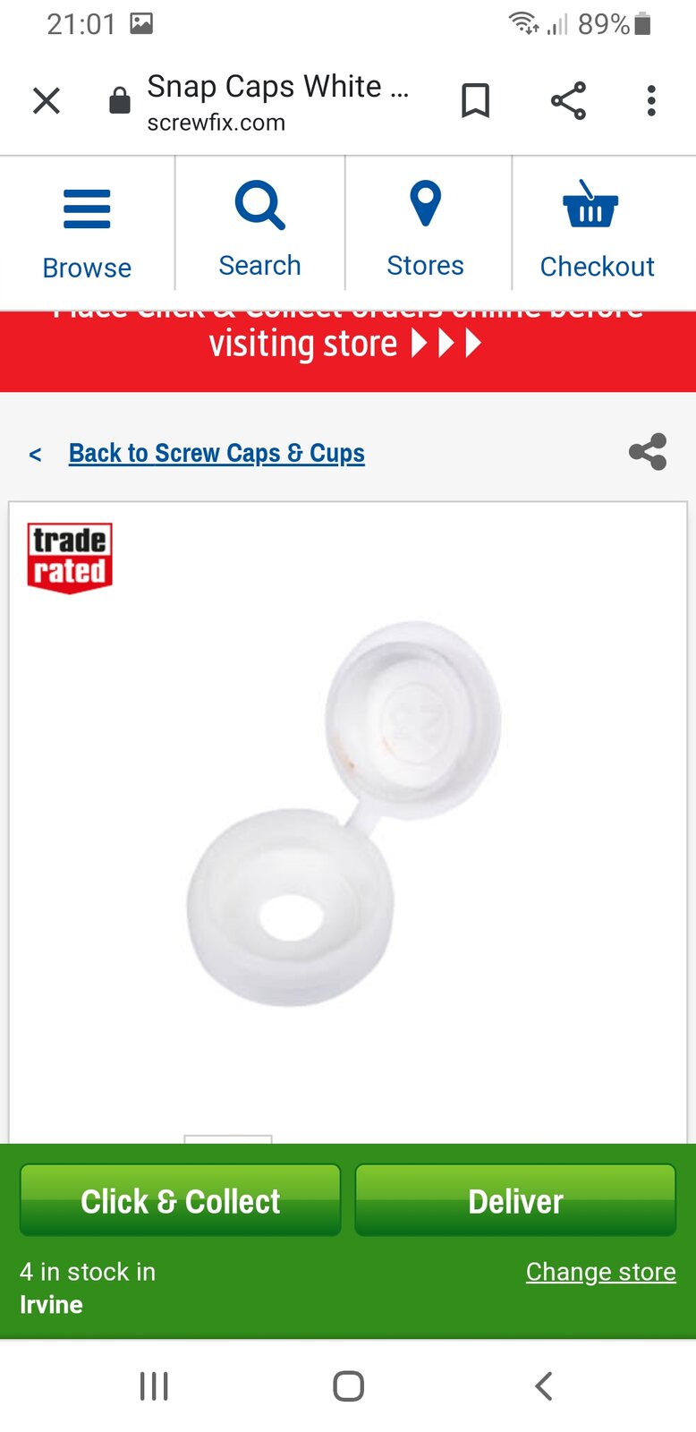

This is what you need
Screw caps.

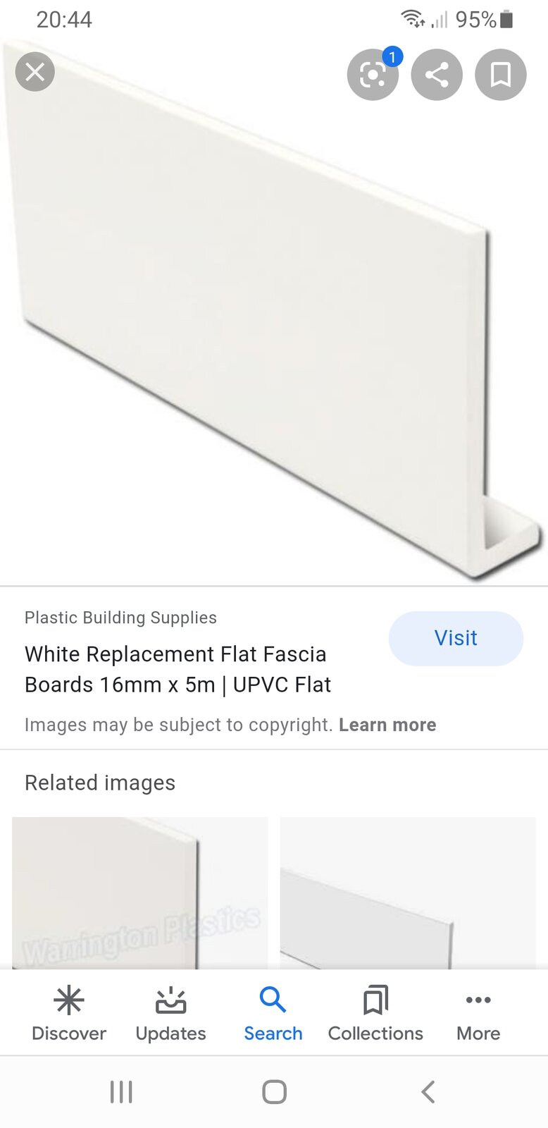

Fit a backing timber first to space the fascia of the wall and form a drip, then you can use normal polytop nails
