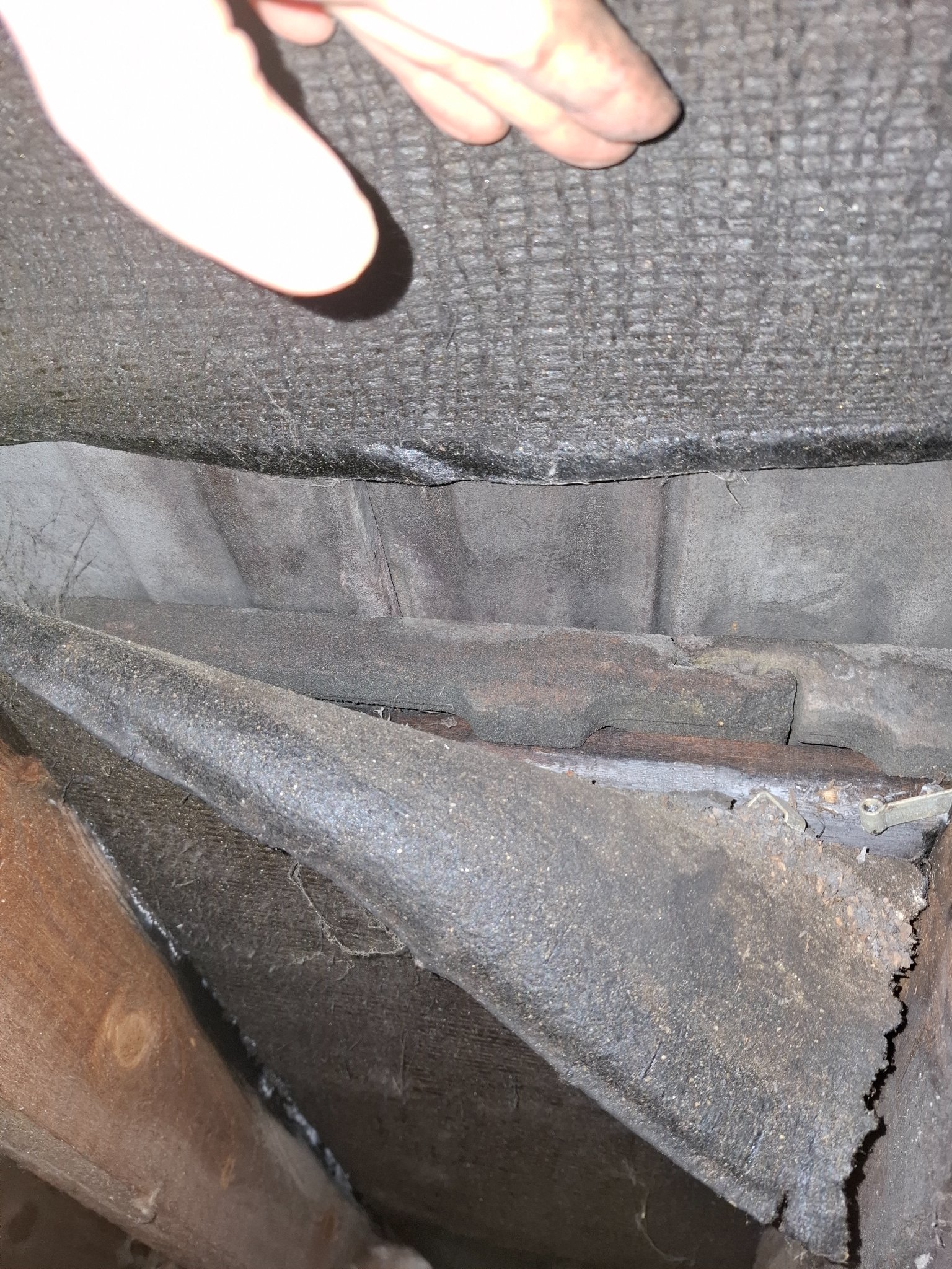

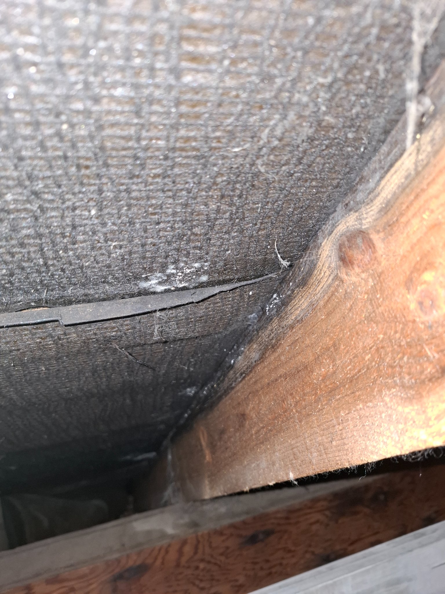

Hi,
I have some attic condensation that has worsened after installing 170MM insulation last year and the wet winter. Some white mold now appears to have spread on the felt and edges of the rafters on the north side, which is concerning. The floorboards are dry though.
This is a 70s roof with no soffit vents and bitumen felt. I have had the bathroom ducking done, cleared the area around the passive air pipe and will add some felt air vents later this week. It is hard to achieve full seal as the narrow eaves are hard to access. Any tips would be highly appreciated before roofers comes in.
Ta

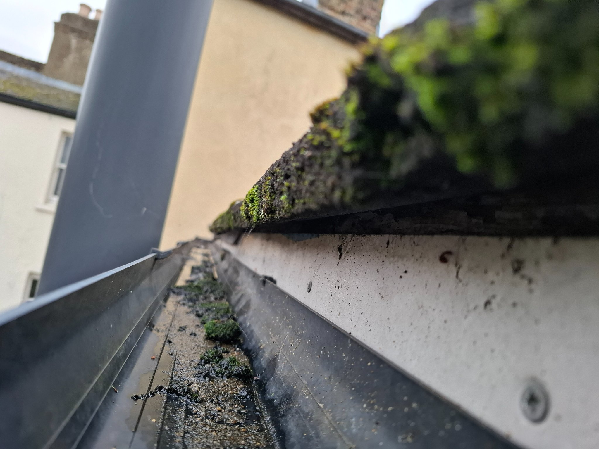

This is where to roof meets the external wall. Not much space for vent, or is there a way?

Roofer came by and suggesting installing four vent tiles. Said roof too flat for over fascia vents. Would that help?
I bought these as well but couldn't fit them under my tiles.The tiles are sitting on the felt and there is not much space. I have put some slim wood planks in the meantime.
I also wonder if my laundry air dryer in the living room is not making matters worse.
It will be making the whole problem much worse, and increasing the moisture levels throughout the house generally - find another way, and get rid of it.
