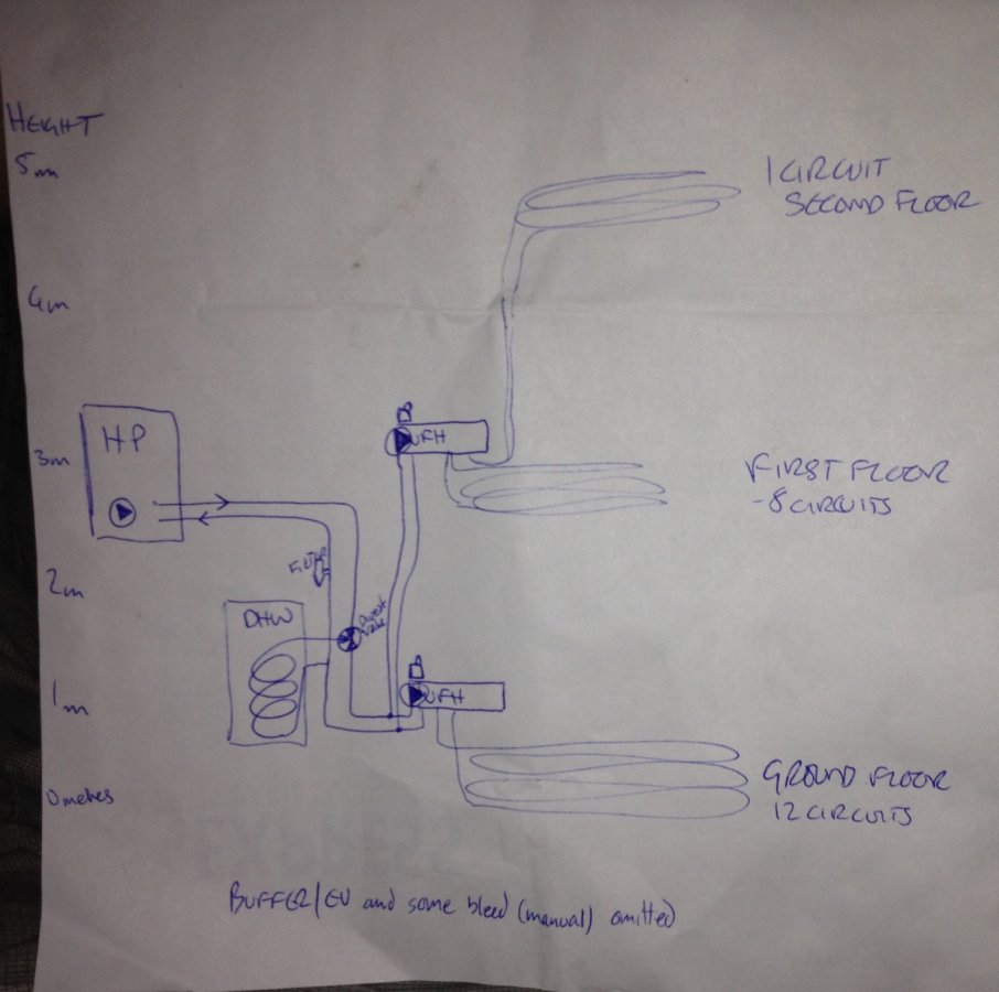

My air source heat pump is mounted on the wall outside about 3 metres up. The flow comes in at ceiling level, down to a diverter valve that chooses DHW or UFH. In DHW mode it runs round s coil in the adjacent tank and returns. In UFH the flow drops to ground floor level and splits, one to ground floor UFH manifold, the other way up to the manifold on the first floor.
Both the manifolds have Auto bleed valves on them, and are less than a year old. Occasionally a fault of no flow/no water in the circulator is logger by the heat pump. I'm able to get things running again by leaving the system to sit in a fully inactive state for a while (overnight) then opening all UFH circuits and setting both UFH pumps on max (they're normally on 1-2 out of 7) and power cycling the heat pump. A long sequence of gurgling and whooshing noises and the fault normally clears. I think it's fair bet that the pump in the HP got air locked and the UFH pumps were enough to drag fluid through, but this system has been in constant op for at least 6 months so I was hoping there wouldn't be much air left. The manual bleed points I have available never have any air in them. I don't know if there is s bleed valve in the pump itself and I have a concern that it's naturally a high point in the system because of how its plumbed (the DHW diverter being lower means air in the HP wouldn't naturally drift into the upstairs UFH circuits?) so ultimately I'm wondering how to get the blenders I have to expunge the air I have- do they work if the pumps are pumping fluid constantly or do auto blessed need periods of inactivity in the system to allow bubbles to write into them and not get pumped past them?

Edited first post to add a sketch of the heights of certain components

Can an airlock cause this behaviour? Can it be possible to have 3 pumps in a flow/return configuration system (see image in first post for diagram of heights), one is airlocked and doesn't pump anything but the other two aren't airlocked and can pump, yet they cannot clear the air lock from the third pump? What did leaving it overnight do?
You need to have someone have a look at it. Air will collect at the highest point.

You don't mention but there would normally be bleed points, usually auto, at the heat pump as its a high point. You seem to imply that you don't often visit it because of its high up location.
Tony
Well, it's only been in about 10 months. The cooling circuit is filled with the recommended ratio of Fernox HP5c, all underfloor, estimated system volume 260 litres, I think the EV is either 12 or 18 litres - it was sized and supplied by the installers. It's hard to imagine a corrosion cause as 95% of all the internal surfaces of the system are plastic (ufh pipes) with a small amount of copper, stainless and brass making up the rest. HP5c has a suitable inhibitor in it I think.
There are 3 bleed points I know of for certain: one on each UFH manifold and another copper dead leg with a "bicycle valve" installed by the engineer that fitted the system. The manual says there is an an additional BV inside the heat pump (outside, on a wall):
http://www.centralheating.co.uk/system/uploads/attachments/0000/4876/geoTHERM_air_manual.pdf on page 8, says it does have one (component #9)
I don't know how/if the layout of that diagram relates to the actual component positions; I last had the covers off the heat pump when I was playing electricians mate, wiring the control switching into it ages ago. It's now half way up a wall and would require a ladder and some lift/twist to access it; my back is currently capable of neither.. (and at less than a year old, I'm not certain I should be fiddling with that aspect!)
