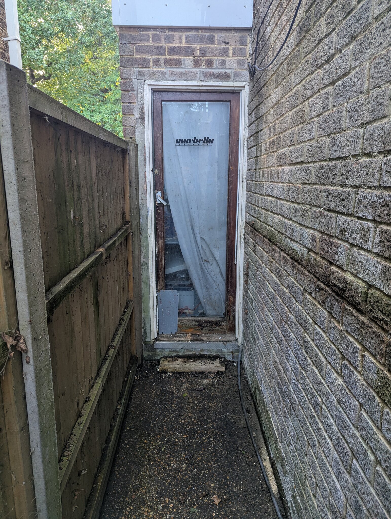

I have this gross alley down the side of my house. South facing we all and a door that's never used and needs filling in.
I want to put a lean-shed thing down here. It's 800mm wide.
Open season on ideas and recommendations.
Trying to keep costs down and I have a 1.2x2.4m sheet of EPDM-OSB-50mm PUR-OSB I'm looking to use.
Knocking a lean to up shouldn't really be an issue but are your neighbours going to be happy with you either dumping all the run off water over their fence or having some sort of guttering over their fence line?
If you have to have any guttering your side your unlikely to end up with any useable space.
I have somthing simular and put posts in on my side and the lean-to was made with twin wall polycarbonate clear sheets using a combination of support rafters and twin wall polycarbonate joining strips.
I added a gutter on my side that I was able to connect to the main downpipe.
Its now a dry usable light area
I'm thinking either slope it down with a gutter across the width of the alley or gutter directly over the fence line.
Will chat with neighbours, but don't anticipate a problem. Water runs under the fence whether it hits a roof first or not.
You will need a gutter and be able to dispose of it on your side. Apart from that you don't want sheets of water running off the lean to down your side of the fence and running back to the house. It already looks damp down there at the DPC level
Oh, I'll have some upturns and gutter to stop runoff hitting the wall. But you are right it's a damp dingey corner
You could ask your neighbours for permission to attach the rain fall off to their square down pipe?
It’s a very small area and my mate has a car port which uses square upvc posts that act as downpipes and gutters, could you build a frame from that?
I’d be tempted to sort that door out before anything. Either repair, replace or block it up as once there’s a roof in the way it will be a nightmare.
By fitting blocks to the fence posts, and house, you could build supports that hold up a structure inward of the fence line by 100mm? Then run a gutter along the fence line on your side. A bit of engineering might allow that door to open out?
