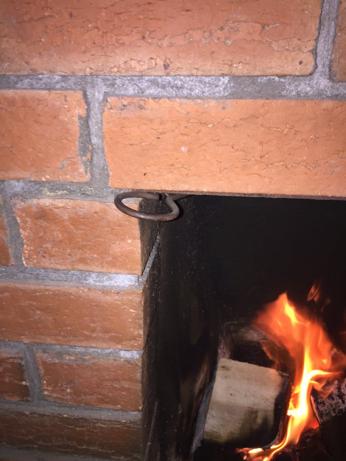

Maybe a picture of the damper arrangements could help us here Caroline, but the hot gases from your fire are usually directed under the back boiler in your fireplace......that's the only way the water will properly heat.
The damper levers are often either just in the chimney itself or to either side of the fireplace.

Hi John
Thank you for your reply. I'll be the first to admit that I don't really know anything about them other than the fire heats up the water and we get hot water haha.
Ok, now I'm on my phone so not sure how to upload photos onto here so apologies if I do it wrong.
Hopefully this will work, this is the lever that we use, pull it forward (it's in the forward position) for the fire to heat the boiler, back to close.
I couldn't really get any closer photos as it's currently lit.

On the right track, I think.....if you completely empty the fire grate, you should find a slot at the back of the fire that will be blocked solid with ash and crap. This needs to be cleaned out so that hot gas and flames can pass under the boiler and around the back, heating the water as it goes.
You can check the operation of the damper with a smoke match or a fag.....one way, the draw should be under the boiler, the other just up the front.

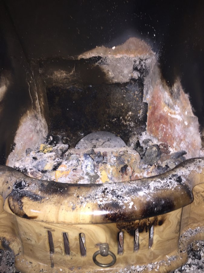

Morning
Ok so I've taken another photo so you can see the hole and the back of the grate.
Excuse the mess I haven't cleaned it yet. :whistle:
Thanks :)

Have you managed to uncover the channel under the boiler yet, Caroline?
Nige is absolutely correct regarding the grate.
John :)
Err, channel under the boiler???
Is that that arch at the back?
Sorry, I told you I know nothing about these things :whistle:

I can only generalise here, but usually there's a passage at the bottom of the boiler which allows hot gases to pass around the back.
If you can give us a pic of the thing cleared out, and grate out of the way?
John :)

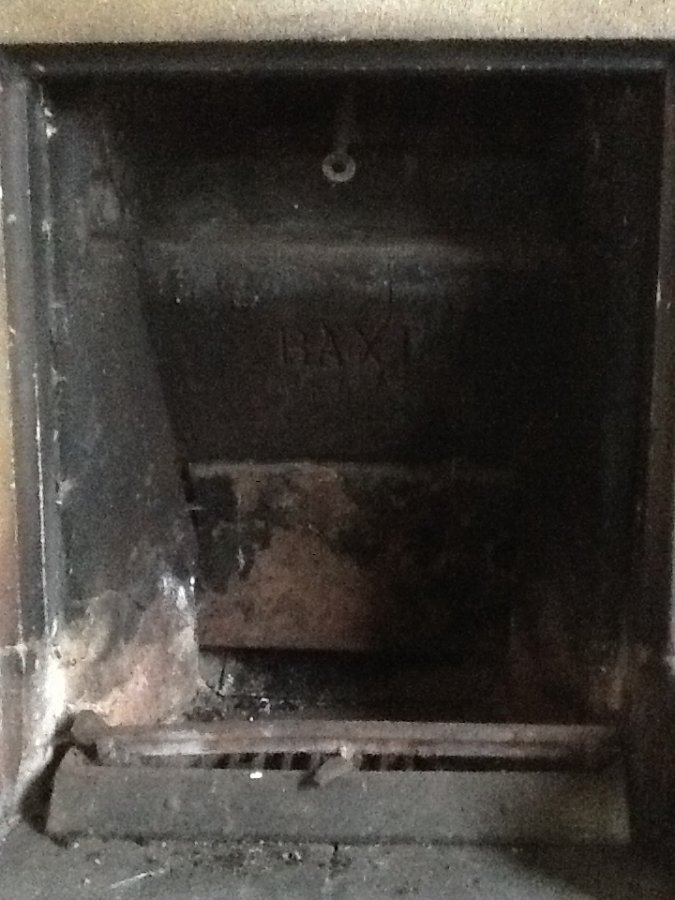

image.jpeg OK, see if this helps. Though it's not a elevated grate like yours you can see the dimensions from the photo.
There's a flue way behind the back boiler & a damper at the top of the flue way. The bottom of the back boiler sits about 50-70mm above the grate.
Milner did at one time manufacture a one piece fire back with a cut-out for a back boiler.
