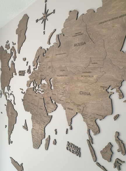

After some advice with this please.
Looking to install one of these in my home office:

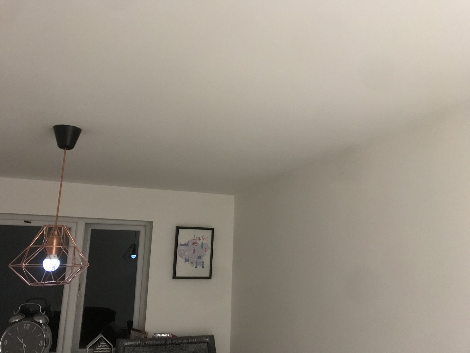

The room has this ceiling light and the live feeds are at the ceiling rose.
We have the loft avoid above this room.

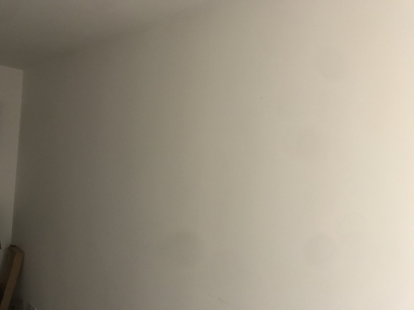

The map will go on the plain wall seen in the above image. Here’s another picture of the wall in question:
The walls have dot and dabbed plasterboards.
I would like to have a backlit effect on the map. Don’t want it to be too bright and would like it to be evenly spread. Which type of lighting do you recommend for this?
Assuming I need a transformer, where should this be situated and how do I devise a safe zone for the cable as it comes down the wall?
Thanks in advance.

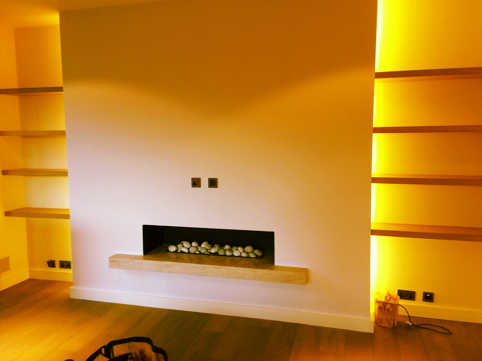

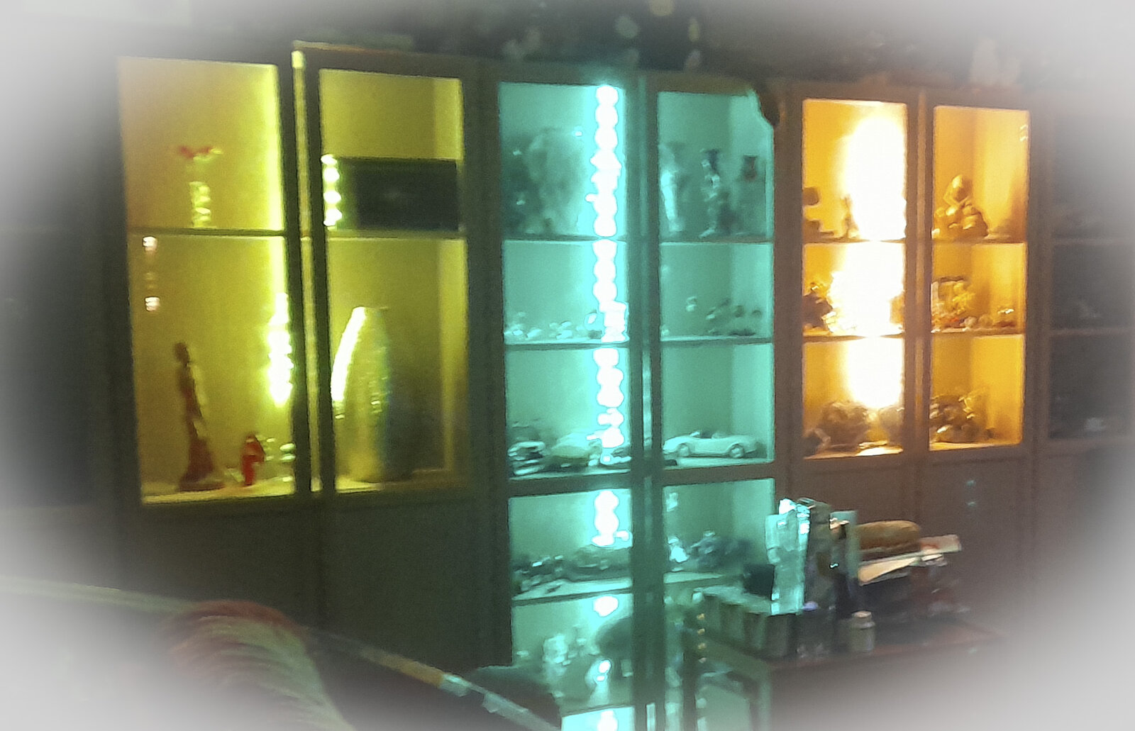

Some thing like this 1658656165919.pngon ceiling would likely be a better method, strip lights 20220704_220311_1.jpg as used here to light my display cabinet are a series of small LED lights, so need some distance or you can see where each lamp is, a sheet of opaque perspex will help to defuse the light, but looking at a light which will be quite thick.
Lighting from side and top 1658656804851.png the light tapers off, likely easiest is Christmas tree lights as so many in a string. You can get ceiling lights for suspended ceilings which could cover area, but would be far too bright.

It sticky to the wall using double sided tape by default. hey are chunks of wood and you can see from the images that some are separate pieces where some of the countries exist as one piece of the overall jigsaw.
I could look to modify this by using some spacers to have it lifted off the wall slightly in order to get some lights behind it but based on the above, I 'm unsure on whether there are any decent options for having a backlit effect.
