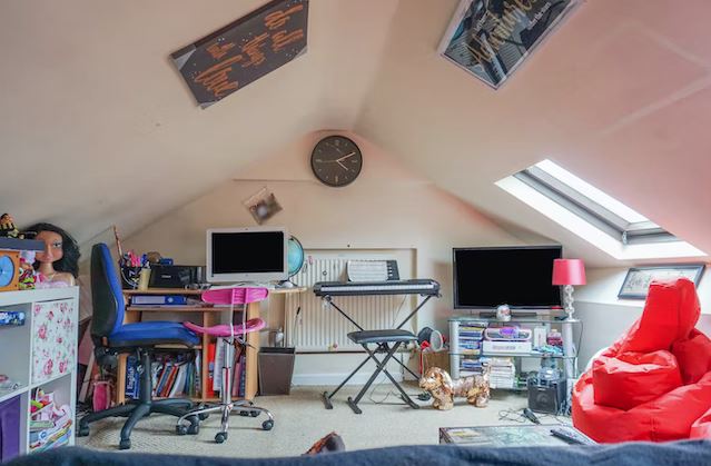

Hi, son bought a mid terraced house a couple of years ago.
The attic has been converted into a room, see attached pic (estate agents pic before he bought house), but it wasn’t listed as with a loft conversion as it isn’t up to standards.
Surveyor also said it breaks various rules (especially the steep stairs) hence cannot be considered an actual 3rd bedroom.
Son wasn’t bothered, liked the house…..
In the summer it’s like a sauna in there, in the winter it’s like an igloo.
He’s also finding it hard to keep the house warm.
I suspect there’s no or little insulation under/behind the boards (both on floor and on roof)
Any suggestions as to how best proceed? For example, would simply laying a load of loft insulation over the attic floor help?
many thanks
Insulation in the floor won't help, only insulation under the roof will, looks like space is tight though presumably generally inhabited by his kids, what is in the ceiling, behind the plasterboard insulation wise? An exploratory hole somewhere to find out may be the only way to find out. Is there a roof membrane under the tiles? You might be able to lift a tile and see what's what, though that's not without it's complications, ignoring the old illegal loft conversion that shouldn't be being used but is so insurance may be invalid if anything untoward should happen.
That said the radiator looks a bit small for the space or is there another one out of sight? Is it heating up OK?
If it's not being used, loft insulation on the floor will be fine, try and insulate the entrance in some way as well if possible.
Well.. unless it's insulated in which case we need to find out why it's no good
Can you get into the part of the loft that is behind the short walls at the edges of the pic? Might be able to crawl round and see what efforts have been made to insulate the space without damaging anything
Also if it's mid terrace and nothing was put on the party walls you'll probably have a single skin of leaky brickwork into the neighbouring lofts, in the summer those lofts will get very hot and in the winter be almost as cold as outside.
Might be solvable by ripping off the plasterboard on those walls and replacing with insulated plasterboard.
