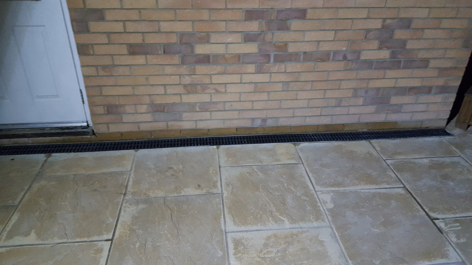

So I fitted the acos. But the row of bricks is still wet.
Any other ideas? Should I paint them with a sealant to stop splash back.
Is this normal? Could it be a leaking pipe from below?

Notice that some of the gaps between the slabs are still wet. This also seems to happen alot. So maybe a leaking pipe??
Or could it just be the ground is saturated so this is the cause??
If your patio does not run drain back to the house you've wasted your time and putting a drain in. Note that this 6" rule only applies to new builds (or it did, when I was still landscaping). There is no rule that says you can't lay a patio up to the roof, if that's what you wish to do! (slight exaggeration!). If you have no issues with damp inside I would quit worrying about it to be honest. It looks like you did a nice job of the drain, I should say.
Hi thanks for that.
I just keep worrying about it. The bricks below only ever dry for a small period of time and they dry much slower than every where else.
The fact that the gaps between the slabs stay wet even when the pavements everywhere are dry is making me think that the ground below mist be really wet.
Would making a soak away under the patio work and relaying on top.
If not surely the bricks will eventually blow and that will be more expensive??? This patio is doing my head in.
I have considered getting a surveyor as the next step.
