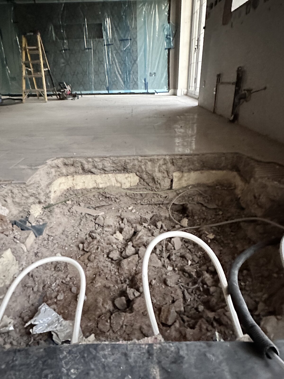

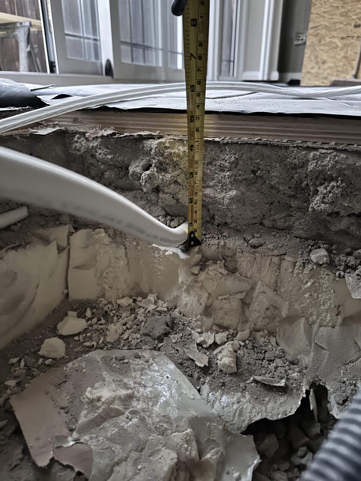

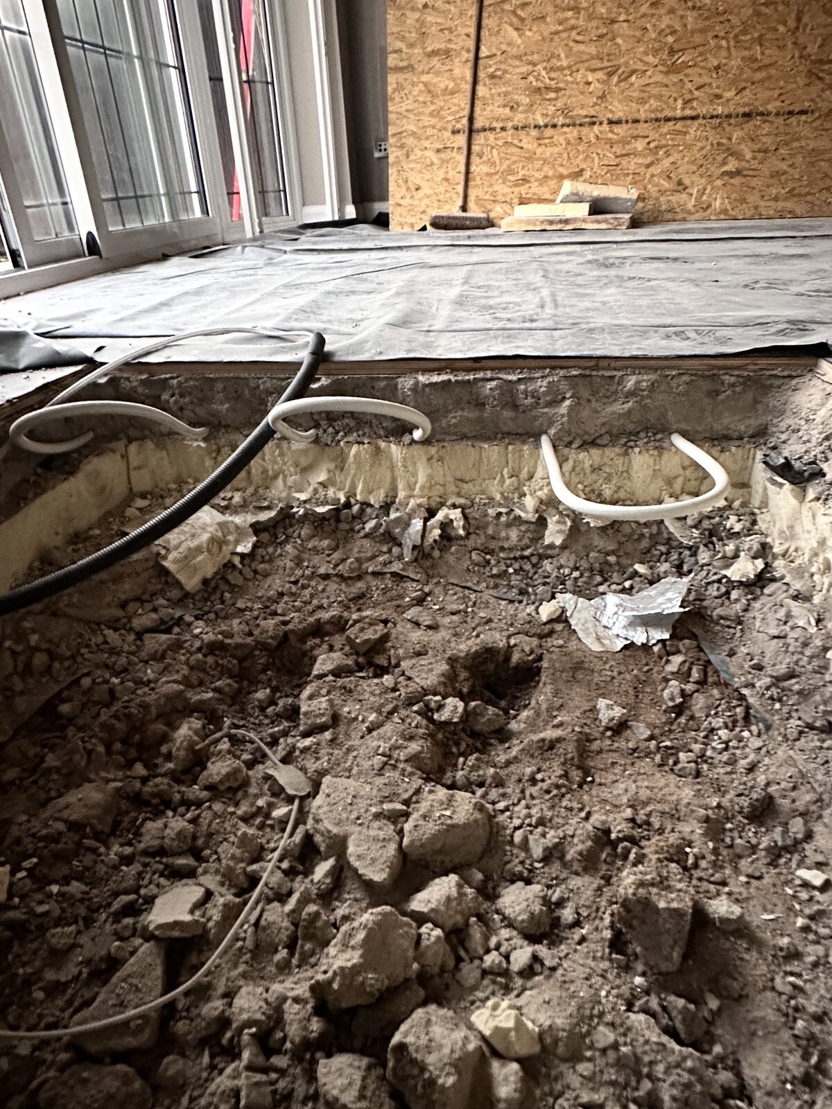

I've had wet UFH for 12 years and it takes hours to heat up our rooms. My gas bills are extremely high especially now due to rising costs.
i'm not getting a minor renovation and my builder has discovered that the pipes are under 120mm of screed. ATM the concrete takes hours to heat up but then it does release heat for several hours.
It does have thick insulation boards under the pipe so if there's no downward heat loss i'm wondering if i'm losing heat or does the concrete just act like a storage heater.
Now i'm wondering if it's worth me doing retro fit on around 100m2 flooring at a cost of probably around 18k would it ever pay for it self or do I just live with the buried pipes

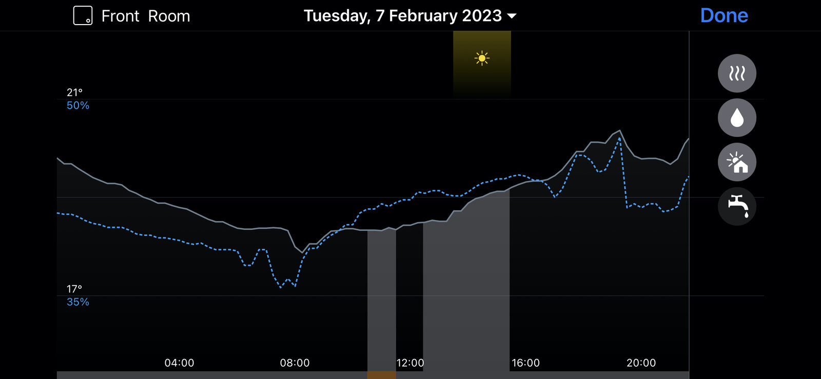

This is my graph from my thermostat

I guess what i'm trying to figure out is if my UFH has been botched
as I have 110mm PIR i'm guessing 120mm Screed is ok as it's a different kind of design

I guess then I can bring the flow rate down and run for longer instead of over shooting, yeah we spent alot of time at home especially with working from home. From what your saying it's not a botched install even with 120mm screed I guess this isn't a low profile system.
My heating bill was predicted to be £650 ish just for gas for a 2700 sqm house i'm hoping if I run lower at 40 deg and run for longer (keeping the concrete heat topped up) and not over shooting i'm hoping to bring my bill down.

The TMV is around 45 at the moment I don’t run constantly at the moment I heat for 4-5 hours overshoot and leave it off.
Sorry I meant the house is 2700 sqft yes the screed is showing around 120mm at the moment which is why I’m contemplating refitting. But as you say 18k is a lot of money may be I should try and live with it and keep it on 24/7 but at much lower flow rate.
If you redid the screed thinner it would heat up quicker, but overall the house would still lose heat at the same rate as before so you still have the same problem; you're suffering a loss and paying to throw consumption at overcoming it
If instead you take that 18k and use it to insulate and draft proof the house you reduce the loss you're suffering which means you no longer have to pay to overcome it
Actually I’ve just remeasured
And the builder is including the screed from the bottom of the pipe. So it’s actually
100mm pir boards
And 90mm screed and this is actually the edge so may well be lower in other places
Doesn’t appear to be worth ripping out just for that as I know ideal is 60mm to 70mm

It wouldn't be worth ripping out in any case; you're trying to solve a problem caused by an incorrect usage pattern. Better to insulate the house and run the UFH constantly; it doesn't matter what thickness the screed is then, and you're prepared now for changing usage patterns of the house (eg when you're older and home more)
