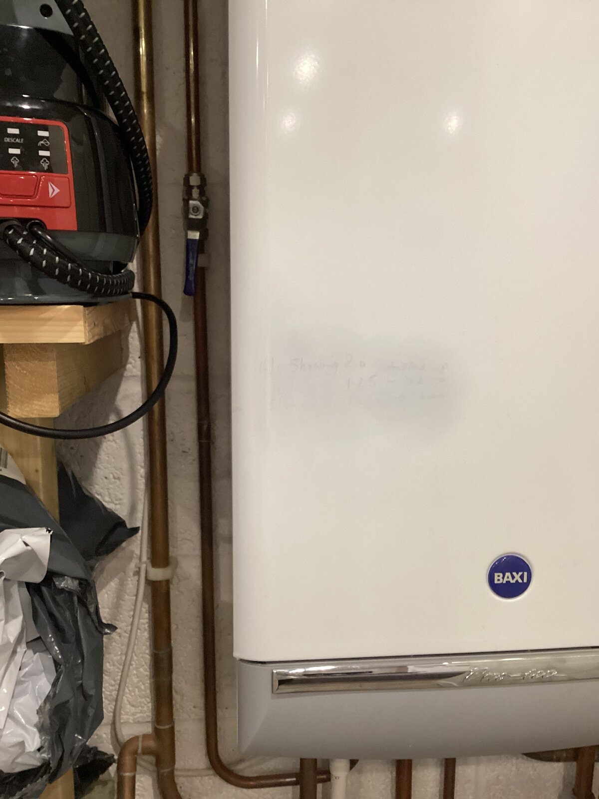

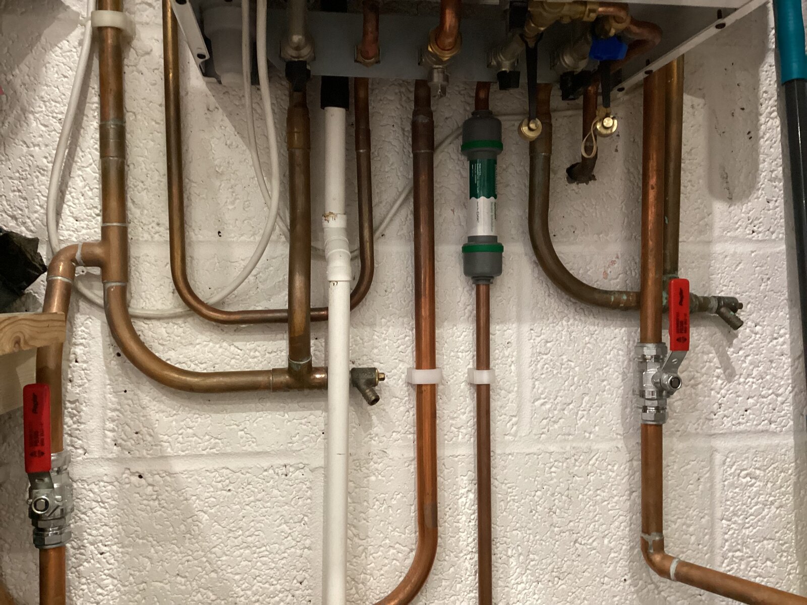

Is there a bypass?

Yes the system has mostly worked fine for the 7 years we’ve been here.
Couple of years ago I cleaned the gauze in the boiler return pipe as it was rusted up once and we lost all heat downstairs. Put it all back together, added some inhibitor and it worked fine.
This radiator always used to be the first to get red hot downstairs.
In April this year I first noticed it wasn’t getting hot and fitted a new valve on it, balanced all the rads and tried a lower strength chemical flush. Also checked the gauze in the return pipe again.
Then spring came and I left it until the autumn….
