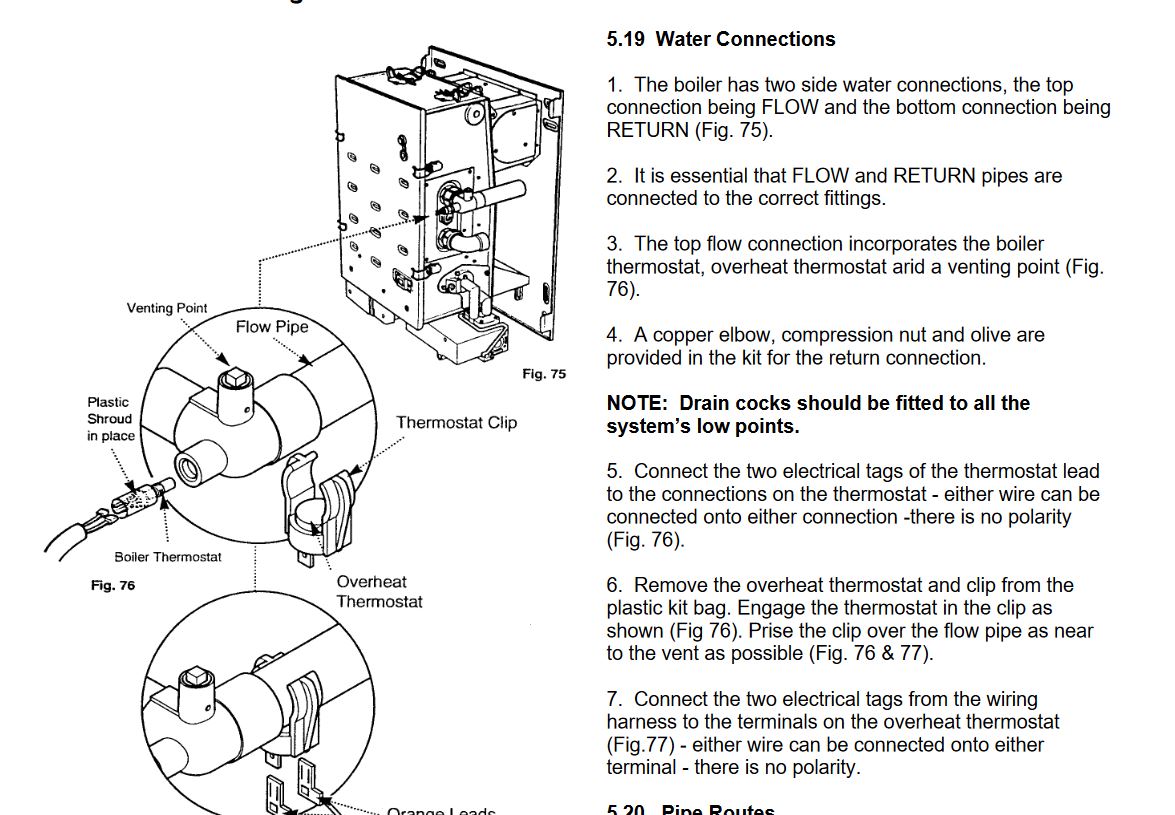

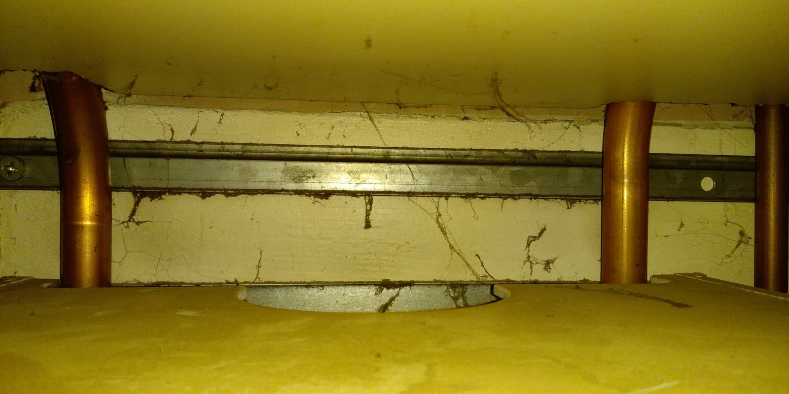

This is the top of the baxi... No vent?
Hopefully you have just got a slug of air in the system, you can spend hours trying to clear air locks but before you do just let the system stand overnight. Sometimes the air gets foamed up like in a pop bottle, if left it can rise up to one spot and the surge of the pump starting may clear it, well wort a try first

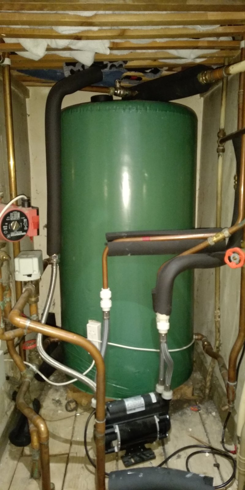

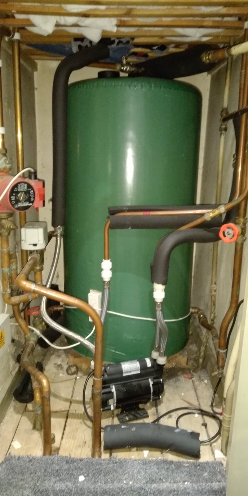

Potential air trap around the motorised valve look behind the grey plastic box on the pipe normally an air vent where the pipe enters the cylinder
Have just taken my son up to bed and the upstairs rads are all warm..... down stairs are all cold.... have left boiler on cycling through the power up down all afternoon early evening and there was enough hot water to have a shower as well......
Had someone round to look earlier and it seems it was something on the PCB that had blown so the pump wasnt working, hes temporarily bypassed this so the pump is on constantly so we have hot water and heating... and no banging and clanking.
