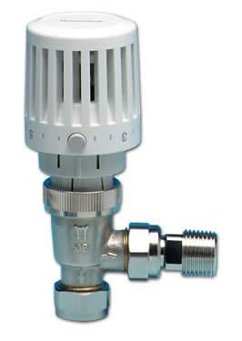

TRVs (Thermostatic Radiator Valves) come in two halves. The valve body is the metal bit that joins the pipe coming out of the rad to the pipe going to the boiler. The valve head is the plastic bit with numbers on that you twist to turn the radiator up or down.
The valve head is joined to the valve body using a knurled ring or similar. If you open the valve as far as it will go (turn the radiator up) it is usually quite easy to unscrew the TRV head by turning the ring with your hand.
Taking the heads off might stop the banging, but it won't help to narrow it down to which valve.
Personally, I'd start by trying to identify the problem more closely before taking all the TRV heads off. Maybe opening all of them as far as poss first. I'd do it while the banging is happening to see if altering any of them changes anything. If the banging goes away when you've opened them all, you need to identify which one brings the banging back by turning them all down in turn.

Look very closely at the trv valve body, it will have either 1 arrow showing direction of water flow or 2 arrows meaning the water can flow either way. it it has 2 arrows then it is not the trv. check them all if even 1 has 1 arrow and the flow goes the wrong way through it then open that one fully and the banging may stop although mostly they vibrate rather than bang. That is why the suggestion is to open them. I hope you understand now.
You could try isolating radiators from the system 1 at a time until the 1 without a trv is the only 1 on, just turn the trv to low and that will do.If banging still happens its not trv's.
Sorry to be stupid again. If im looking at the attached picture, which part do i open up?
David
Undo the big ridged nut under the plastic head and remove head. you will see a metal pin in the centre of the valve that should be sticking up about 15mm,if not gently pull it up with pliars but not all the way out of the valve.Then try heating again and see what happens.
Sorry onecog, but I thought it was generally considered a BAD idea to pull on the pin - because it is possible to pull it from the fitting??? I understood that the standard advice was to use a spoon in the palm of one's hand to press it in and out repeatedly to work away any sticking??
