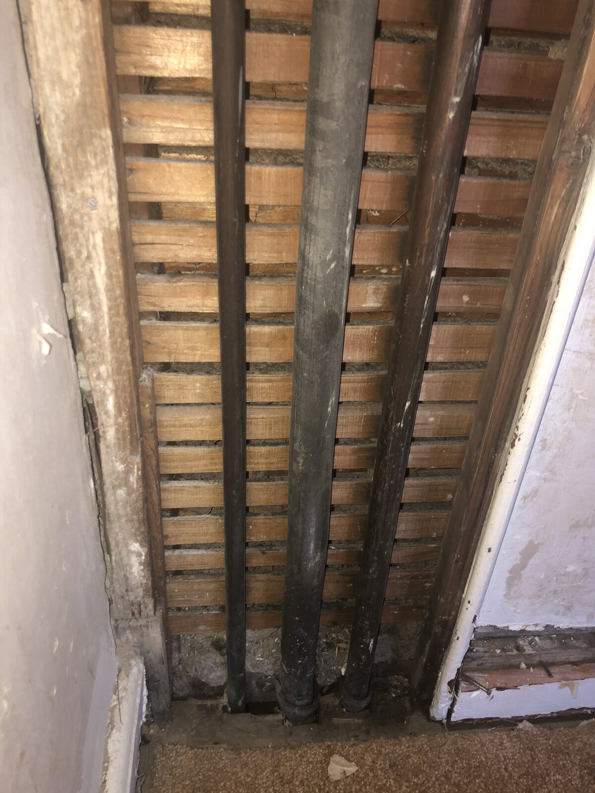

From what I can gather, everything is mains fed.
Both the bathroom and kitchen are on ground floor, rooms adjacent each other. The boiler is under the stairs on the ground floor next to the bathroom.
There is an old tank in the loft and in the first floor bedroom, there is 3 pipes running floor to ceiling within a boxed out recess. (See photo)
I suspect both this tank and these pipes are from a redundant system and all of my water supplies are mains fed now.
If this turns out to be the case, I’ll hope to dismantle and remove the tank and these pipes.

Obviously don’t assume (it makes an ass of u and me:LOL:) if you no longer have a hot water cylinder, and you have a combi boiler, then yes, likely all mains.
