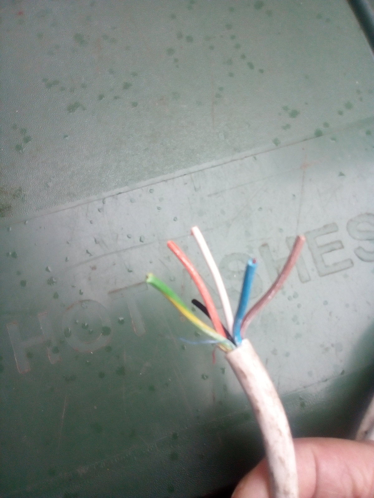

The original 'New colours' for a 5 core flex was widely publicised as 3 browns on posters in all the wholesalers, education establishments etc. I clearly recall the poster on the wall of our junior metalworkshop at school (so I would have been no older than 13-4 or 1968-9) and us discussing how dangerous it looked but the metalwork teacher trying to convince us otherwise. All the magazines involving electrical content of the era ran articles such as practical householder and even in my mothers womens magazines such as womans own and her asking me about it.
The 2 black version was several years later as far as I'm aware.
In the meantime there have been so many variations since 1969, for example this 5C 0.75mm² was purchased not long before covid:
One of my favourites is Bn,Bl,Bk,R,Gn/Y as it's not uncommon for me to have 2 dimmed stage lights in one cable.
