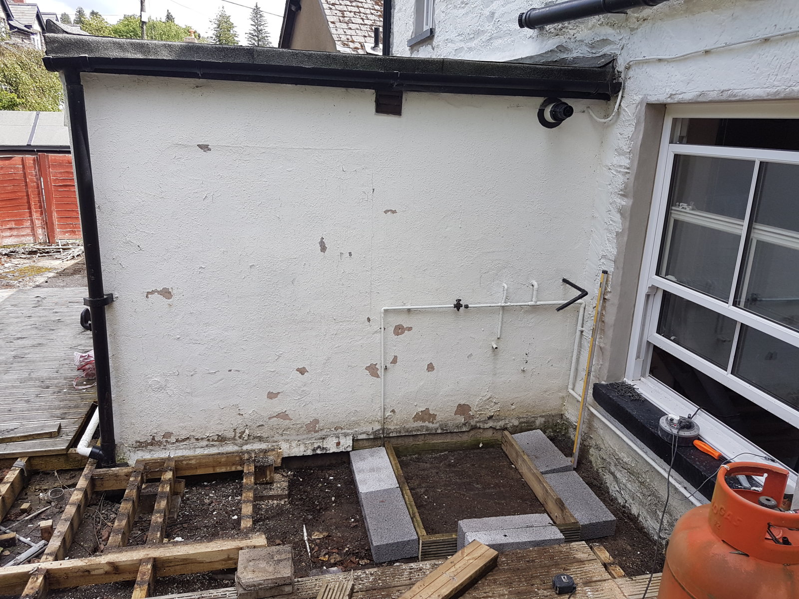

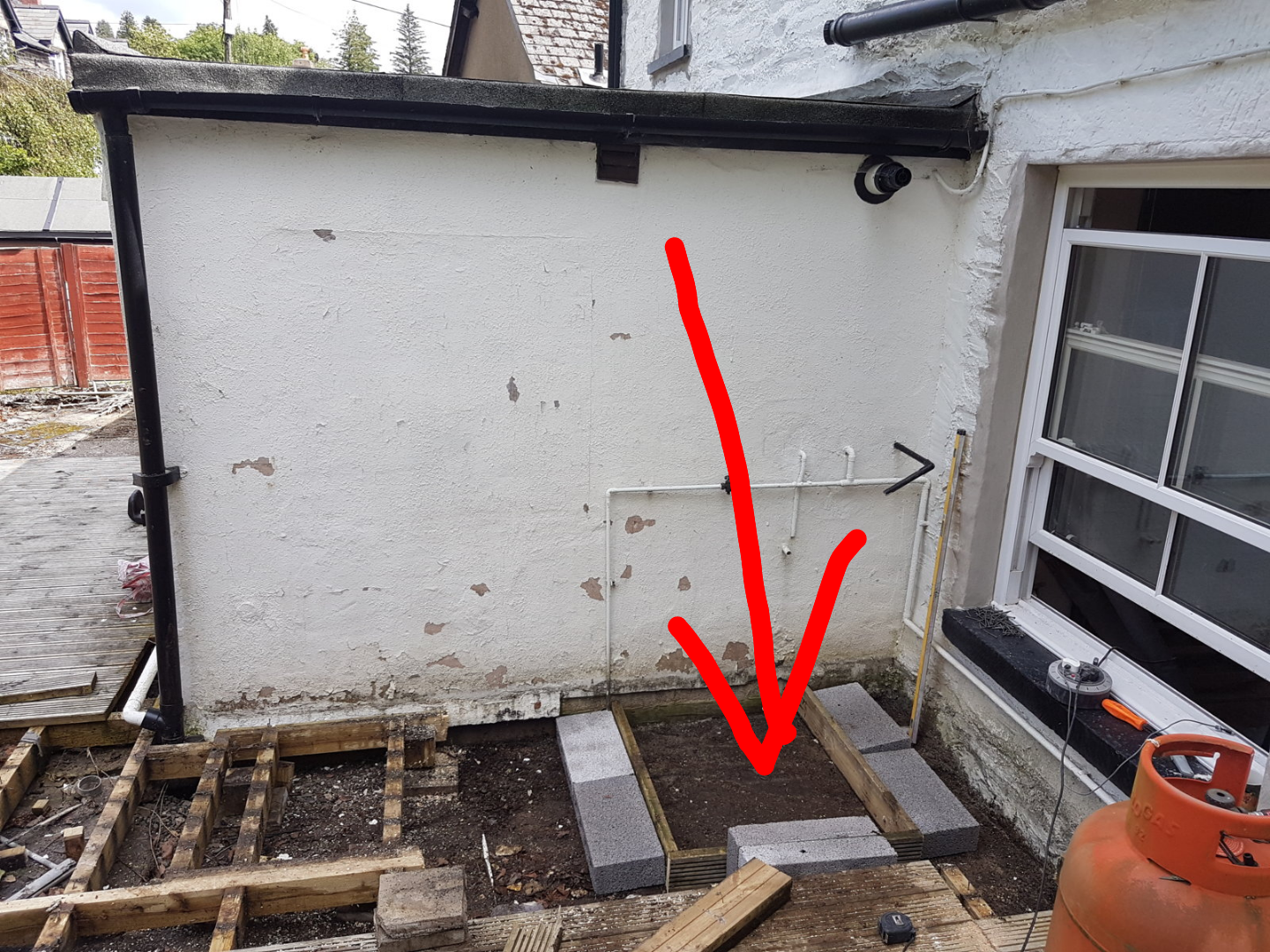

Are there any restrictions on the siting if an external oil (combi) boiler? I understand there are for the flue/outlet etc, but what about the unit itself?
In the photo I've marked a space that is approx 400mm from house wall at the side. Boiler will be installed against kitchen extension wall. Is this ok?
Is a 50mm concrete slab ok for it to sit on?
If it's this one, it needs turning round 90°. Some oil combis have service hatches at both ends, every external one I've seen has the screws which hold the lid on positioned at the ends, and I've only ever seen side exits for the pipes. Therefore, the long side needs to go against the wall.
No, 50mm isn't deep enough, you want 75mm on a bed of compacted hardcore. An oil combi full of water can weigh a quarter of a tonne, and you don't want it to sink into the ground or crack the base.

Thanks, I'll adjust the position. Boiler dimensions are 770x640, I'll make the base 800x800. The ground there is concrete already, but it slopes away from the house slightly, so I was going to lay a 50mm slab on it to level it. I'll do a 75mm slab though.
