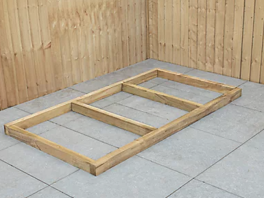

I am planning a lean-to shed that is around 3m x 60cm. It will be sitting on a concrete base that is already there. I am considering this type of frame which then has an OSB Board over it:
This OSB board will then be the floor of my shed when accessed from inside. I think it's a good idea to raise the floor of the shed as it removes the risk of surface water penetrating the shed. Let me know if you think any different?
I am concerned that these timbers will rot as water will seep through and get into this space when it rains. I could lay it over a section of rood membrane but would appreciate any advice around this. Since everything will be erected on this, it will be a mare to replace the floor at a later date.

Correct, that base will sit in water and rot. It needs to be raised off the ground/concrete, onto something impervious to moisture, like bricks, or tiles.

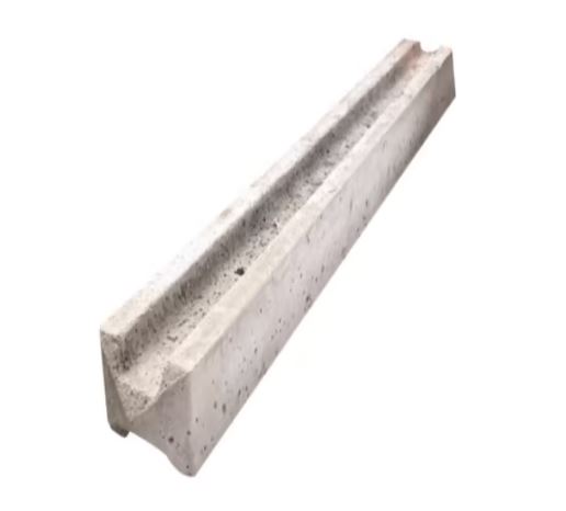

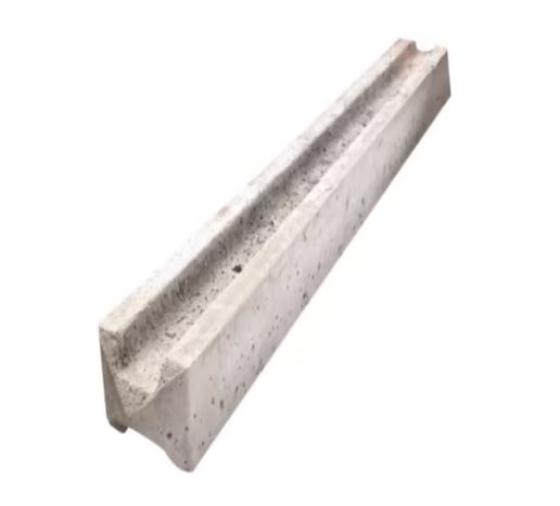

If it were I, I'd rest the shed base on concrete fence posts or railway sleepers. Means the timber isn't sat on wet ground and as mentioned, you get good airflow underneath.

Could the OSB Board (floor) rest on the concrete posts or should I still create a timber frame as show in the original post?
I'd build the frame without a doubt. It gives it a lot more rigidity. I have a small 2' x 3' shed used to store timber scraps for the fire, and the OSB floor on that has warped and dipped between the posts its resting on. I'm not fussed as it was free and I can't go in it, but for your shed obviously you'd want the strength.

If you have a concrete base which is flat, then you can just lay the posts on there.
I've attached a picture showing how they should be laid (if you go for this type of post). As the 'faces' of posts are often beveled/rounded, they wouldn't sit right on the ground, but if you lay them as in the picture then the ground and the shed base will both be sat on flat sides
If your base is flat and you lay the posts like this, you'll have no problems building the frame to sit on top of it all. When the posts are down, lay a long spirit level across them all to see if there are any which are sitting too high or too low. You could probably pack them out with a bit of slate or cement.
