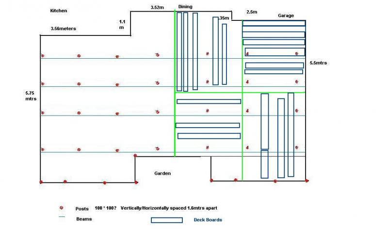

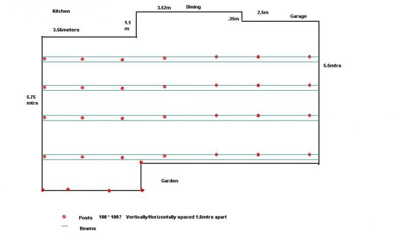

Another stab at the same. I have drawn a rough sketch of the planned base for decking, showing the post locations and beams.
Please comment if this would work or any other observation.
search a bit harder, ive answered about every decking question on this forum ;)
1: you dont need double beams, totally unnecessary
2:100 x 100 more than ample. nothing wrong with using offcuts of the 6 x 2. We normally space them about 1.5m. no hard and fast rule. you dont want the deck to bounce and it depends on the ground. if you need more put them in.
3:joist hangers are totally unnecessary.
4:Forget marking out the posts. Build the outside frame and get it levelled up. then put the joists in and lastly the posts where needed.
5:build the frame in two sections, so the ends of the joists all join in at the end to a central memeber and then start them again on the other side.
6:we dont use noggins. often run a timber member under the frame and fix it to the joists to strengthen them, but noggins are not really needed
picture is very nice and wonderful, but build the outside frame and the rest will fall into place. Never built a deck from a plan, waste of time. Personally i think the website you have looked makes a very simple job very complicated.

We just re-turfed the garden last week, hence would be tricky to build outer frame first, as we dont have much space. So even though, I would like to build the deck in two sections, would need to start with fixing posts.
Thanks for your comments on my pic. It's as basic as it gets. I have planned the deck boards as per attached image

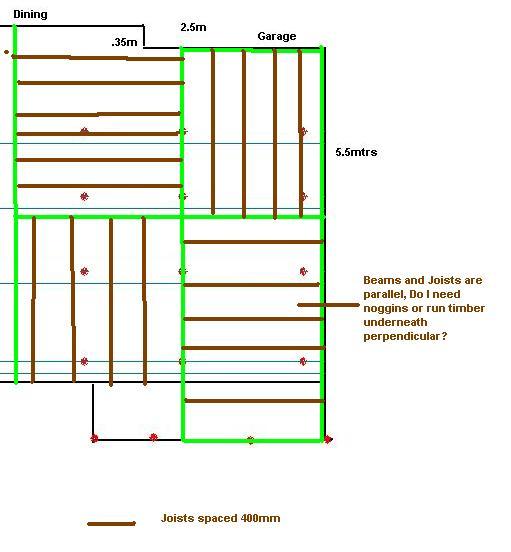

To acheive the above, I would have to run joists as below:
Would it cause any problems?
Also, since beams dont come 9.5 meters long, is the best method to join two lengths using 8 coach boalts? I would assume the answer would be applicable to joist as well!
In case of long double joist how to join them, or use the same method, but stagger the join?
Appreciate your help.
Regards!
build each section as a smaller frame, so you use shorter timber lengths and fix them perpendicular into the frame member
