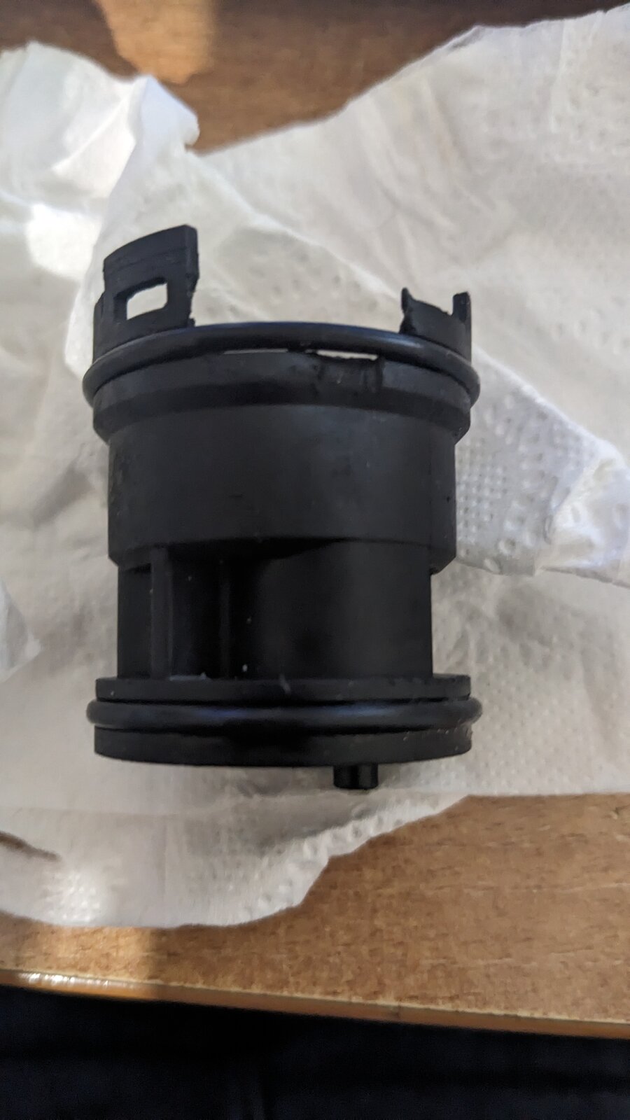

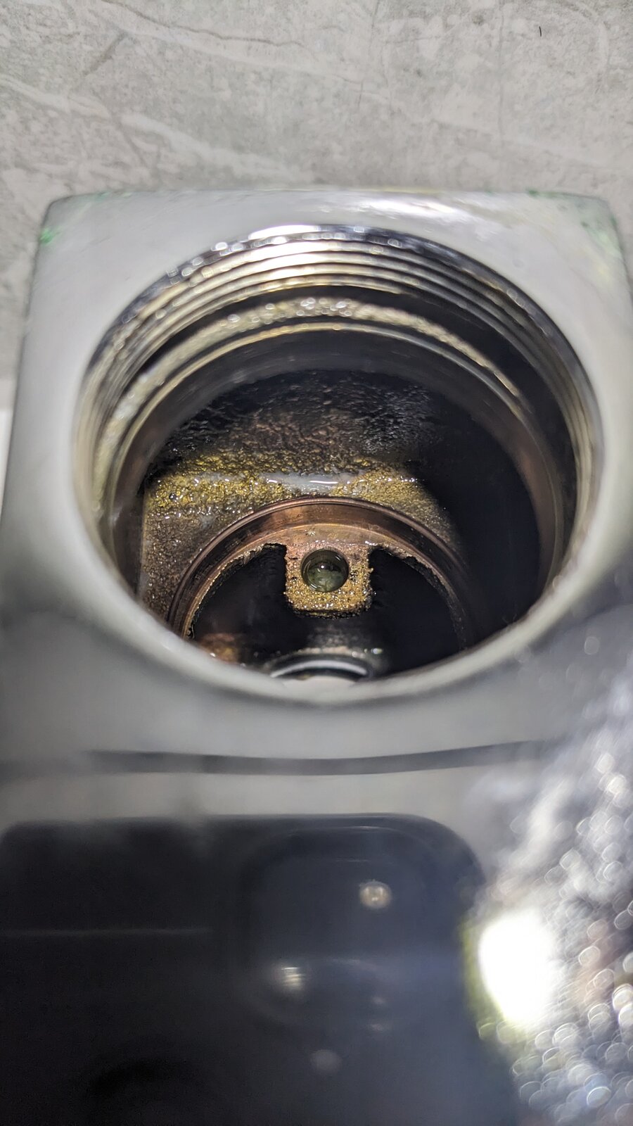

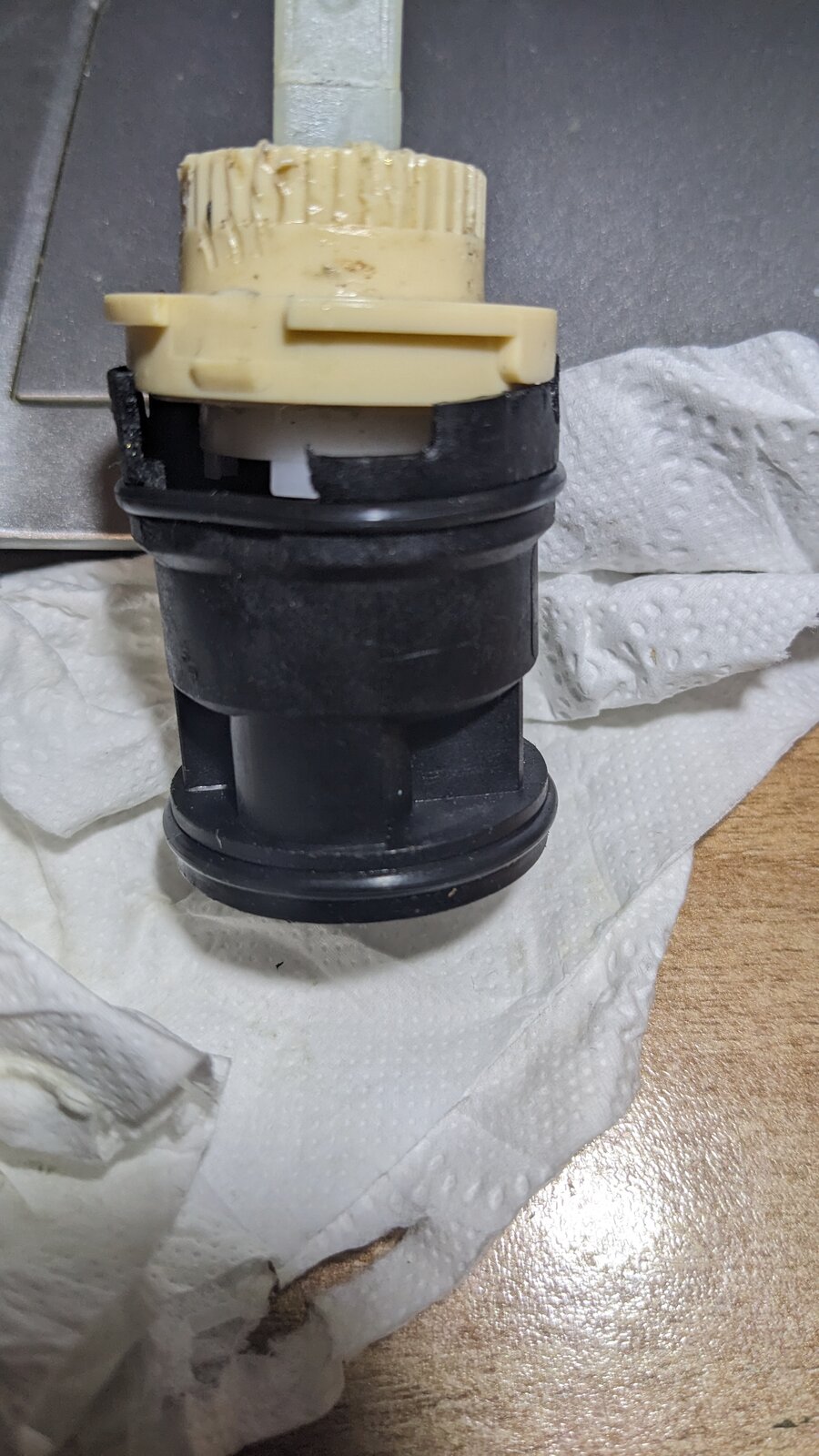

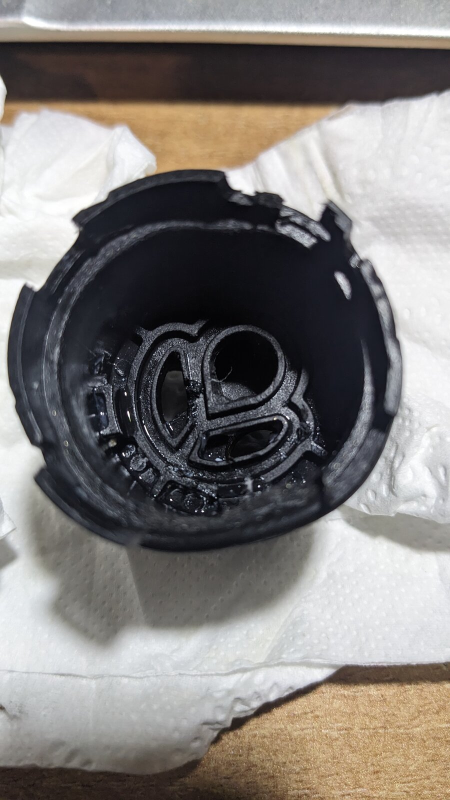

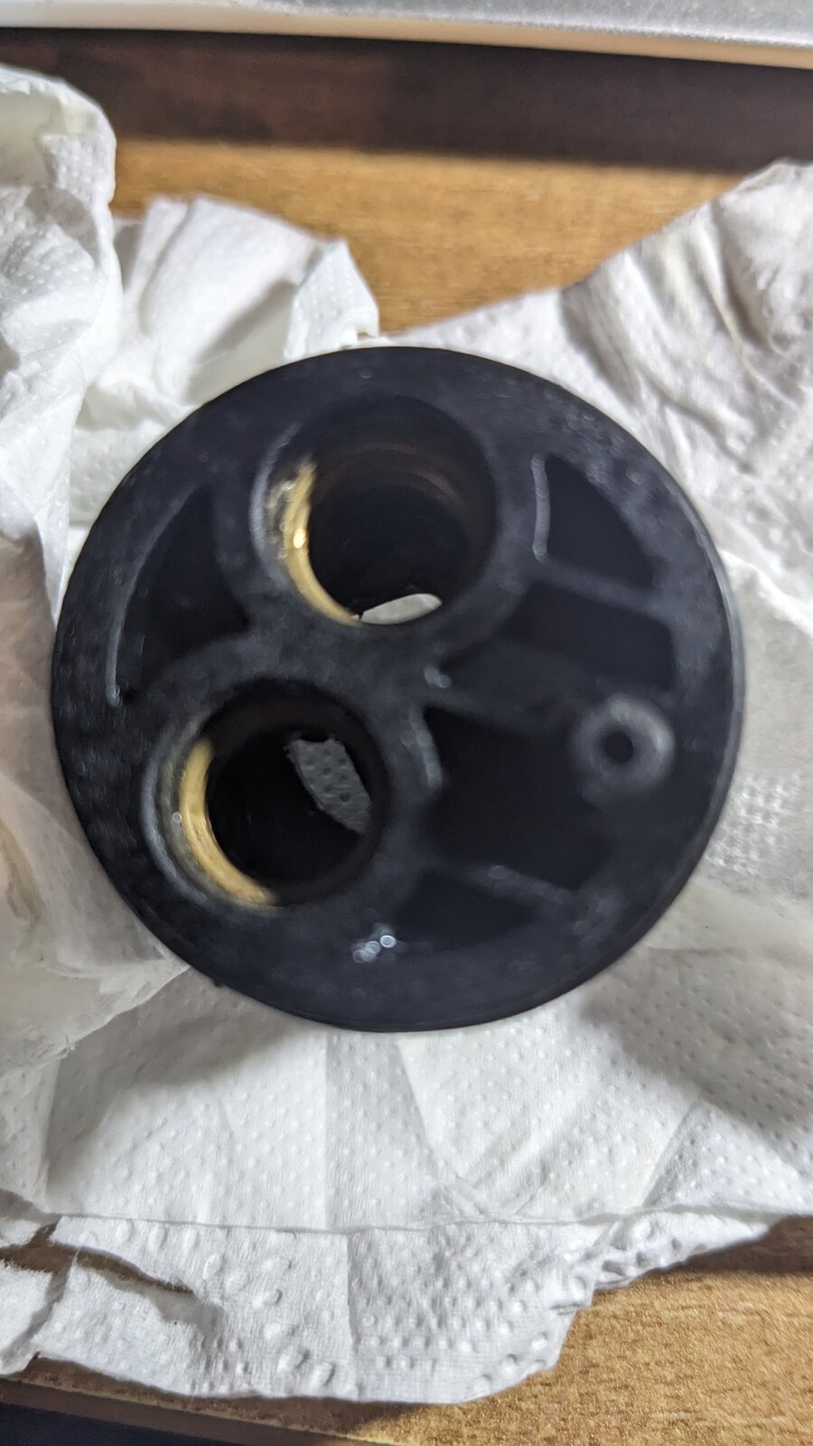

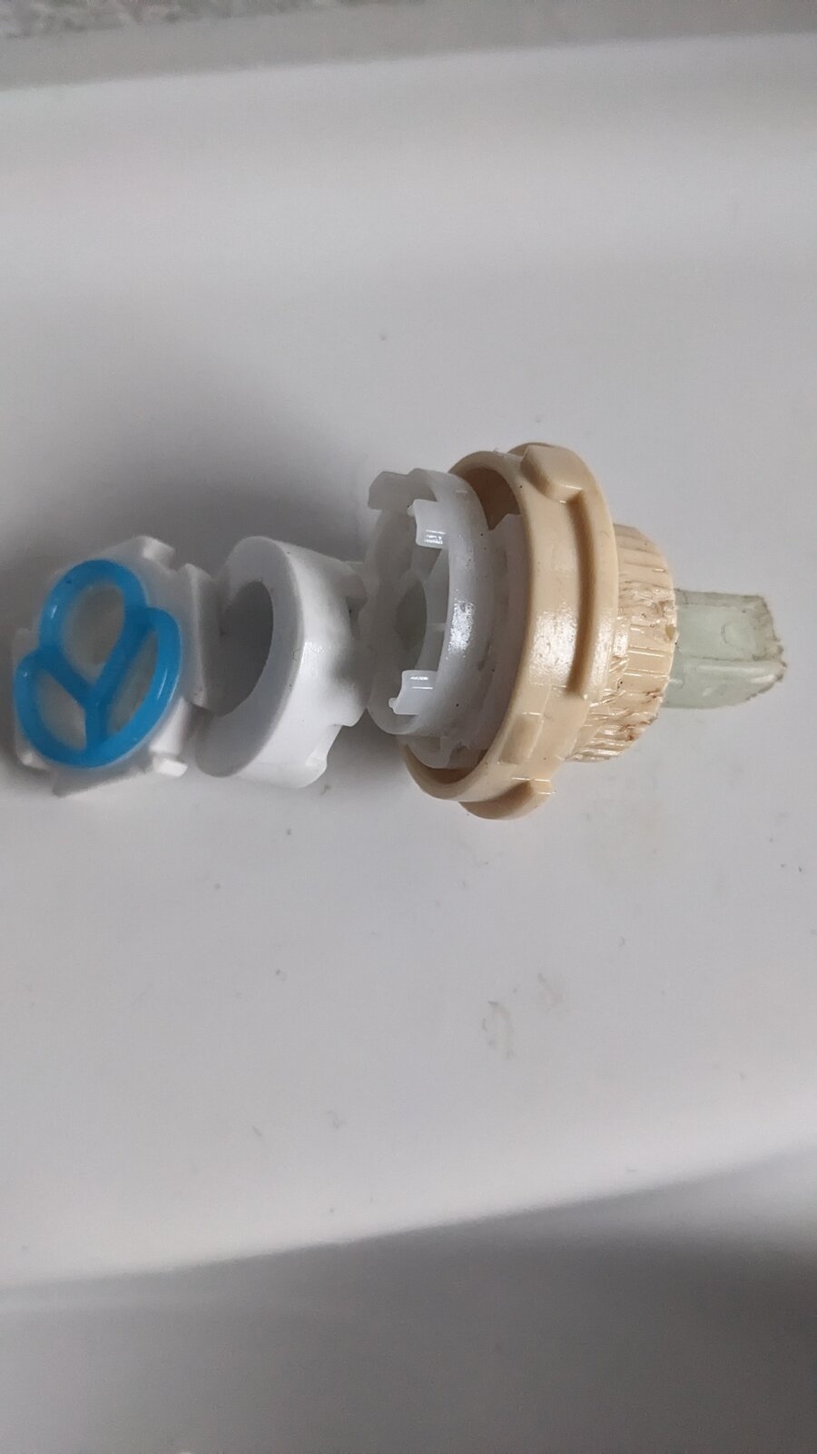

Hi all,
So my tap was leaking from the swivel point under the handle so i thought i would tighten the brass nut that holds the cartridge but it didn't work.
i then thought i should replace the cartridge but it was stuck so i put descaler and yanked it with some pliers it came out BUT it broke the plastic around it also.....its not a normal cartridge that i see online, it one whole peice of the tap.
its got the tap flexis connected to it directly and i cant seem to find any like that. the tap is only about 2 or 3 years old. please see the photos.
any help would be great. thanks

I can't see anything similar. Might be new tap time.
Good news!
After a few days going through depths of google images i found it!!
If anyone else needs it:
This is the only place i could find it. Ordered 2 lol
