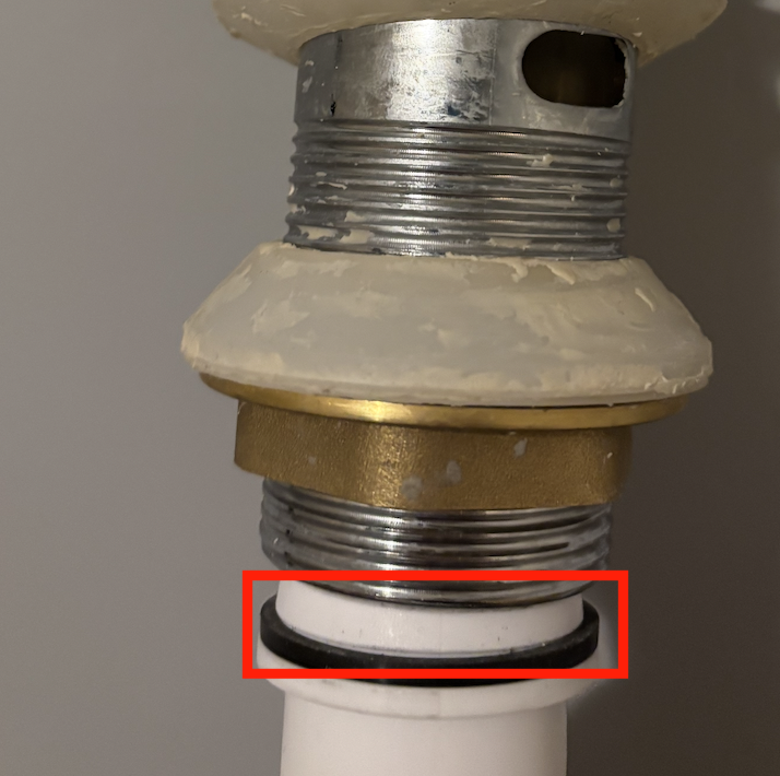

I bought a sink waste with a G1¼″ BSP thread, I cannot figure out how to connect it to my P Trap. The P Trap has a 32mm compression connection, it sort of fits but the threads aren't right.
At first I thought it was that it needed a 40mm connection but this didn't work. I picked out the new waste by measuring the diameter of the old one, 40mm.
It was set up like this by the plumber who installed the bathroom, with a metal connection of the sink waste going into the 32mm P Trap but it did always leak. So maybe I am trying to replicate an incorrect setup?
Do I just need to switch to a bottle trap, get another waste, or is there an adapter?

Yeah I thought it might be the trap that was the issue and bought a new one but I'm having the same problem where it looks like its going to screw on but it pops and comes off. I just can't seem to catch the thread, is it possible its slightly off or do you sometimes have to turn it a lot before it works?

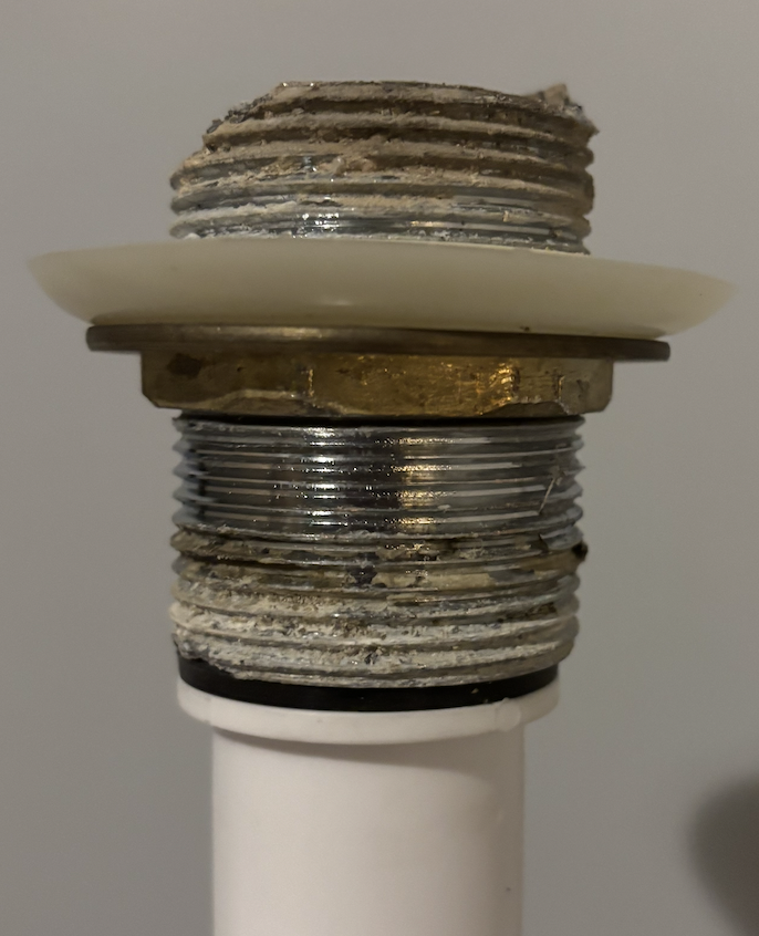

Edit: I took it back out of the sink and compared it to the old one, turns out the measurements must be slightly off. The pipe can sit into the old one, but the new one is slightly too small:

As long as you are not cross threading the plastic nut ,it's highly unlikely that 2 traps are the problem . The trap should screw on easily. You may have a European waste fitting that is not a BSP thread.
Edit ,just seen your added pics ,and it's now obvious that the inner diameter of the waste fitting is too small.
If it's a small difference file some off the trap.
Does the spigot part of the flange actually fitting inside the throat of the waste? I have seen this with some 'universal' waste's before whereby McAlpine traps with that spigot type flange doesn't fit inside the waste, therefore the trap can't tighten up. I've had to trim the plastic to get it to fit into the waste before now.
