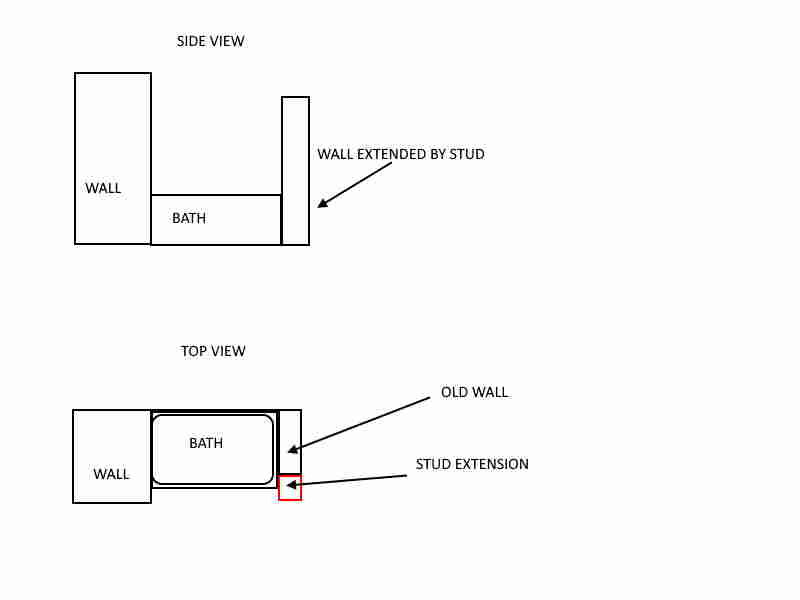

Are there any secrets to tiling the bath in but also making it accessible?
You see it tiled (and I think it looks better than these plastic panels) but surely they have some method to get in? Saying that we will have a bit of a small stud wall extended off the old wall as the wall taken away left just shy of 700mm and extending it slightly gives us more choice of bath type without it looking strange.
I don't know, maybe the tiles could be stuck to a board (or 2) with the boards screwed to the bath frame. Mine's like that without the tiles, just timber, like the Scandi style that was popular in the 1980s! But the screws would have to be accessible. Needs a bit of thought.
I just meant if you leave it to an installer he may well not give any thought to the need for future access.
