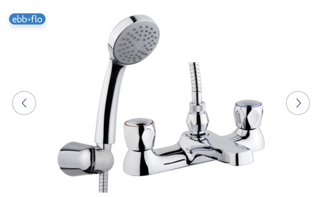

I’ve got one of these and it’s not very clear from the picture but the nozzle is flat with the body of the tap.
This means that even the slightest drip and even when you are turning the tap off, the last bit of water runs along the body and collects at the base of the tap. Some of this then seeps through and leaks under the bath.
Feels like a very bad design. Any thoughts on that please.

Water shouldn’t seep through but it also shouldn’t collect at the base of the tap? Over time, this is probably testing the defense of the rubber tap seal?
I think the issue wasn’t helped by the cartridge which was causing a small drip in the tap. I’ve now replaced both cartridges.
But even now, when you shut the tap off, the last bit of water naturally runs along the body of the tap.

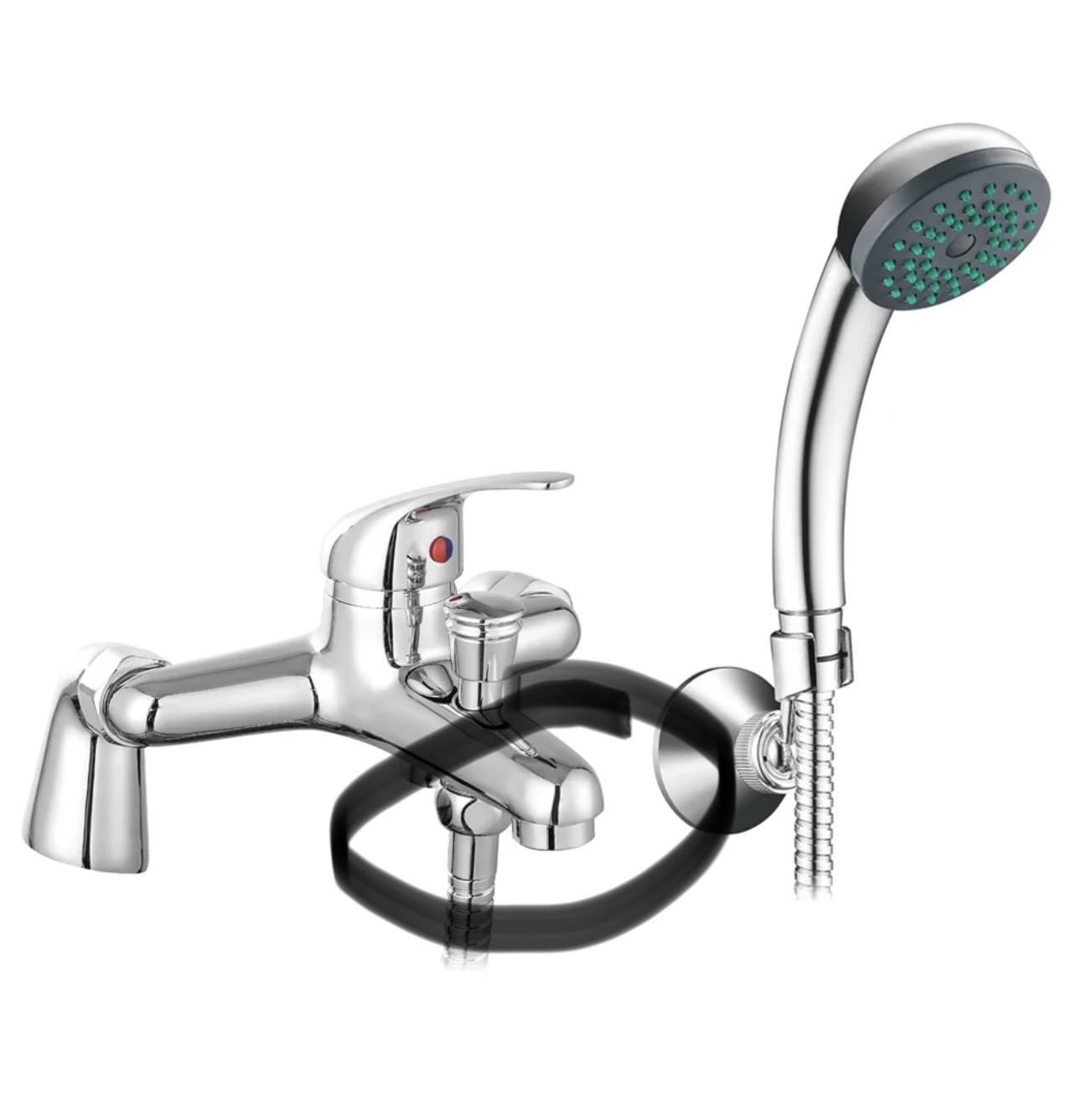

I’m thinking if the tap had a spout pointing out, it would mean that water doesn’t run along the flat body of the tap. Something like this.
Does that make sense?

Cheaper deck mixers are always a challenge, the rubber seal never seems to be thick enough, nor does it seem to cover the entire footprint of the tap. Belt and braces would call for a little film of silicone either side of the seal just to give it a hand. Also important to ensure that the rubber washer and nut underneath cover the hole completely by centering the tap before it gets nipped up.
Ultimately the rubber seal shouldn't have an issue with defending the fit from water running past it, especially given it's a shower mixer.

Is there anything that can be fitted in to the tap to give it an extended nozzle?
Also, should I apply some silicone around the tap?
Search for "screw in tap nozzle".
I don't know if they all have the same thread. Most are aerators or adaptors for hose pipes; I guess you want a plain one? Hmm.
