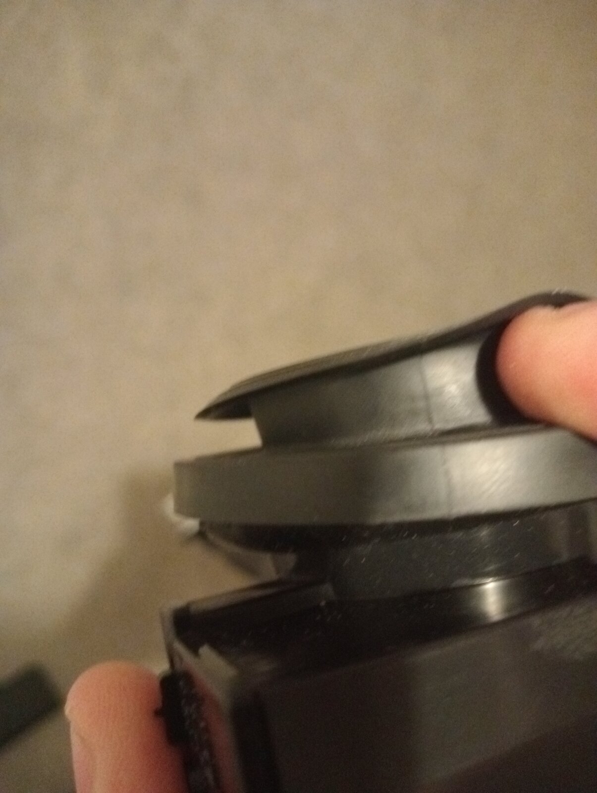

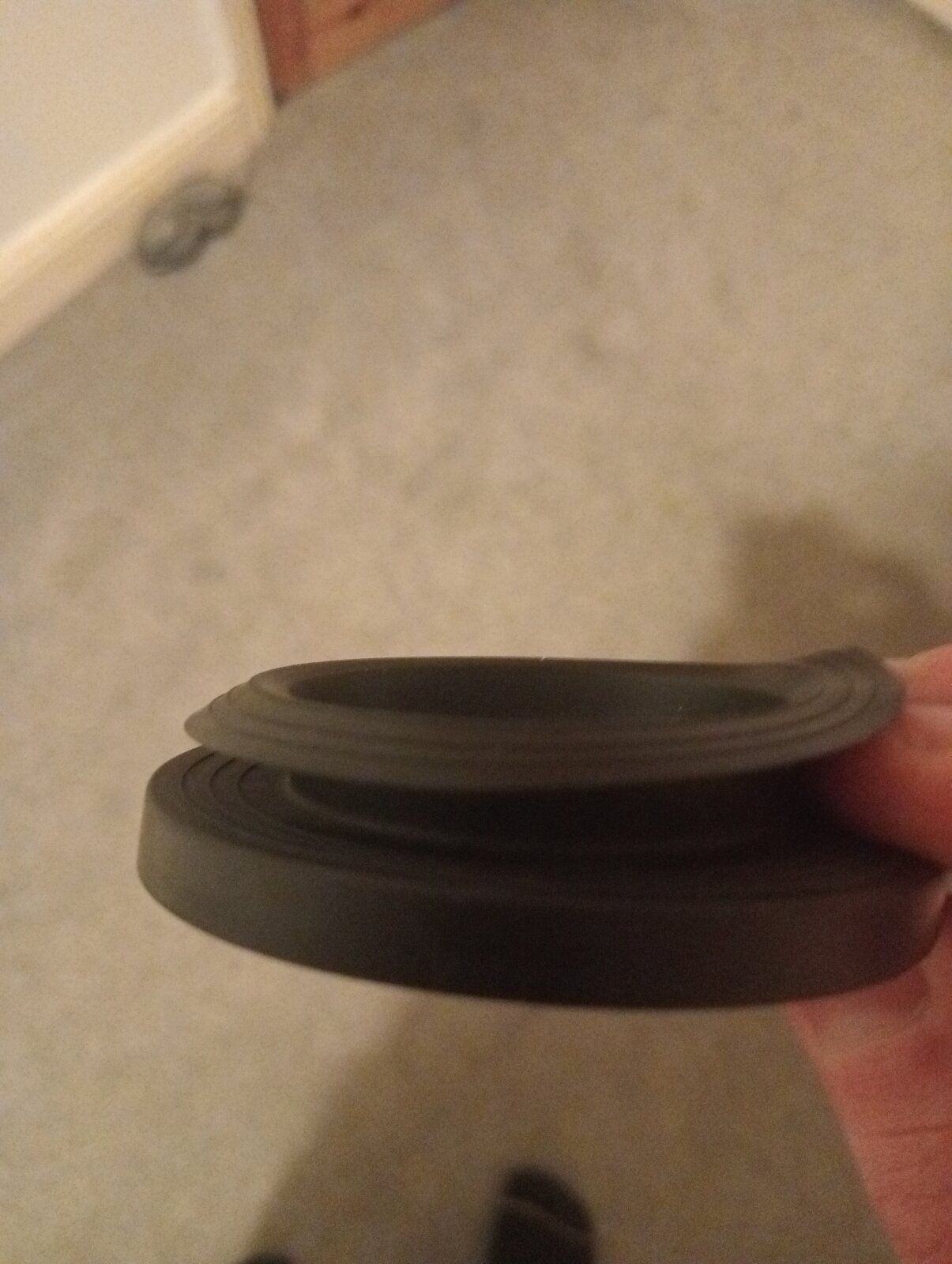

Are the bath wastes with the rubber that in an old in one top/bottom rubber ok? Also were would you add silicone to help the seal.

Yeah, they're a different type of seal, just means it's a one piece top and bottom now.
Like every bath waste fitting, if the bottom of the bath has been finished nice and flat and clean then no real need for anything. If, like a lot of acrylic baths these days, where the surface underneath hasn't been flattened and squared off properly, then always good to add a little silicone just to take up any of the imperfections.
Any time silicone is used then don't overtighten the main nut, as the silicone can act as a lubricant and overtightening can squeeze the seal out.
Usually throw top washer and use silicone. Not used one of these one piece washers before
The top washer don't really do anything anyway apart from smooth the gap between the flange of the waste and the waste recess on the bath and makes the waste fit better. The wet seal is all done by the main washer underneath.
Don't really need anything there TBH but I just use the gap washer as it makes it easier for the next guy to remove the waste.

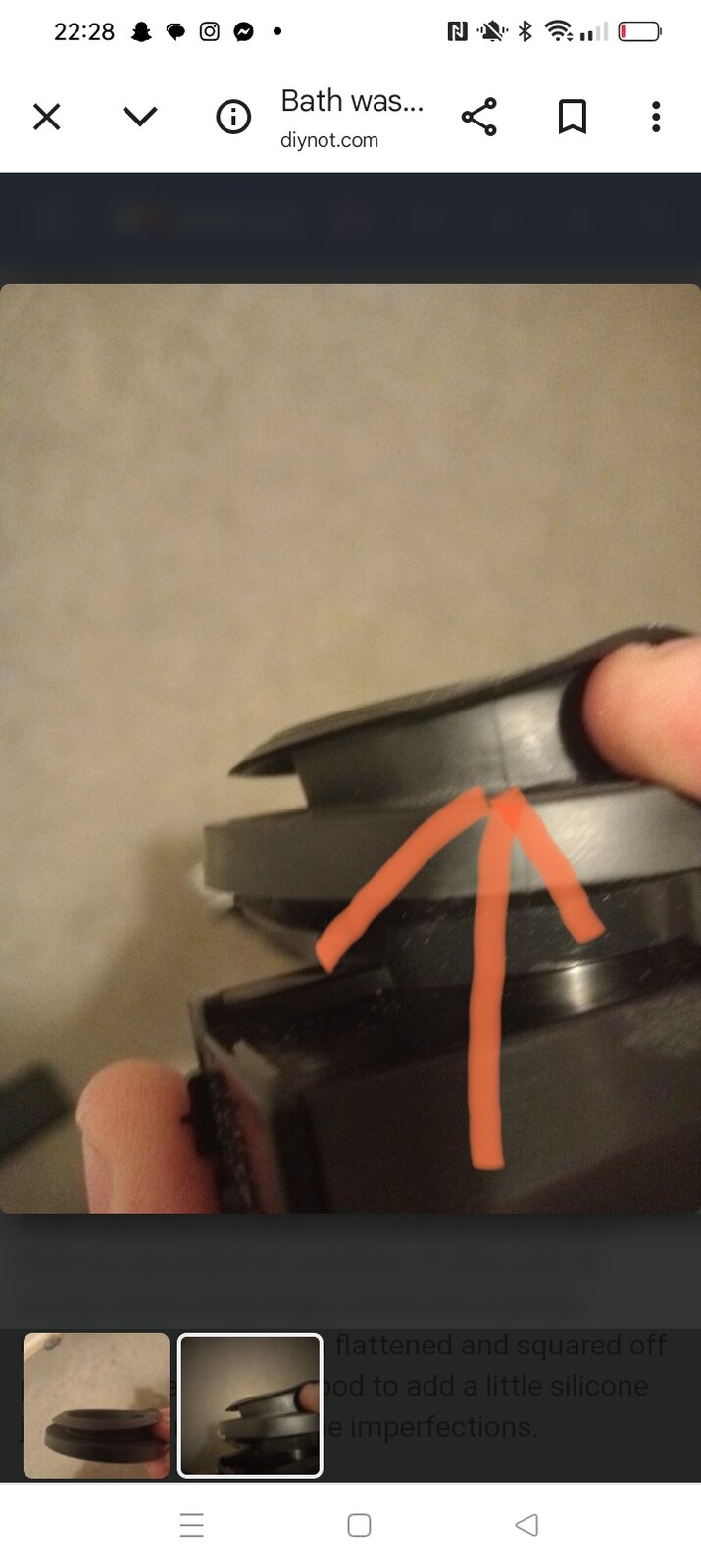

Maybe just a bead of silicone here then?
