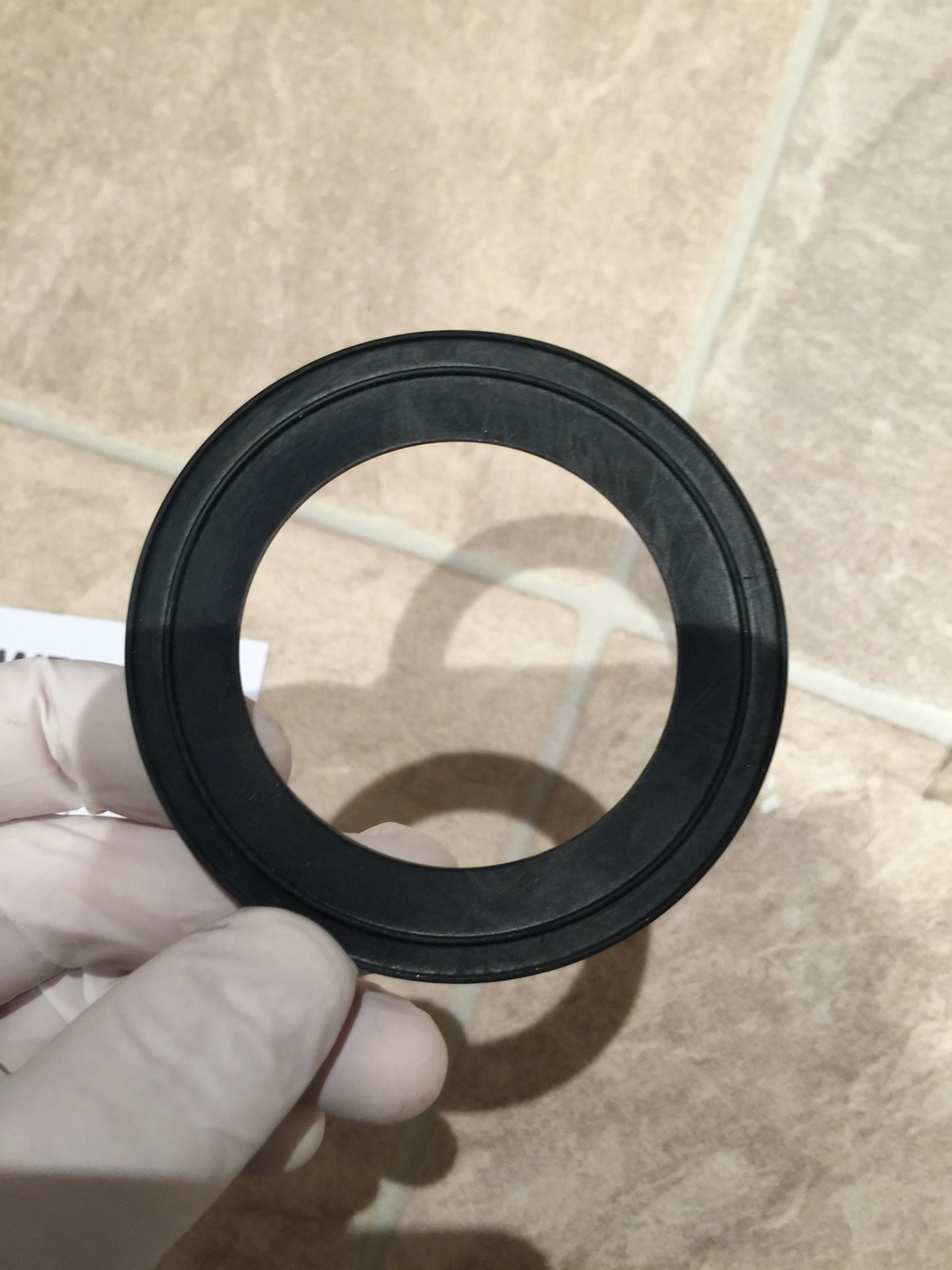

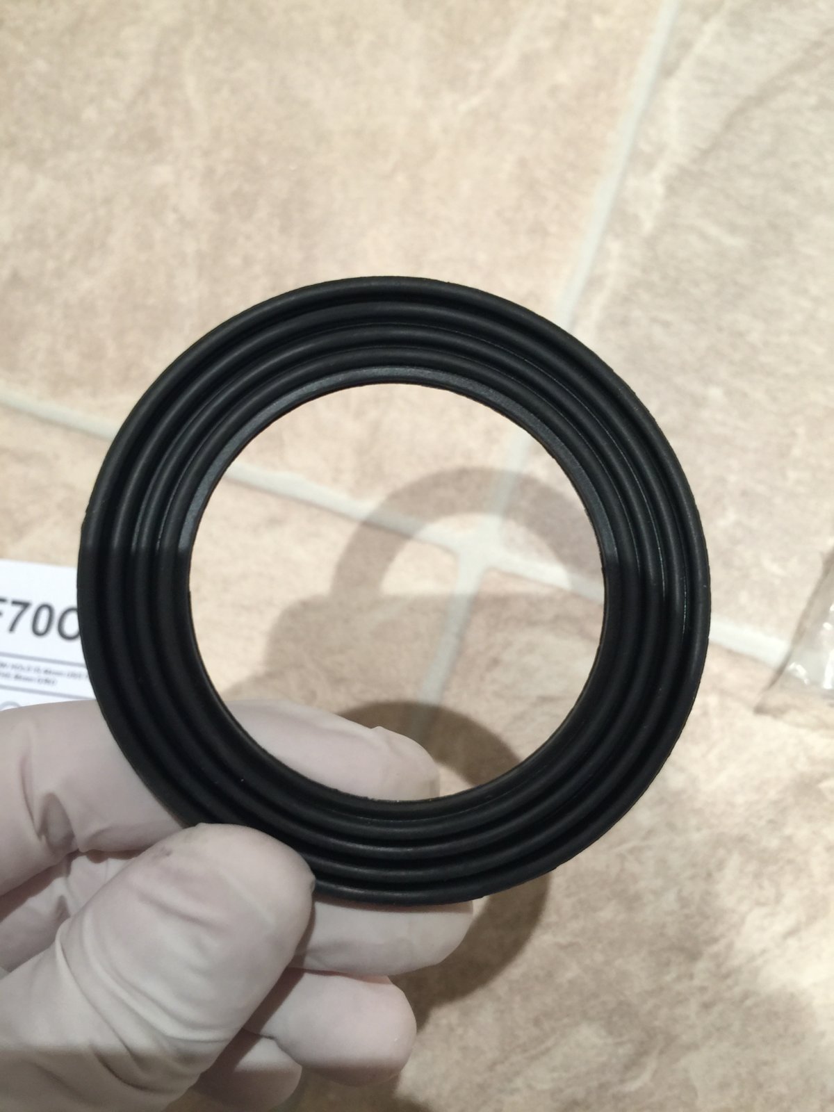

I bought a Mcalpine bath waste and it comes with a rubber seal. One side has two very thin ridges where the other one has 4 thick ridges on it. Which way goes to the bath and which one to the waste?
It feels more natural the thick ridges on the waste face but what do you usually do?

Thats what I do, but as Rob says, don’t overtighten......you don’t want the washer to be squeezed out of place.
John :)
I only put a small bead around the centre ridge, just enough for it to spread out when it's nipped up and it doesn't side as much I find. Invariably the underside of the bath wastes (acrylic especially) aren't entirely flat and a little silicone just fills in the gaps, some manufacturers do square the base of the waste, others don't.
As John says it's a belt 'n' braces.
Water can also creep down the bath-waste threads so you need to form a seal between the waste flange and the bath interior surface (to prevent water getting to the threads). Even if a top-side seal is provided, a ring of silicone where the threads meet the flange might be prudent.
