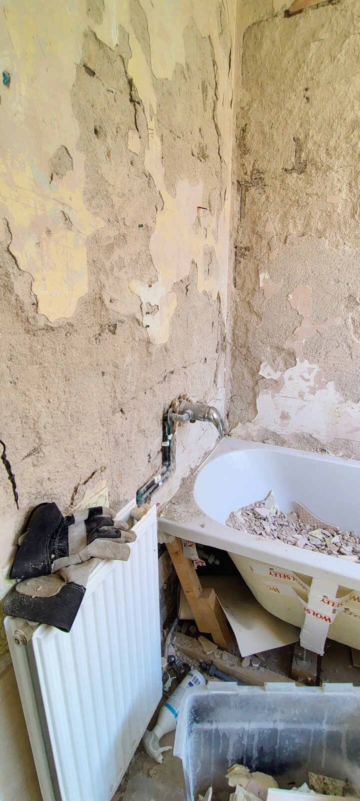

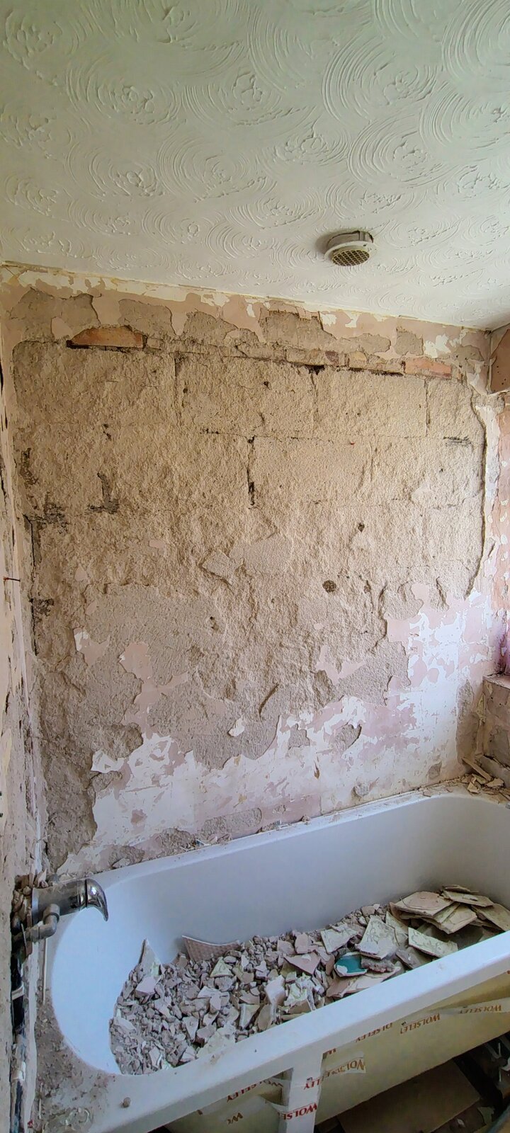

Hi
Just a diy dad here. Renovating bathroom.
Taken old tiles off and plaster all come off. 1962 house
Some very deep to block work
Will be using tile backerboards all round.
Can i have advice on what to do with wall underneeth. Like Do I need to remove all old debris to block work or can I use some hardwall plaster to get back straight before tile backer boarding?
Thanks in advance
You need a firm surface so scrape off anything that is loose or flaking with a scraper and wire brush and give it a coat of PVA and then you can give it a coat of Bonding to level it up ready for the backer boards.
Is sbr OK? Conscious it's the bathroom.
Don't suppose you can reccomend a decent bonding coat for me to use?
