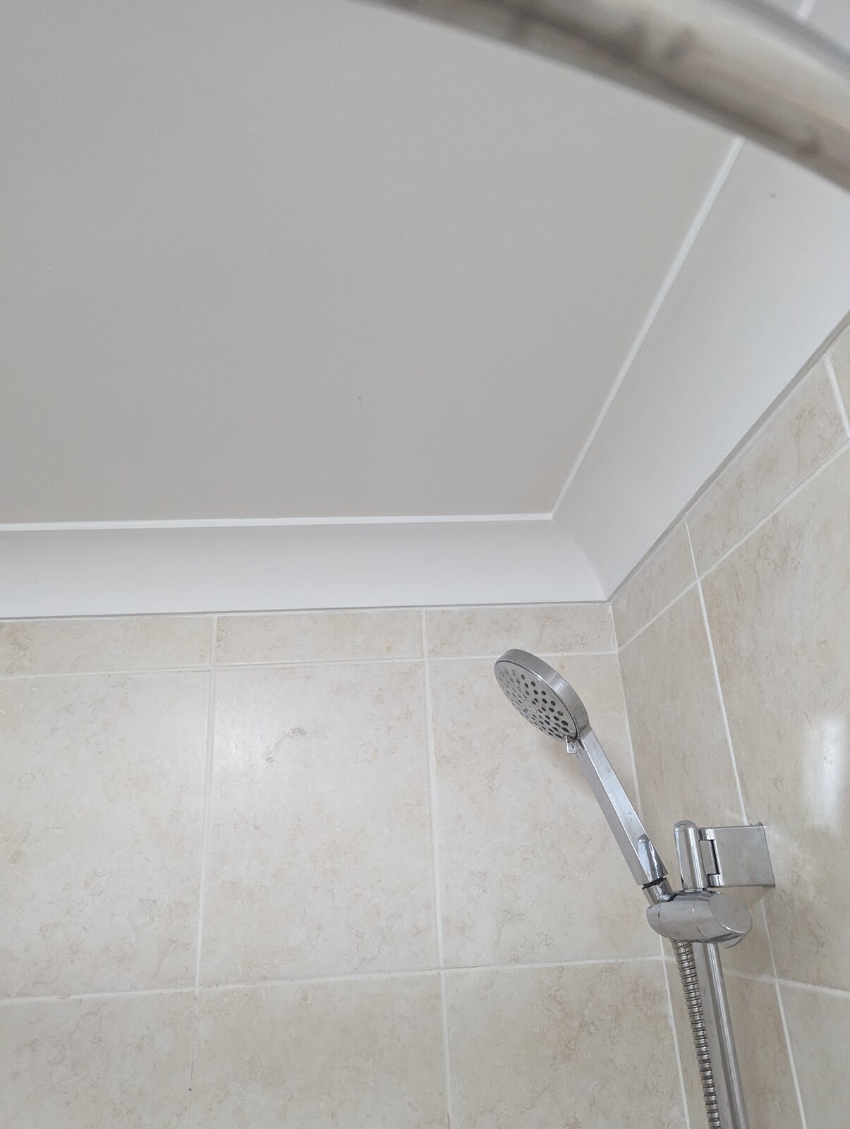

My bathroom ceiling in picture. Not even bathroom paint just regular emulsion and last painted in 2008 Ish. I don't get any condensation on the ceiling because of the insulation above.
So chances are that fitter is partially right about mould occurring, he just did not have a technical understanding why i.e. the space above may not adequately insulated .... assuming of course that the bathroom itself has good ventilation.

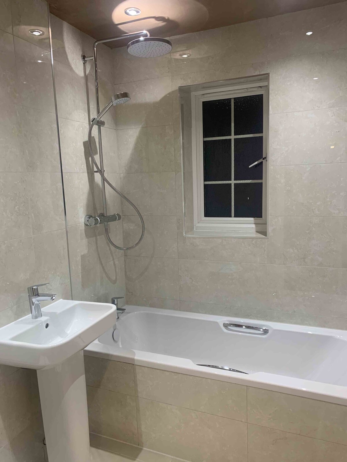

He has now skimmed, though I am now left to finish the rest myself that is sand and paint. Not pleased about that considering he should have started the bathroom job with skimming so that its dry by the time he finishes tiling since I had already taken everything out and replaced the walls myself.
We use the bathroom for showers, so how can be make sure it stays dry enough for sanding and painting? should I try to put some sort of big covering above the shower area to divert steam away from the whole room? ideas welcomed please. Not sure we want to stay in a hotel again just to have a shower!
Other thing I am not pleased with are 2 lightings he placed above bath area. I assumed he will put them outside of that zone though rated IP65 but he had cut the holes by the time I got back home
