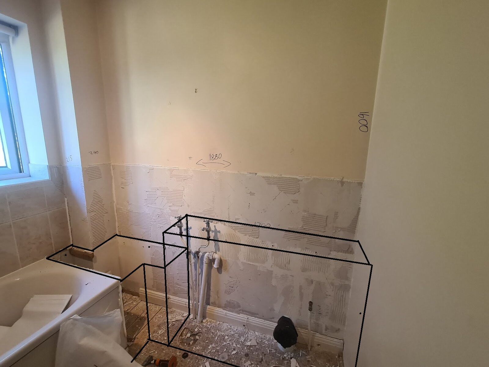

I'm replacing my bathroom and have chosen to swap out the toilet and basin for some units like this (made by ideal standard).
19728-50067

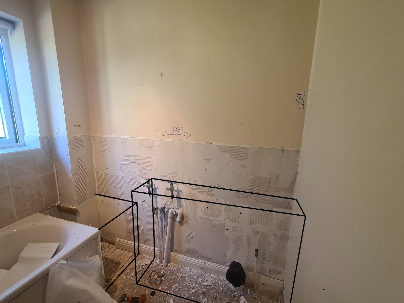

This is my bathroom.
The bath was previously boxed in to the back wall as illustrated. I've also drawn in the new toilet and sink unit.
There is a 190mm gap between the bath and new units.
Would it make sense to extend the box out like this?
Yes. When I install IPS units (integrated panels) they are always specified to fit between walls with no gaps (we cut the panels to fit the frames afterwards)
I would always avoid any boxing inline or below bath level, asking for trouble ( leak/ splash damage).
Tiled floor or shower does not move, a bath usually does breaking any horizontal joints.
A slip in the bath would flood the lower area.
I agree, build the shelf at the end higher than the bath, a meaningful amount you can practically tile say 50mm. Ensure your boxing out is just a few mm away from the end of the bath so that your tiles overlap to let you fill the gap with sealant.

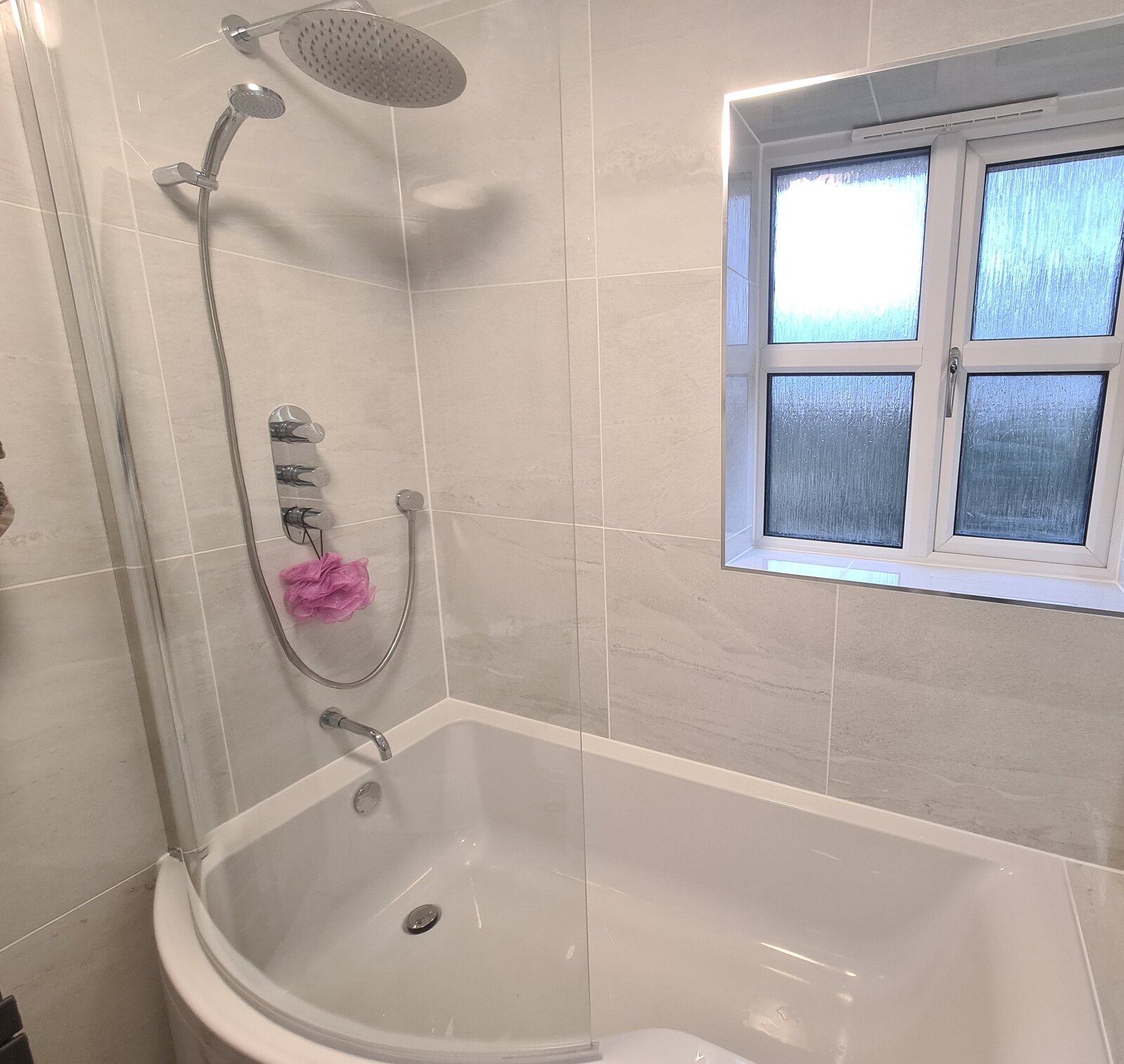

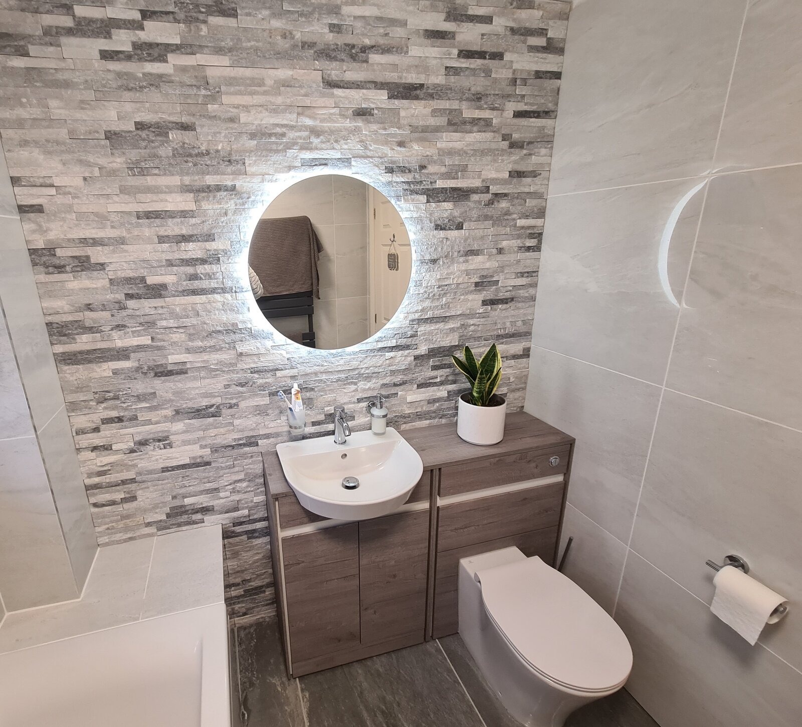

I thought I'd come back and post a 'completed' picture.
I 'm afraid I went against the advice and built the ledge at bath level out of 12mm hardiebacker and sealed everything with a Mapei Shower kit.
The last bath was installed like this and lasted 20 years, so hopefully this will.
(this was my first time fitting a bathroom and tiling)
