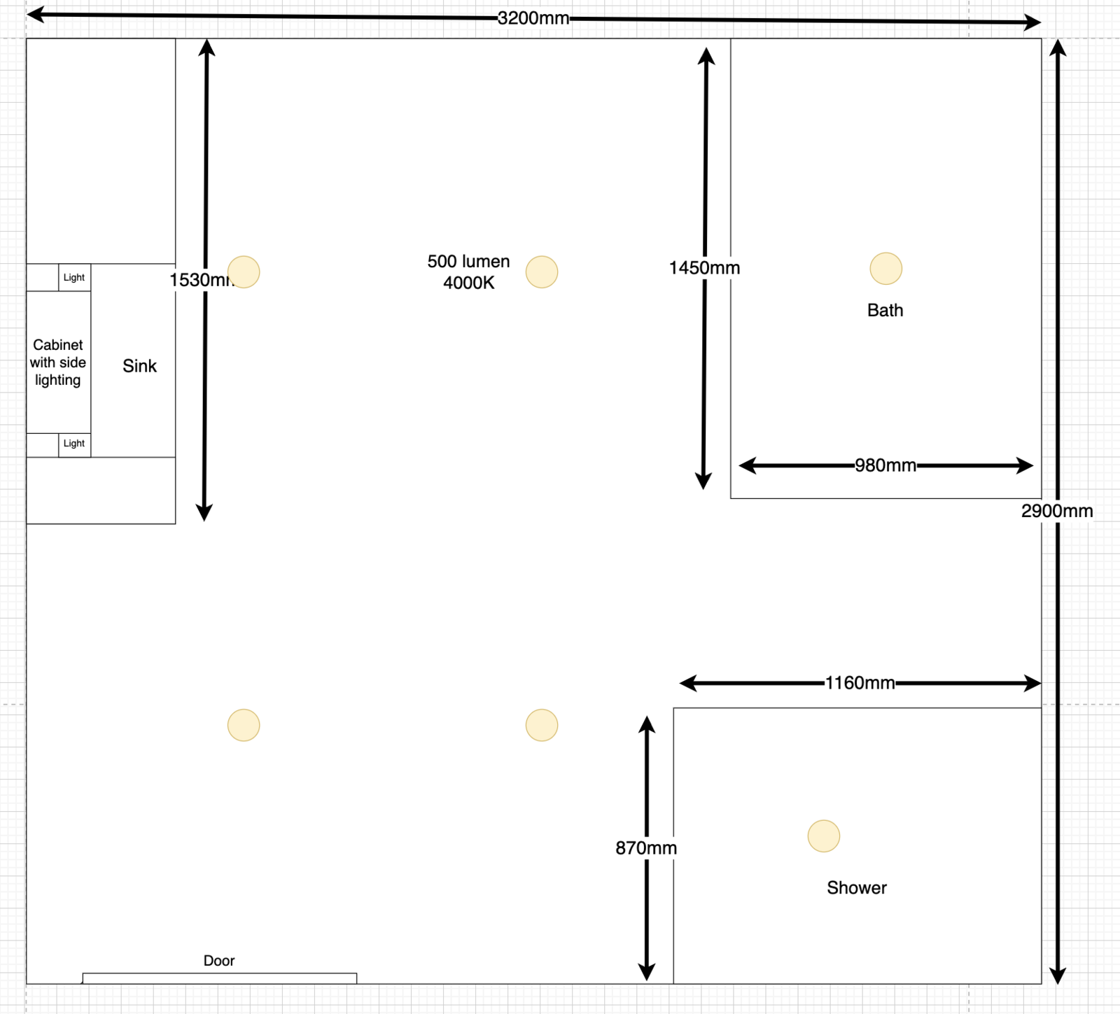

I'm looking for some advice on bathroom downlight placement.
Thinking of placing 6 x 500 lumen LED downlights as below. Trying to find a good balance between even spacing in the ceiling and lighting appropriate areas of the room. I'm not entirely sure about having a downlight directly above the bath. And for the shower I've moved the downlight out of alignment with the bath light to avoid being too close to the shower head.
Can you suggest any improvements?
Have one directly above the basin to avoid shadowing. But consider a single central light, it will give far better coverage than individual funnels of light.
Blup
Have you checked where the joists are?
Tbh I think 6 x 500 lumen lights using 4000k output will be far too bright unless you are planning very dark tiles/ walls
And where is the fan?
