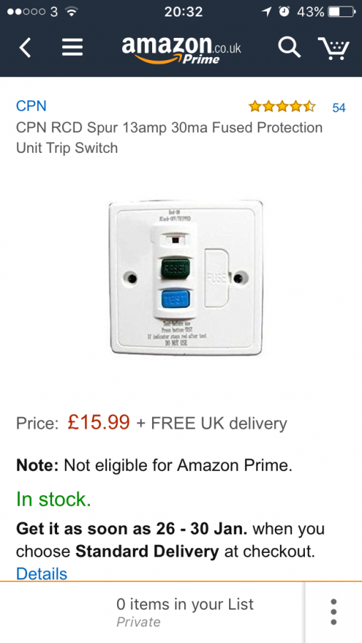

You have an RCD in your attic, bit inconvenient! Can you post a picture of it or describe the make is it an FCU RCD

Thanks for the reply.
Everything was working fine up until recently when one day it was working then next morning it wasn't (2 months after installation)?
Strangely the fuse hasn't blown - but the RCD is stuck on red. When a fuse is put in it trips instantly! I have had to remove the fuse due to this.
It's just by the hatch in the attic and the light in the attic is working so not too bad. The RCD is this...
Are CPN susceptible to fault?
Could it be a simple case of replacing RCD?
What would cause it to fail?
Is there a better recommended brand?
I would like this to be the answer to my problem :)
Try switching the lights off at the switch and re-setting the rcd. If it does not re-set it maybe the mirror. As has already been said, it could be damaged cabling, i.e. melted to a down lighter.Does the mirror have a de-mister heater ?

You may have a Neutral to Earth fault which is a bugger to trace as switching off the pull cord will not disconnect the N to the lights. If you disconnect the outgoing side of the RCD at least that will determine if it's the RCD that's faulty if it re-sets with no load connected.
