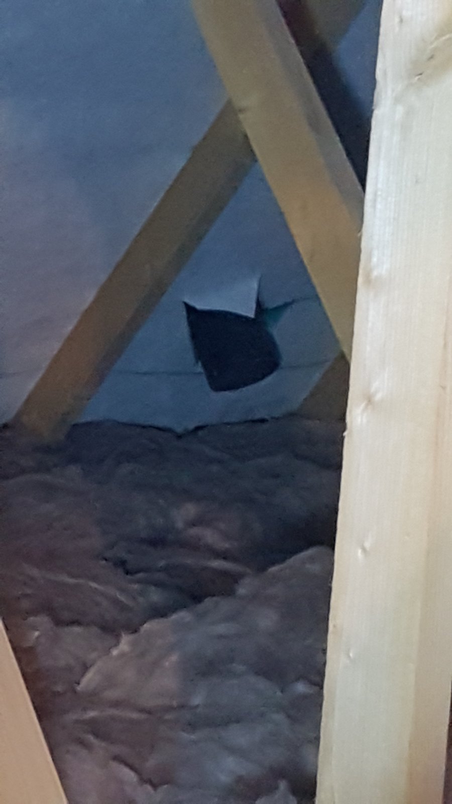

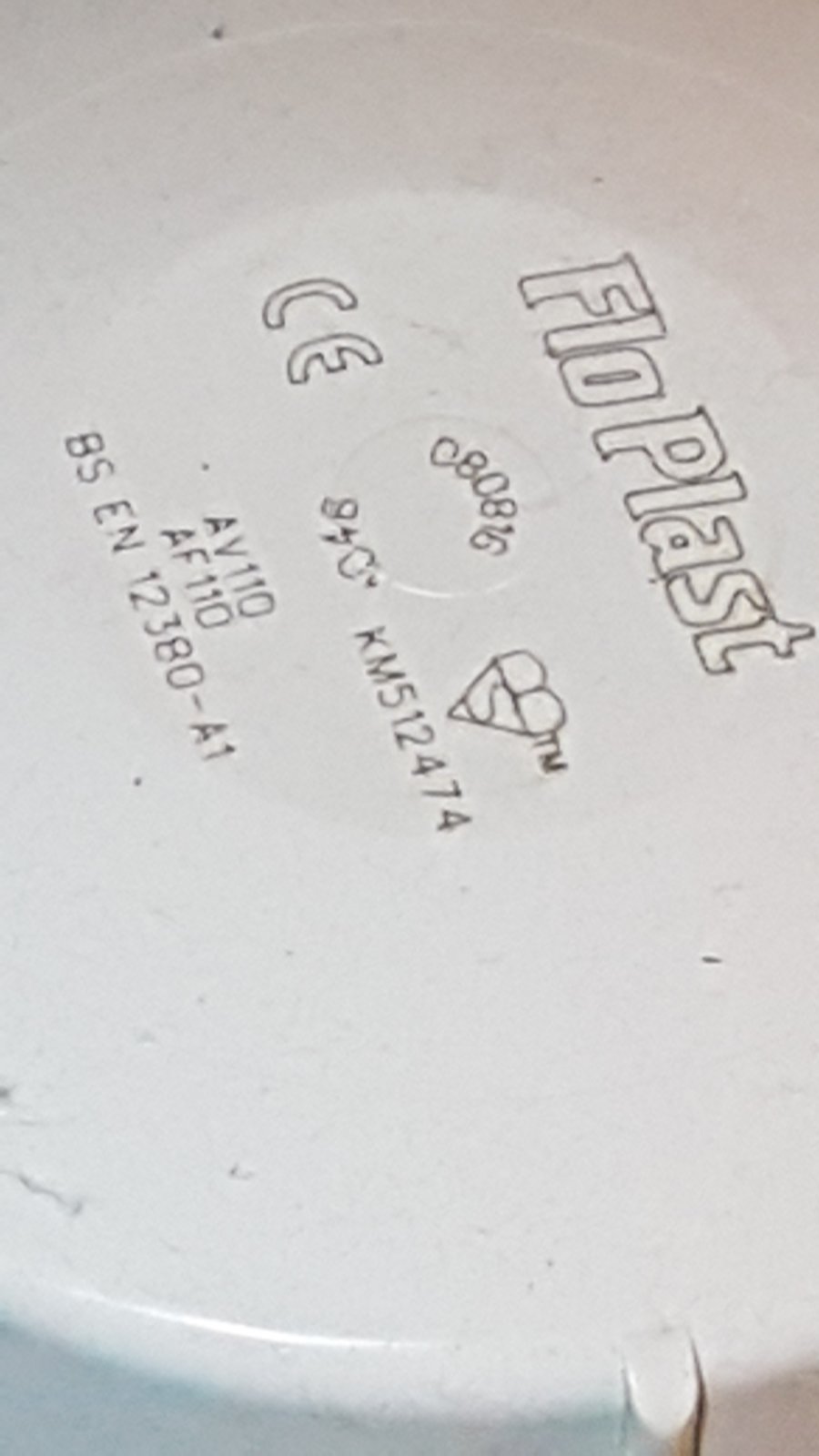

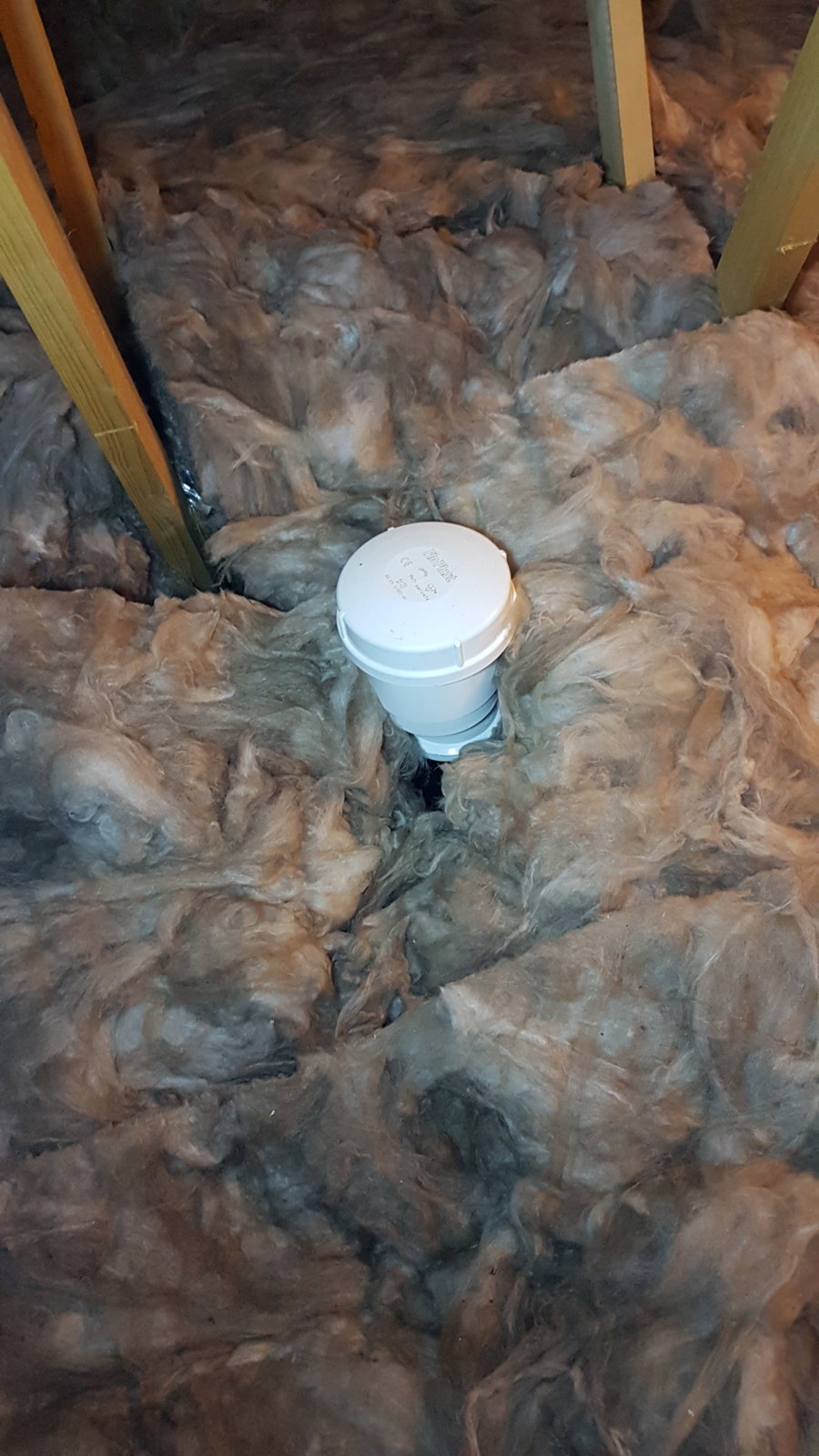

Hi - my bathroom and ensuite toilets do not have a waste pipe vent, there is a hole in the roof where the vent should be.
Instead there is this filter thing connected to the main bathroom toilet.
The ensuite toilet waste pipe has no ventilation connected to it.
My wife says the ensuite room smells, could this be the reason.
Any advice would be welcome .
Thanks.

Does the en suite WC waste pipe not connect to the same soil stack ?
The vent in the roof may be for an extractor fan ,never fitted.
The Floplast Av is a standard way to vent a stack internally. Allowing air In ,but keeping smells out.
What else is in the en suite ,shower ,basin etc? The water traps on these may be the source of the smell ,or the WC pan connector to waste pipe not sealing fully.
Thanks for replying - I'm not sure to be honest if the ensuite and bathroom toilet waste pipe is connected, but I doubt it. It's a newly built property and they couldn't show me anywhere in the loft where it was connected.
The house builder sent a technician round who assured me it wasn't a problem it not being connected as the downstairs toilet wasn't connected either.
I found the extraction pipe vents and they go through the loft wall and seperate to this non-connected "roof" pipe.

It's tricky but you need to ascertain if the ensuite smells of drains or damp. Is it a windowless room and does it have decent ventilation/extraction? It could be that a shower tray or enclosure is not sealed properly and water is getting behind tiles etc. There may also be an anti vac trap on the basin which is stuck open. Was the soil stack tested during construction?
