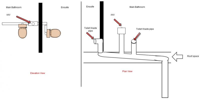

Here is the general layout of the waste drain in the ensuite and adjacent main bathroom
Click here if above does not work
Just to summarise....waste smell coming from toilet pan only (honest!)...no blockages of waste pipes...adjacent bathroom does not smell....no leaks or mould....AAV seems to be working when either toilet is flushed.....toilet traps seem ok
Here's a long shot......has anyone got any ideas on what I can do next (apart from selling the house) :confused: Happy to clarify anything.

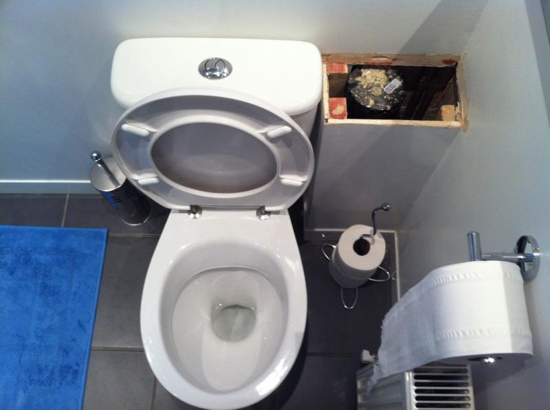

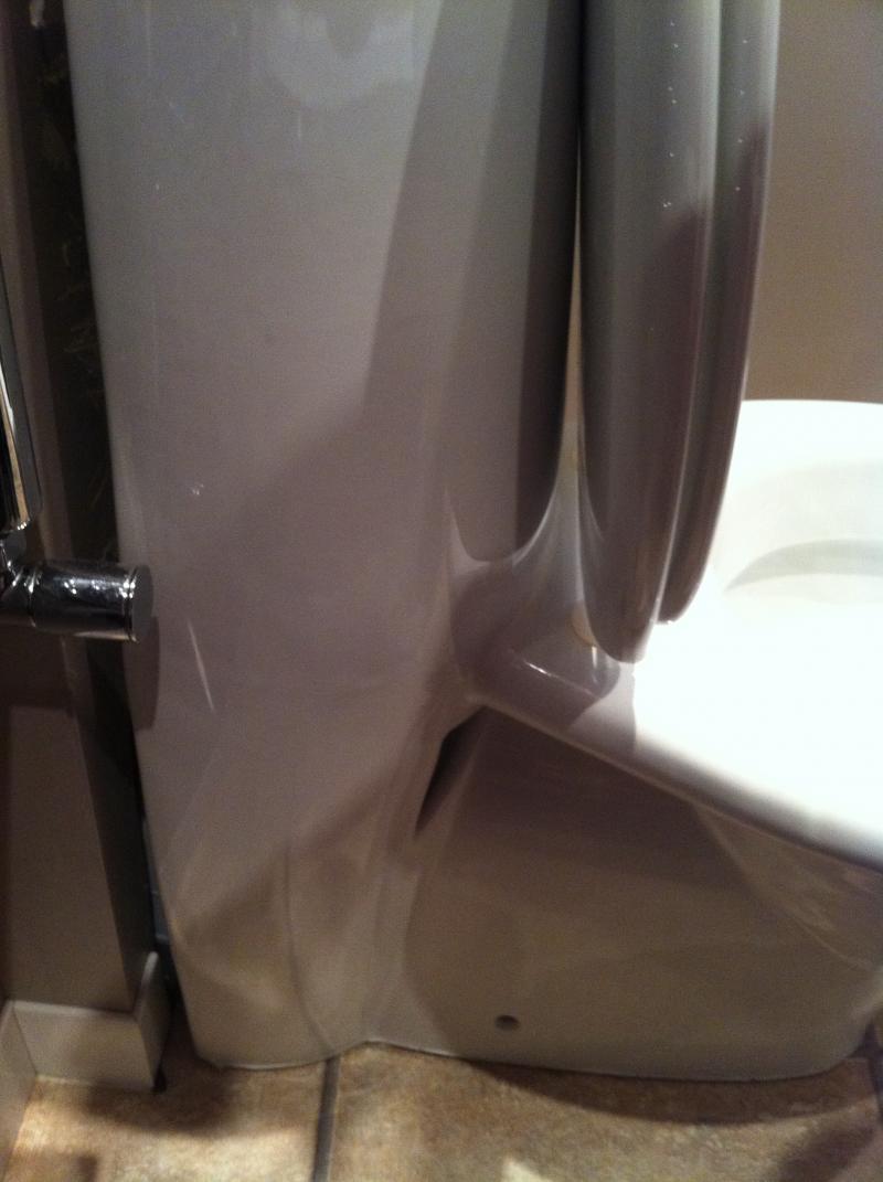

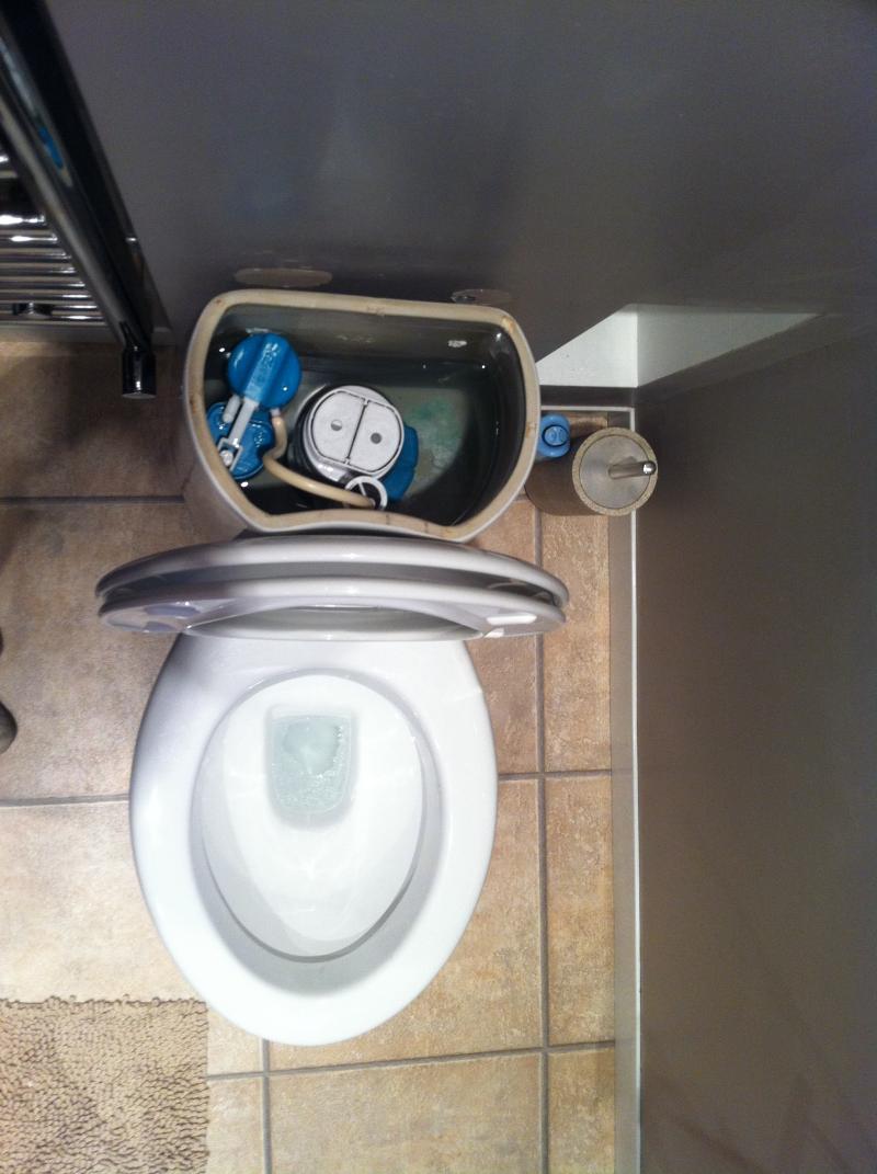

Hope these make it clearer
Main Bathroom toilet and AAV
Ensuite Bathroom toilet (above)
Ensuite toilet cistern
Ensuite toilet (side)
It`s the aav - if the pipe was vented to open air it would work :idea:
This was my next thought but I want to be sure that is it before going putting a whole in my roof. As we don't use the main bathroom very often, I wonder could I test the idea by venting into the bathroom with the window open (window is right beside the loo and AAV). I know it won't be the same as venting to the outside but could it work??
