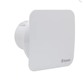

I will be replacing the current ceiling mounted bathroom fan soon as it is the original fitted by the builder but it sdoesn't really pull enough air through having about a 4m run to the outside world.
As I will be using an in-line fan in the loft I would like to use a square grill in the ceiling but most seem to be round. Would anyone in the know be able suggest a supplier/ maker of something like this (but this is a complete fan). If cheap enough I could remove the motor assembly to achive what I am looking for
