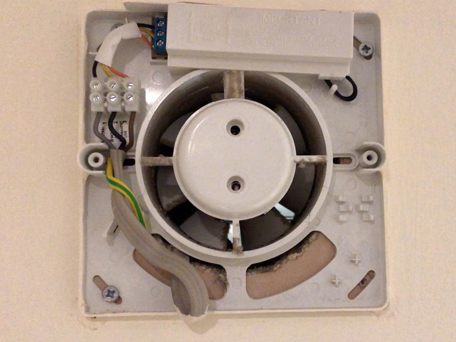

Bathroom extractor fan buzzes but blades don't turn.
Does anyone know if this is more than likely a problem to do with the motor?
Its the motor that is buzzing.
Can you spin the fan blade?
It could be a jammed blade, or the motor spinning but not attached to the blade.
I've done a quick video to illustrate the problem. Whilst I was doing it, the fan started working... but very noisily!
Any ideas?
how old is it? What make? post a pic
quite likely clogged with dirt.
It's a Manrose fan. No idea how old though as I've just moved into the property.
it can be cleand, but best bet is to get a new, better one, with ball-bearing motor for low noise and more power.
I can't see the vid. How many wires can you see connected to it, and what colours are they? (it might have a timer)
JohnD.. Can you see this photo?

yes, yours is a timer fan. Not a prob, it cost a bit extra but will run-on after you turn out the bathroom light.

Thanks. So I need a completely new system? It’s not something I’d want to install myself tho.
Hardly a "system"
the fan is a replaceable device, it fixes to the wall with 2-4 screws and has a spigot that fits to the existing duct. The existing wires are connected to the terminals in the new fan.
An electrician can easily fit a new one for you. as it's in a bathroom you'd best use a qualified one who's a member of a Competent Person Scheme such as http://www.niceic.com/ (there are several)
