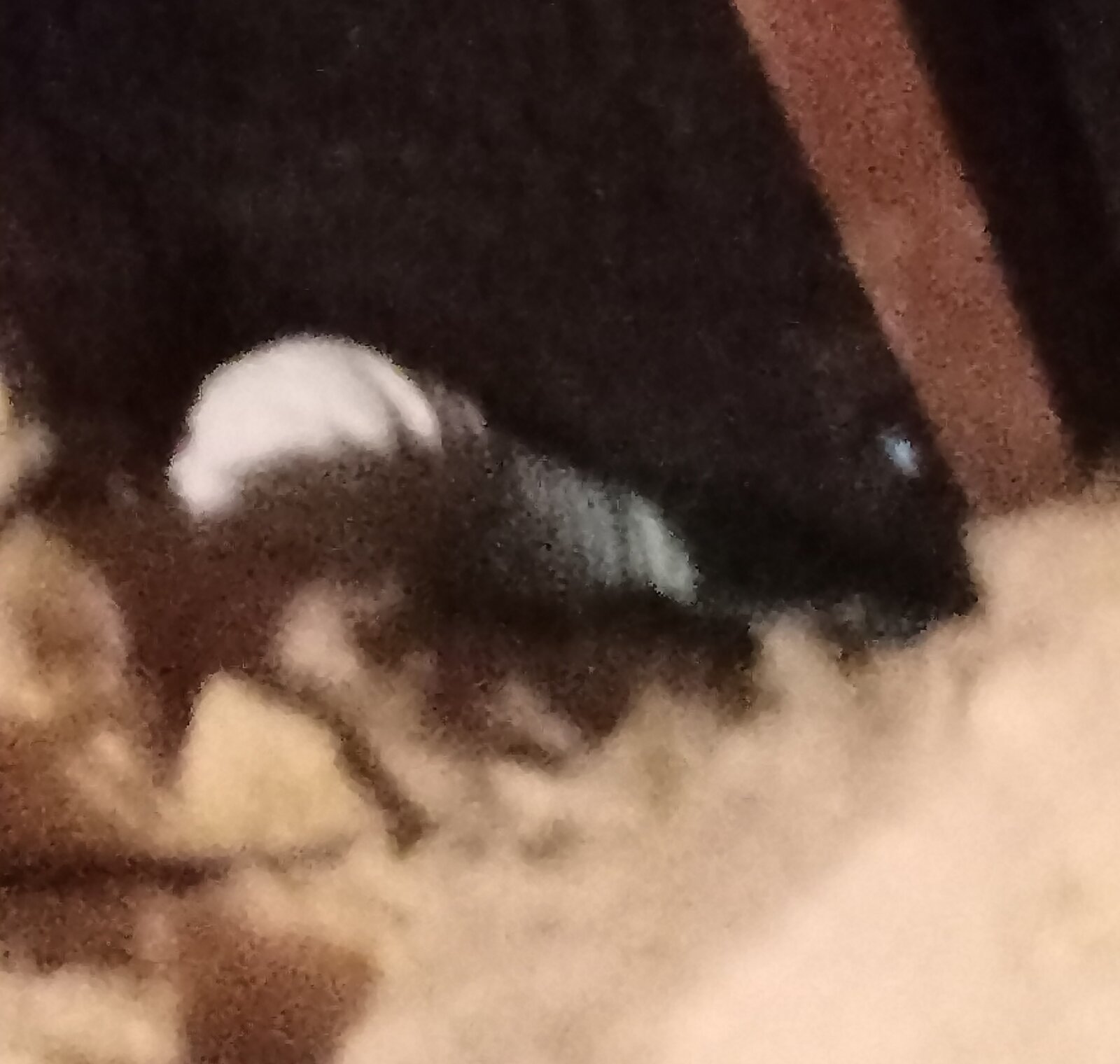

Do you have the flexible ducting, made of convoluted hose?
It is very prone to trapping condensation (and fluff)
firstly between the ridges, and then it tends to hang in loops with a pool at the bottom of each loop.
and it drips out of joints

Yes, the ducting in ridged like you describe. I think that could be the problem.

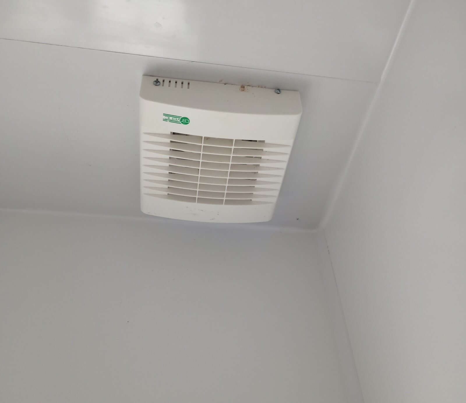

As for pics, there isn't really much to see - just an extractor fan in the shower ceiling.
Many thanks!

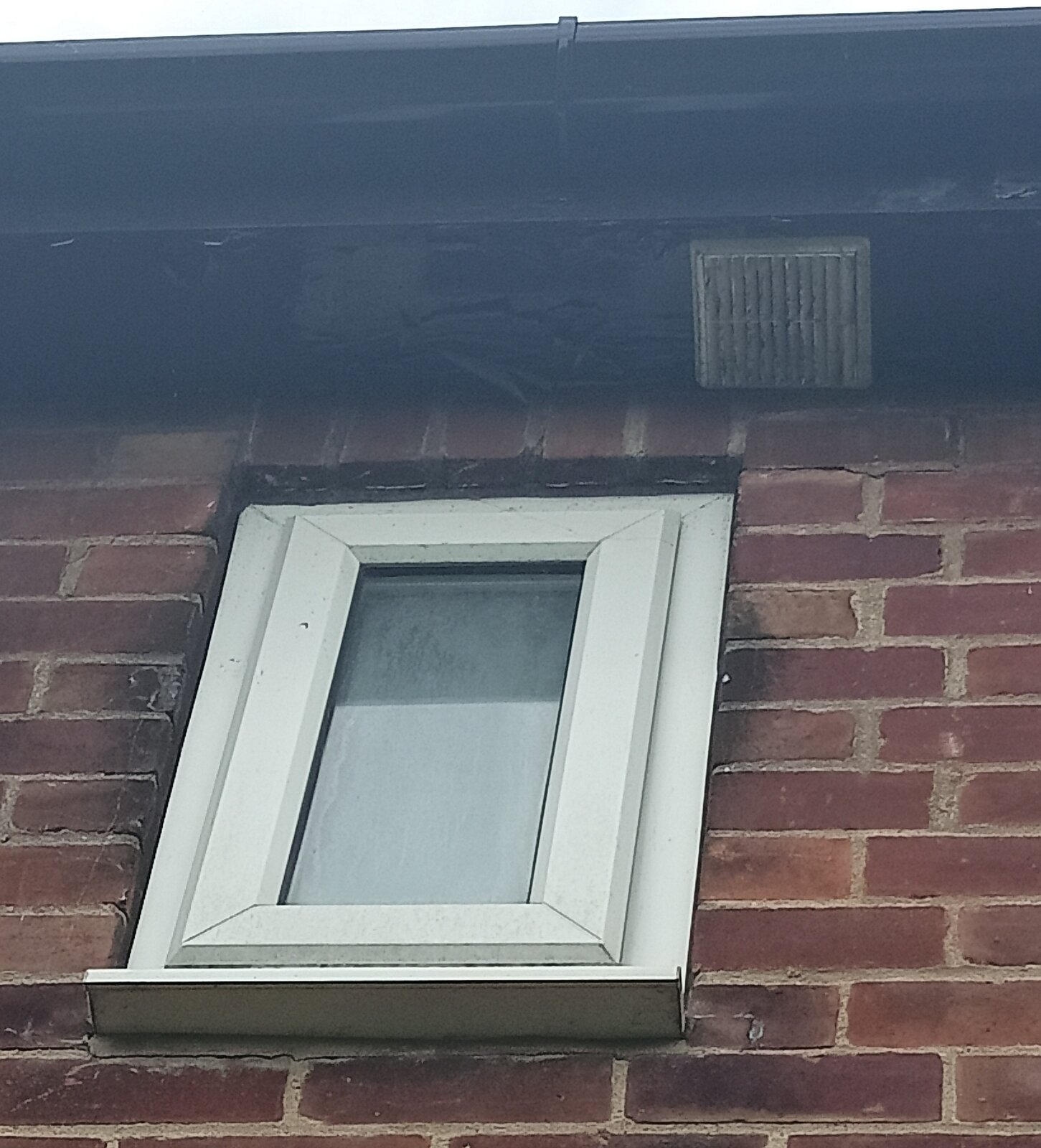

Okay... Here are three images: shower, loft, and outside. The pic from the loft is poor, but you can see the ridged ducting looping out under the roof. It's normally buried under loft insulation.

ok, so it emerges through the eaves grille that is blocked with fluff and cobwebs. Perhaps your windowcleaner could reach it?
I can't really see the duct, but I bet you could run a straight pieces, with an elbow to go through the eaves, having a slight fall towards the exit.
The fan looks like a typical 100mm 80 cu.m/hr extractor

I think your old fan is one of these, noise level 41db
the S&P is about three times the power, and 19 - 24db
plus it will be in the loft, with a padded board, and fibreglass insulation between the board and the ceiling.
