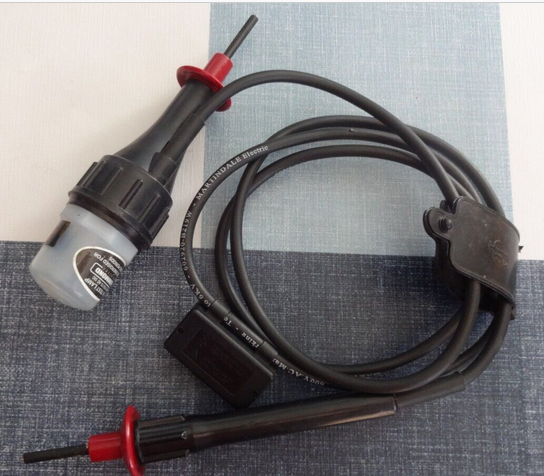

What does your two probe voltage tester tell you?
Was getting 240v between grey and black with switch on. 240v between grey and brown all the time.?

It does seem with @nescafe37 grey is neutral, brown permanent line, and black switched line, but I would wonder about if a true neutral, or being grounded by something. These 1658494221558.png were so good to test with as they actually used some power, but you need to find the other end of the triple and earth and see what it is connected to.
