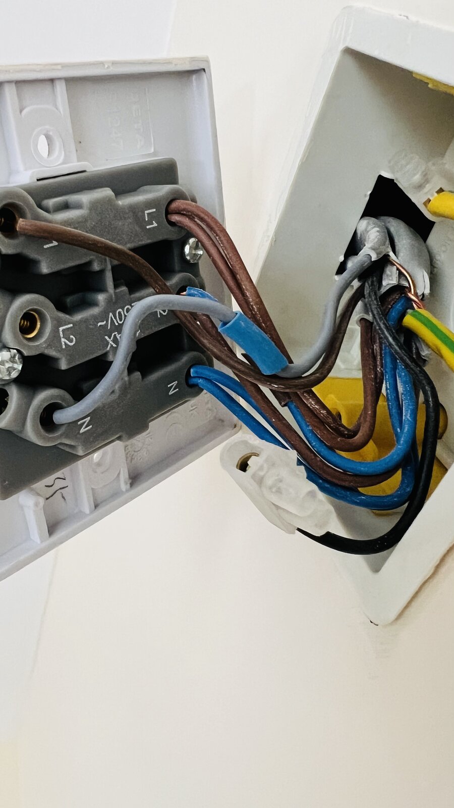

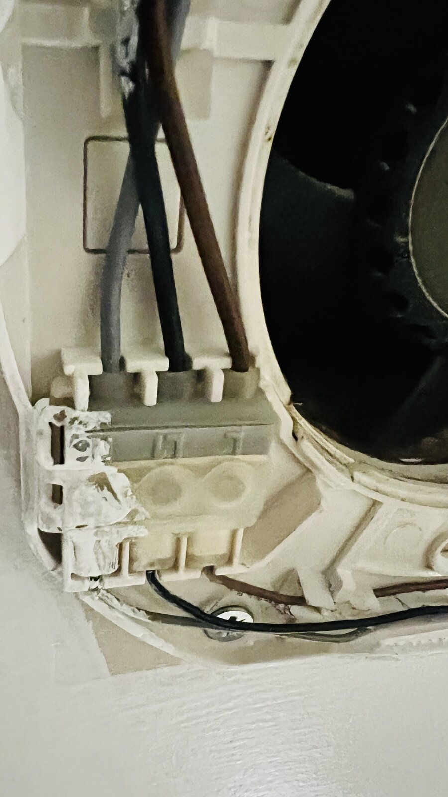

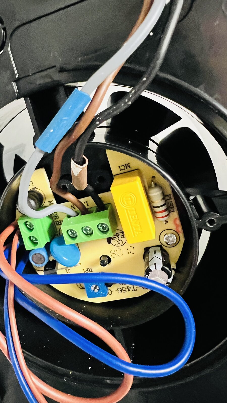

I purchased a new fan for my bathroom. The old fan is permanently on even when light is off so I purchased a new one with a timer the wiring on old on is brown, black with brown sleeve grey with blue sleeve and Earth. I put the brown to the L, then the grey with blue sleeve too the N and the black with the brown sleeve to the T1 but it does not work please help see pictures of old fan and new fan. The new one is the one with green connector block. There is an isolating switch outside the bathroom and a switch on the wall that operates the light but I am stumped.I have also added a picture of isolating switch

Your old fan appears to be the type that has a timer the same as your new one. If it is only operated by the switch above the door it will never go off without switching it off there. The timer just keeps the fan running for a set time after the fan is switched off. You need supply from the light switch to the isolator (presume you mean fan isolator switch rather than a single pole switch) if that is how you want them to work.
No old fan stays on no timer when I wire new fan in it will not work at all and I have wired same as old fan. See picture of old fan wires and new fan with green connection block and picture of isolated switch

Do you have 230V between L & N and T & N

I don’t think it’s the product as took one back and they replaced it but that one was the same I think it’s got to be the wiring when I connected the old one it works but new timed one will not see pictures of old fan new fan and isolator switch.

There is a black wire in the isolation switch but not connected ? Did you see picture of isolation switch
Yes, the black wire isn't connected.
With your multimeter, (carefully) check that the wires in the L2 terminal (of the isolator), become live, when the light switch is turned on.
If they do, connect the black wire to the empty L2 terminal.
