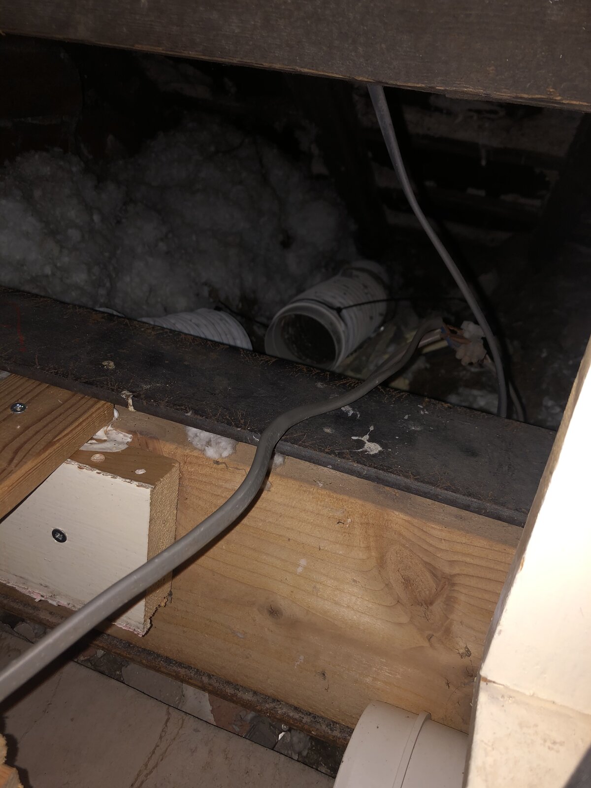

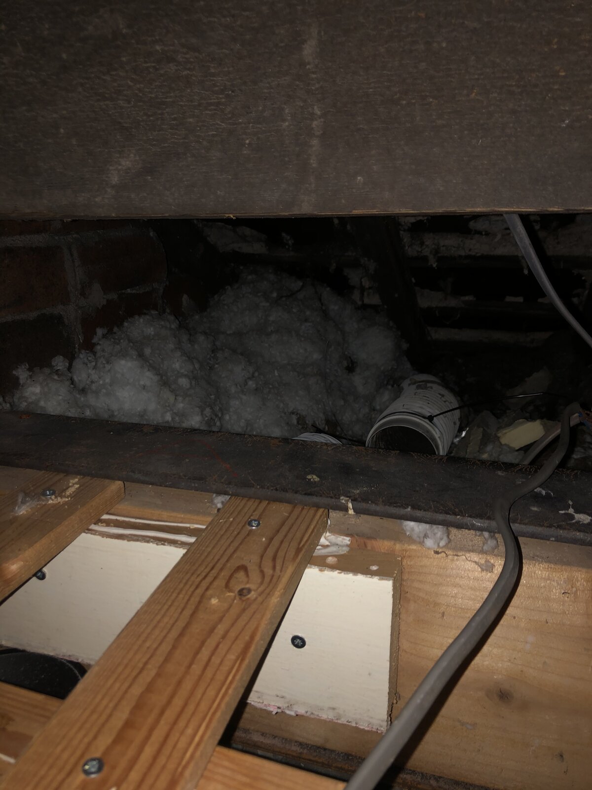

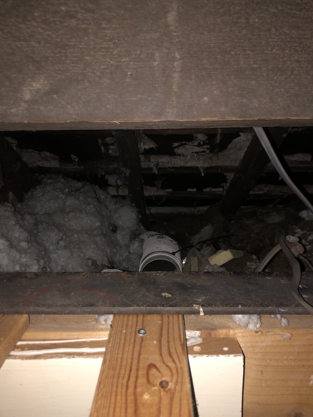

Thanks both. I now have another issue to overcome. The ducting from the ceiling grill in the bathroom to the in-line fan in the loft has a tear. My problem is due to a loft conversion I can see the ducting but I can’t get in far enough to replace and reconnect to the grill from in the loft.
Any ideas?
Can you replace a section with a length of rigid pipe that can be manoeuvred into place?
That might work if I get a piece of rigid duct with a 90 bend on the end, I might be able to manoeuvre it over onto the vent cover. Just might not be air tight.
The gap to fit though is 15cm, so although I can get my hands and arms through I can’t then see, plus that section of ducting to the ceiling is around 2 meters.

Ugg! That is horribly cramped! Any chance of routing the duct to another position or fitting a new wall mounted fan on the outside bathroom wall?
Unfortunately that’s above the shower so ideally I need to be in there. I’m wondering if I remove the bathroom ceiling grill, could I attach new ducting to the old and some bow pull it through?
Would it then be possible to connect the ducting to the grill and refit the grill?
Seems like the only way is to access the outside push something flexible through from outside then pull a new length of pipe through and fit a proper vent on the outside really.
Depends on the height, a normal house is quite doable but if you are in a taller building not all that practical.
