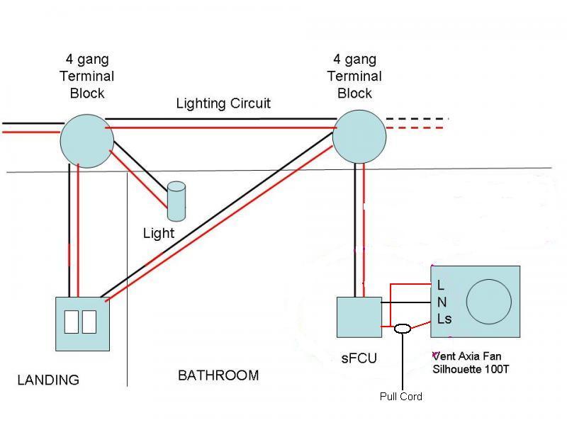

Please I need some guidance thru the different options I have read
I have read many of the forums and understand I am taking a risk but I am confused as to how I should complete wiring a bathroom extractor fan.
Thus far:
have taken a feed from a lighting circuit junction box to a switched FCU - wired like a shaving point. Q - should I be using a FCU anyway?)
the intention was then to take the wiring from FCU to the extractor fan - a with L, N, and SL terminals
I dont know how to feed these with the wires on hand. I have black neutral to the FCU, red live to FCU and earth to FCU.
What do I need to do?

Sorry, to clarify - I have a switch outside bathroom for the fan the FCU was an extra precaution whether right or wrong. The fan would be isolated by the switched FCU but I am struggling to understand how the wiring goes from FCU to the fan. Do I need another live from the junction box to the FCU and hence fan.

I am still stupid I think. Hence I have drawn my idiots diagram of the problem/challenge I have. I am unsure how to affect the wiring of thre FCU to the fan and hope this makes for an easier conversation.
Sorry - am a competant DIYer but am confused over the many options.
Appreciate any comments/suggestions on attachment.
Thanks to all View media item 17563
The answer is what TTC posted above.
Get rid of the FCU - it isn't needed and is just making this far more complex than it needs to be.
You need a 3 core and earth cable from the junction box, to a 3 pole fan isolator, and then to the fan.
Or even do away with the isolator and wire directly from the junction box to the fan.
If the manufacturers instructions refer to an FCU, burn the instructions.
From your picture are you trying to turn your fan on though the landing light? That seems some what stupid
This would work
But the FCU would not isolate the complete fan.
A better approach would be to use
http://www.tlc-direct.co.uk/Products/CA1dot5Gslash3slash50.html
From a separate switch as below
this allows the FCU to isolate the full fan

Thanks for everyones pointers and advice. Eventually the penny dropped and I acquire some 3 core and earth and routed this from the JBox to the timed fan via a 3 pole fan isolator switch. Again this is controlled by a separate switch next to the bathroom lights switch, thus allowing fan to be independent from lights.
