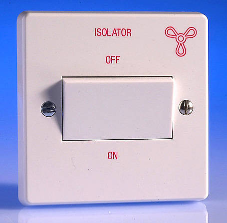

I am still amazed no-one has picked up on the duct extractor fan manufacturer requiring 3 amp fuse protection and how to accomplish this when using the bathroom light switch for the timed over-run fan .... you cannot protect the sw Live AND permanent live after the switch ... no 3 pole fcu available. If you do so before the switch then you also protect the light also, not recommended. (tho' could claim it is just a big warning light for fan !)
So to hell with it .... easy way out for me, separate pullswitch for fan supplied by 2pole fcu (can then sw off to change fuse if necessary). ... 3pole Isolater in loft near fan .... Job done ... Satisfactory ????
Perhaps inelegant ... safe tho' ????
P.
Would it be unduly cynical of me to wonder if the m'fac has made this requirement deliberately, knowing that it'll be hard to do, knowing therefore that people won't do it, thus giving them a handy get-out from warranty claims?
Why not? A 100W light draws 435mA - how much does your fan draw?
P.

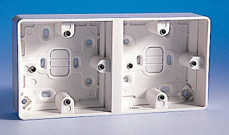

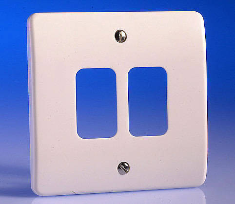

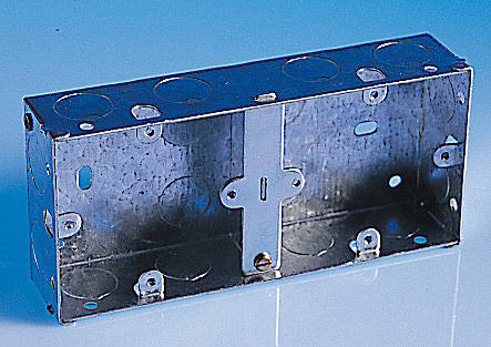

Yup - safe. Problem is that people might forget to turn the fan on, which is why they are conventionally wired into the light. If you want it on the light and you want the 3A fusing and you do not want to fuse the light as well, then there is nothing wrong with taking the permanent live and switched live through 2 unswitched FCUs. Or if you used a dual (not 2-gang) box like one of these:
then you could neatly mount a 2-module grid plate with 2 fuse modules and the isolation switch next to each other.
Other makes of accessories and other suppliers are available.
Rather nice solution there Ban, Never seen it done but it is certainly workable, my only thought on this would be whether this would fall outside of what the NICEIC or IEE find acceptable.
Perhaps Il78, as an NIC Tester will be able to shed light on this for us.
I do like it in theory, and can certainly see no problem with it.
