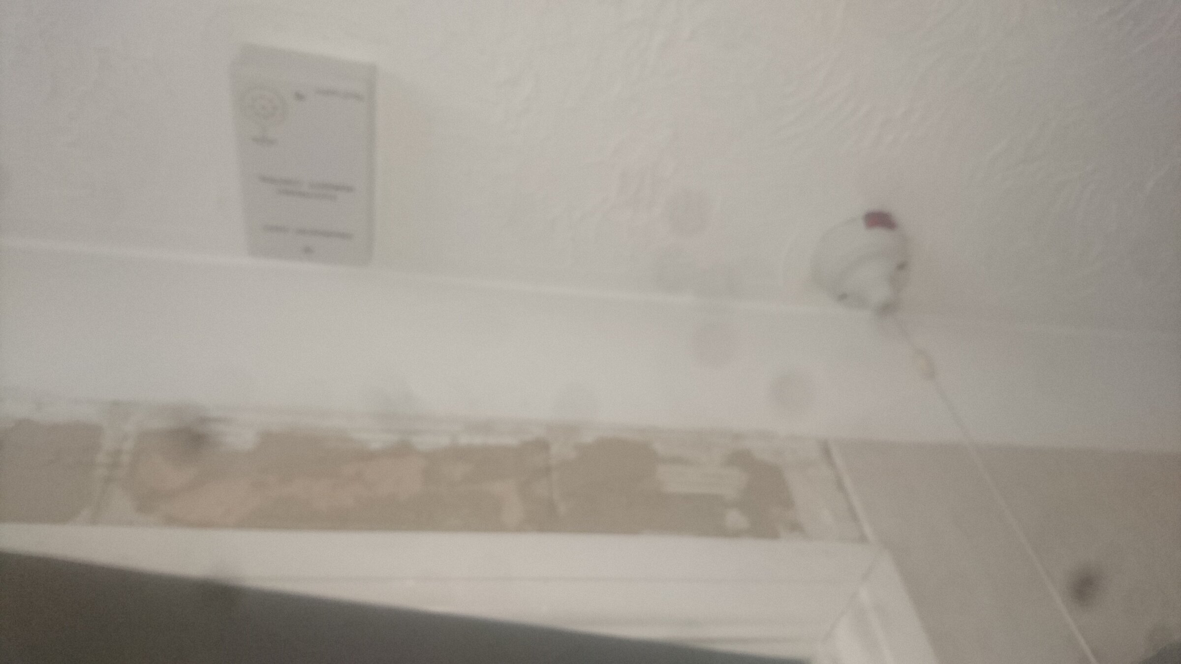

Anyone ever seen something like this before
two bathrooms each have one of these humidity sensors on the ceiling and a manual override switch. All connected up to a single extractor unit in the loft.
Currently doing one of the bathrooms so looking to replace this set up in the said room.
Anyone know if its possible to disconnect/remove the sensor device and only have the manual on off switch for the fan?
Yes you can, the fan is driven by a motor and you can wire up the motor to be switched on and off by whatever device or devices you choose. There is nothing to stop you wiring the fan motor so that it is only controlled by a switch.
But in my mind it would be a backward step. At the moment the sensors will automatically control the fan so that it operates until the humidity sensor detects that no further ventilation is required, so you can shower, leave home and the sensors will automatically run the fan and switch it off in your absence. The extraction will be automatically controlled to the correct level. With a manual switch it's all down to you to turn it on and off. As I see it, it would be like removing the room thermostat from a central heating system and manually turning the heating on and off as you felt warm or cool. But why would you, the thermostat maintains the correct temperature for you automatically even when you weren't physically present.

Just wanted to get rid of the 80s looking components really.
If im able to find something newer that offers the same function and is compatible with the existing motor then ill look into replacing it with that.

cheers, I managed to disconnect the it this morning so its only on the manual switch at the moment.
Will look into the idea of the pir as a means of auto switching as i go about re refurbing the room
