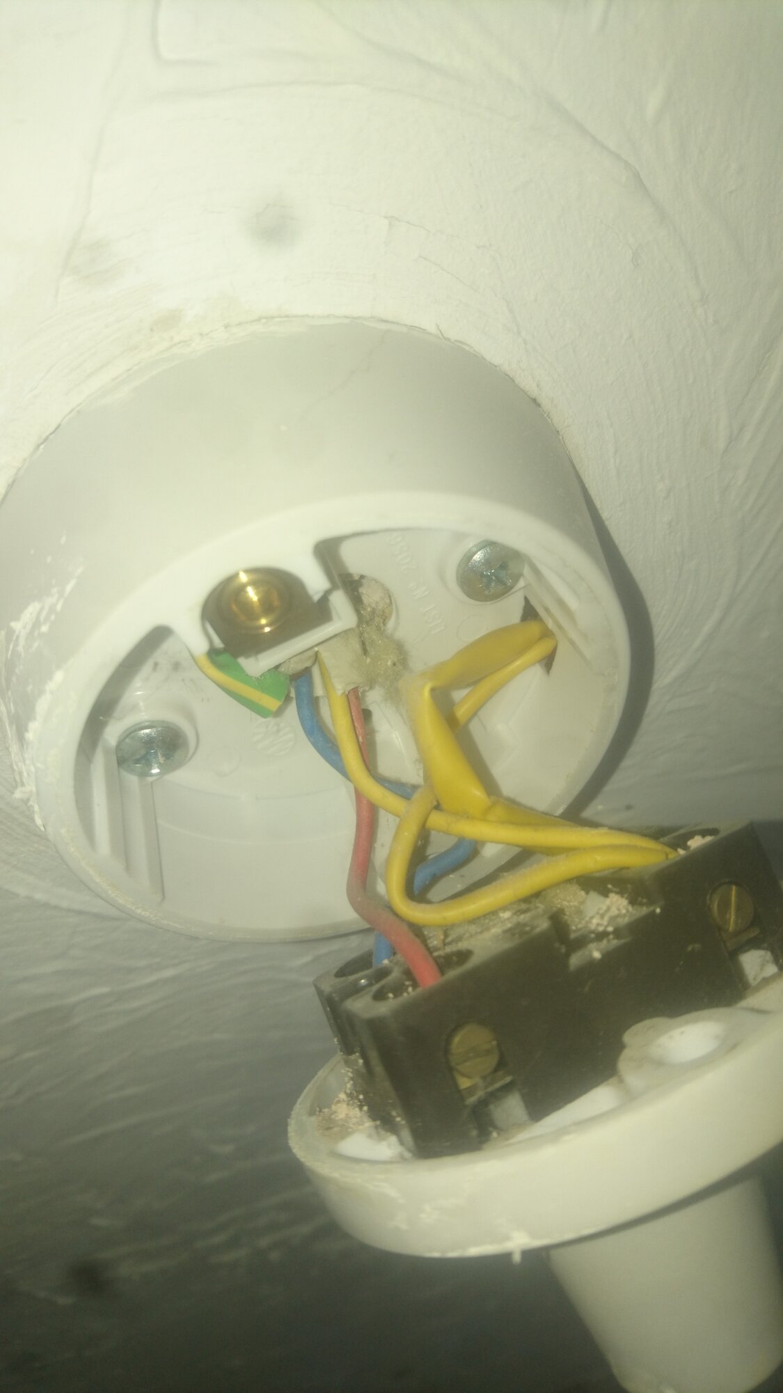

What type of pull switch is this?
10 Dec 2009
722
16
Middlesex
Could someone advise on what type of ceiling pull switch this is
Has a single cable going into it from the loft
Is it a tripple pole isolation switch?
If not what is the correct name for this type?
It's A DP [Double Pole] switch and will have terminals for L&N in and a L&N out [or Load] Both poles will be switched when the cord is pulled. It should say on the back that it is DP and show a current rating [A]
As it appears just to have three wires L&N in and a L out. It appears to be being used as a single pole switch to just switch the L. The N only being used to provide power to the Neon indicator.
The yellow leads to the Neon are the 'out' or 'load side' terminals.
Possibly feeds a loft light , neon to indicate if light is on or off when the hatch is closed .

So would i be able to replace it with a single pole without the neon?

Ive been up in the loft and it feeds into a JB
That goes to the loft mounted extractor unit.
Loft light is on a separate switch in th corridor with its own neon
Yes, but you would have to isolate / insulate the Neutral wire and tuck it out of the way.
If i wanted to connect this up to a 2 gang wall switch. (1 rocker switch for a light, and one in place of the pull cord for the fan) is that possible?
If so what type of switch do i need to get as the replacment?
Use one gang for the light and the other for the fan.
You don't mention the current rating of the fan, but it won't be a problem if it's a standard domestic bathroom fan.
