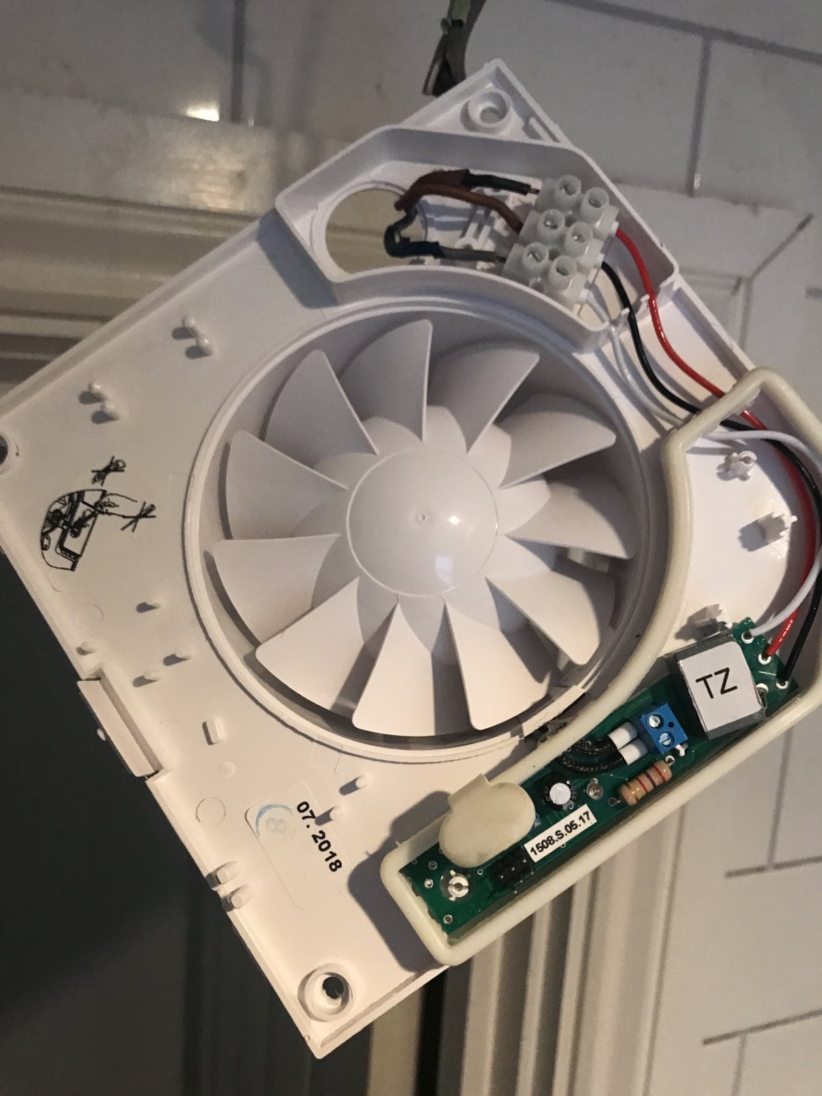

Hi guys
I've wired up my bathroom Fan and initially it was working beautifully, shortly after I switched off the mains to screw it all back together and now it won't turn on!
I get a short pulse of the red light and then nothing.
Can someone please tell me what I've done wrong??
Thank you

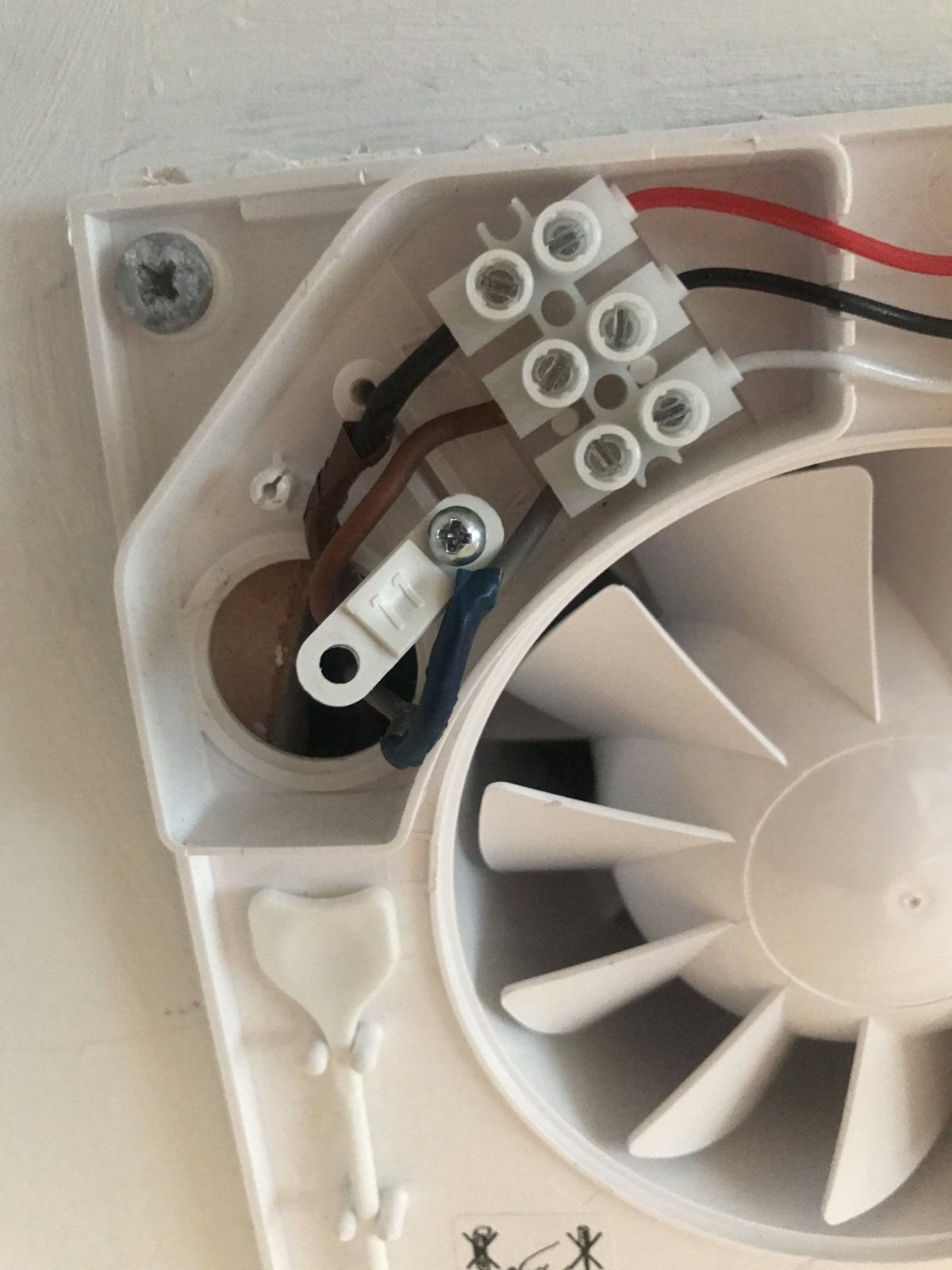

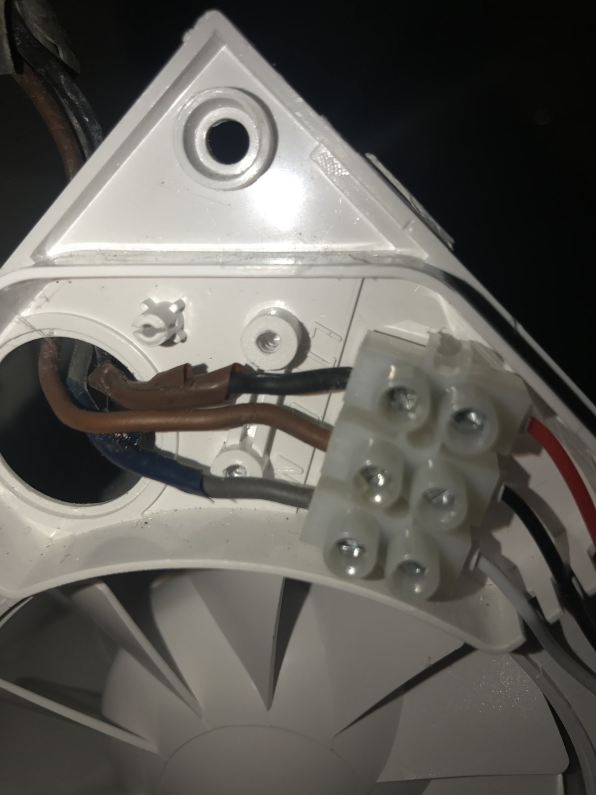

I don't know if you've reconnected the cable between the photos, but in the 'full' picture, I can see some bare copper on the SL and N. This may indicate a loose or unmade connection.
Yes. All has been reconnected but still the same. It seems it's something to do with those 6 pins at the bottom of the 'full pic' because when I touch them with a screwdriver I seem to get some movement of the blades and some life back into the Fan
Problem is either with the fan of the cabling to it, so...
Does the fan work if you you connect both the LT and L terminals to the permanent live feed?
Can you verify 240V between L/LT and N? (You'll need a multimeter)
