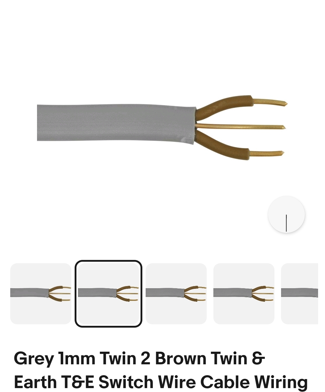

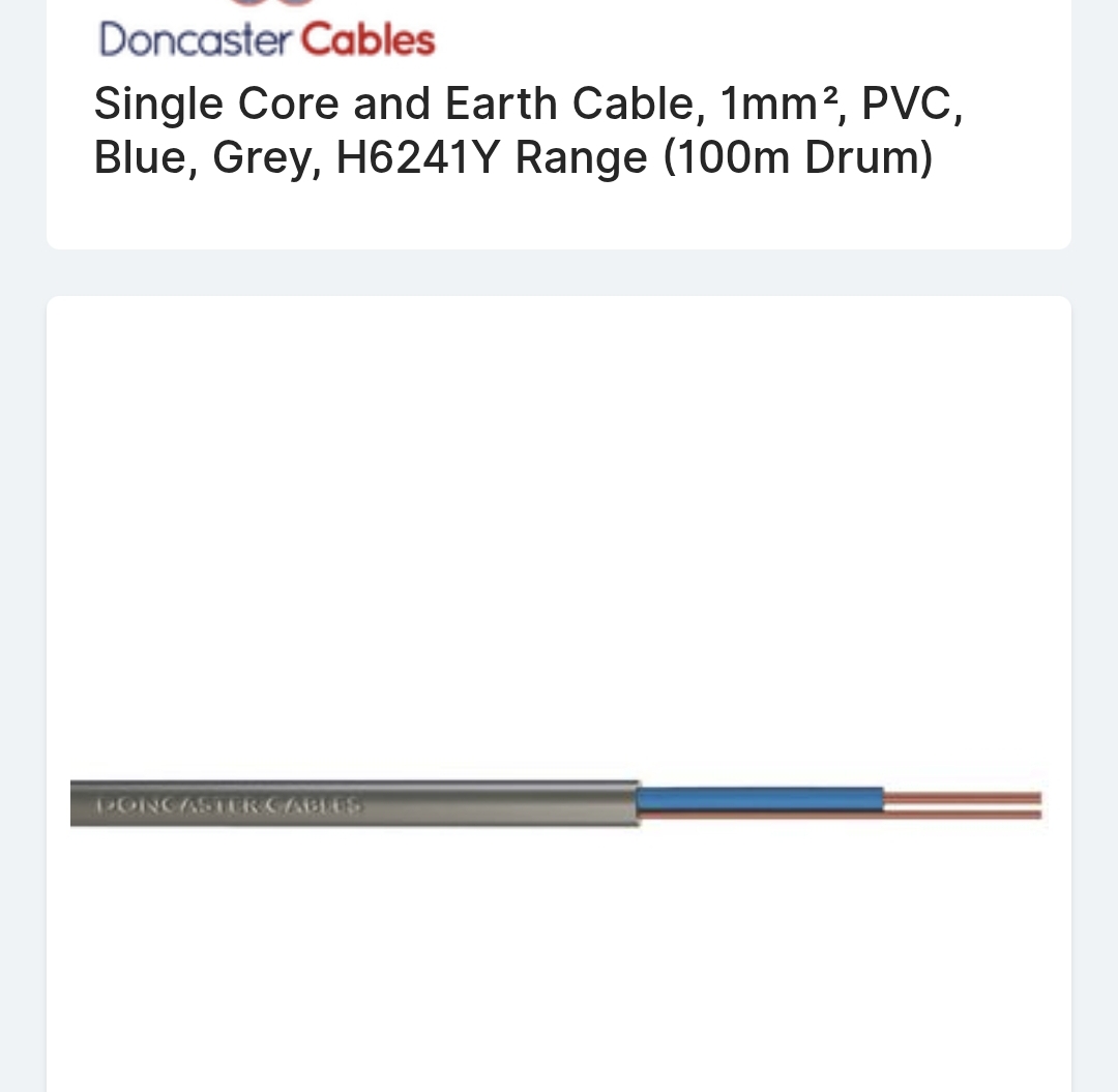

But it still needs power to it and while running 2 singles for N & L they might as well run the SL too and not have to mess about with what I'd consider to be a silly arrangement verging on a botch
True - I'd forgotten that the OP doesn't have any fan, I thought he had a basic one, and wanted something better.
